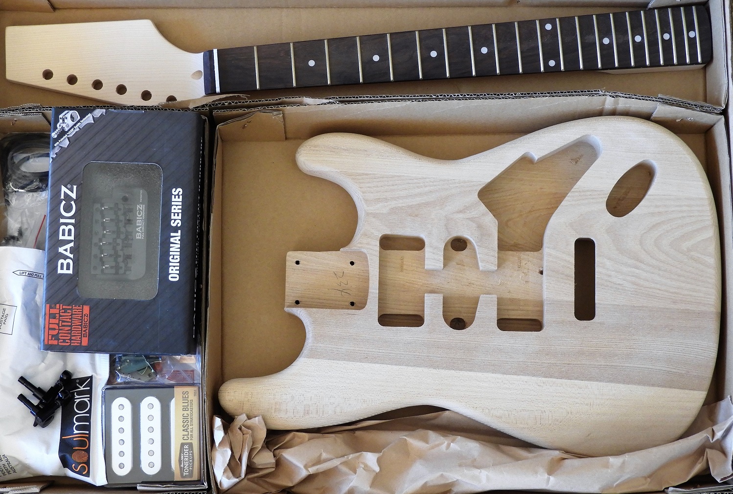

    The GAS kicked in and the postman delivered a very nice looking STA-1 with blemish free Ash body and Rosewood fretboard.
    I decided to spend a bit of money on this one to find out a bit more about the technology and upgrades you blokes talk about.
    I have plan in mind. The inspiration came from me playing Hank Marvin / The Shadows stuff as I can't sing so the guitar has to do it. You can guess RED but not Hank red. I am going dark wine red (stain with TruOil) again with black fittings all round. If anyone in WA sees Hank please tell him he is welcome to try it out - 'hihi'. It will have a whammy bar.
    The upgrades are as follows:
    Black upgrade, Electrics upgrade - PB stuff, Tonerider TRS3 Classic Blues,
    Grover Rotomatics upgrade, Babicz FCH Strat Tremolo

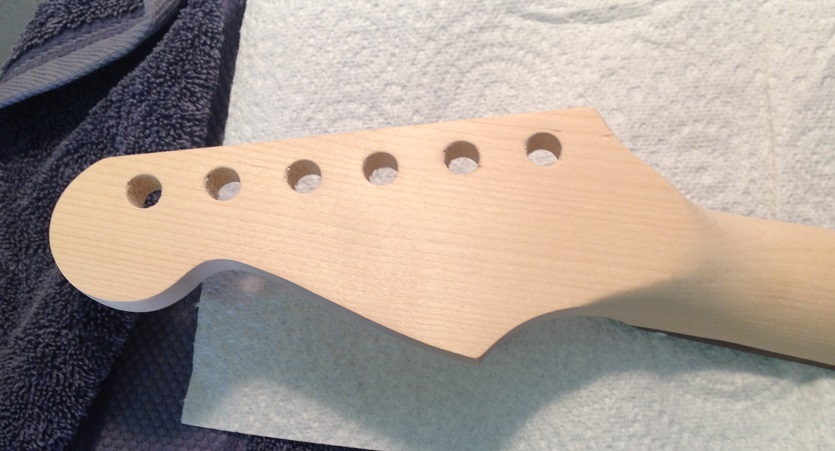

    2. Cut the shape in the head. Tried to come up with a custom shape but failed. So I went for the standard Stat shape.

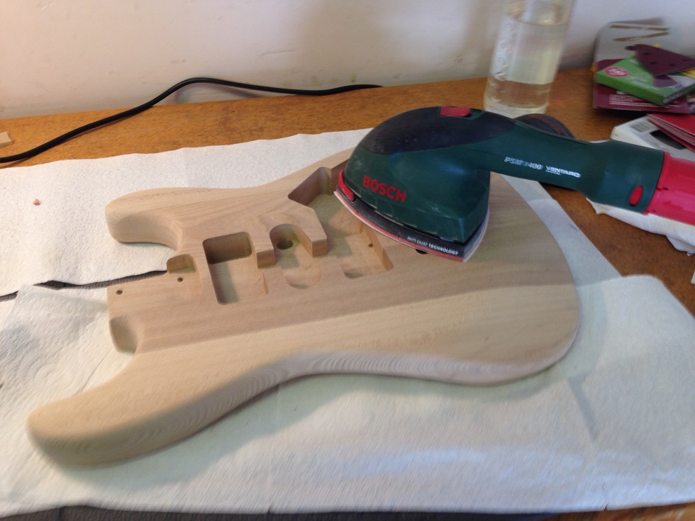

    3. Sanding 120,180,240 grits. Sure makes it easy not having to worry about a veneer like the LP1-MQ.

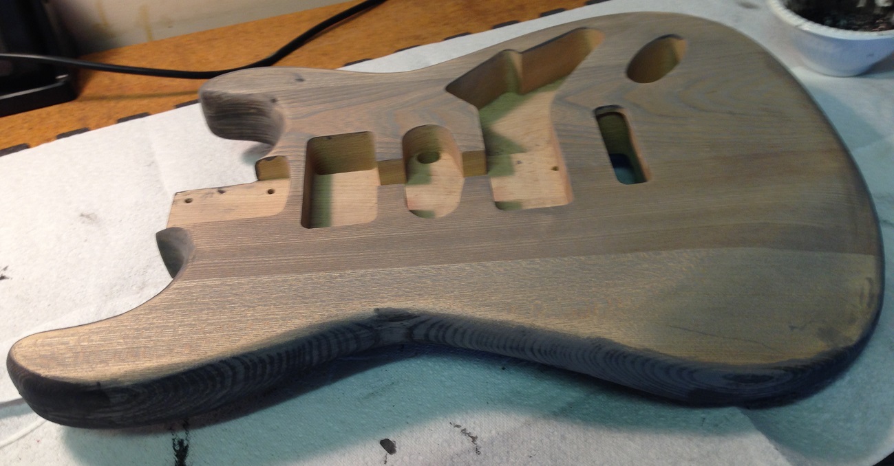

    4. Grain filled with Timbermate. After the first coat was sanded off there was still a lot of TimberMate in the grain. I applied a second coat to ensure a good fill. I think I will need to take it off with 180 grit to get a lot more timber colout and then finish it off again with 240 grit. Let me know if this is not a standard practise.
    The photo is taken after the first sand off. Second coat is currently drying.

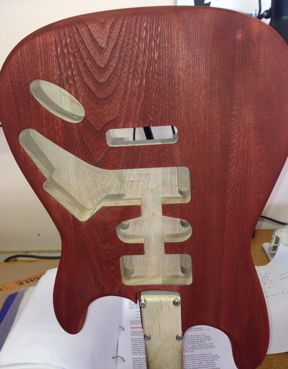

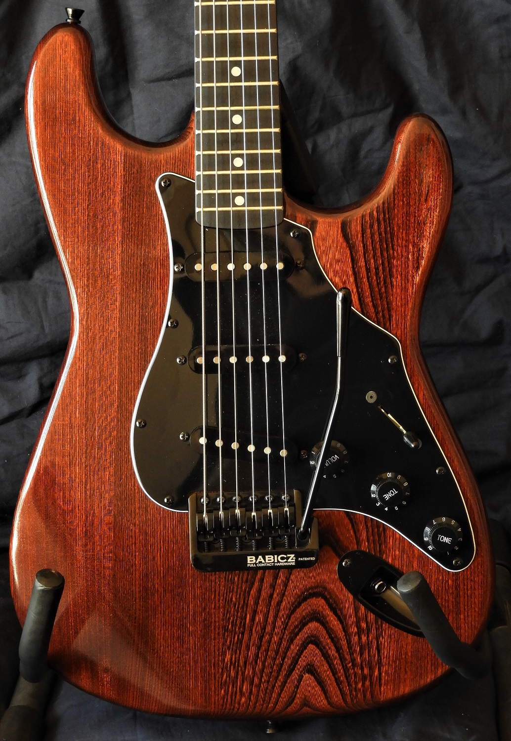

    I have sanded, filled the grain with black Timbermate and sanded again and again >>>>>
    Next job was to find a colour. I wanted a dark red to go with black fittings. After many trials with Colour Tone Red Mahogany, Cherry Red , Black and Blue(makes purple - not quite what I had in mind.), I decided to go with raw Red Mahogany. There are a couple of nice examples on the web. So I am hoping for the best.
    I have now given the body three coast of 1:15 stain to metho. And so far I am happy. First coat of Tru-Oil tomorrow.
    Of course after the first coat that elusive glue spot appeared. I had been looking for glue spots for days while sanding and then two rubs with metho to raise the grain. Anyway I was able to quickly remove most of the glue with Goo Off and then used a piece of sharpened fine wir and magnifying glass to scratch out the little bit of grain that remained. Turned out successfully with just two small bits of grain scratched out that will fill with the 30 coasts of Tru-Oil.
    The spot in the right-hand corner of the photo is after the first coat and after the Goo Off and has now disappeared.
    My photos after the last coat of stain are pretty crappy so I will have to try again after a few coats of Tru-Oil
