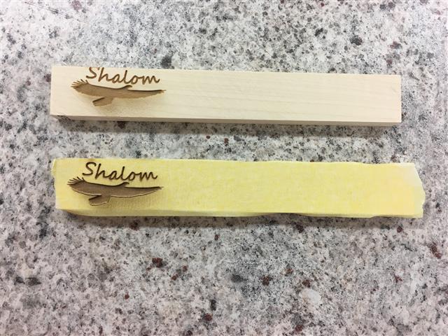

    P.s laser cuts through the tape, just need to increase the intensity a tad. Will post results here for your perusal.

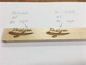

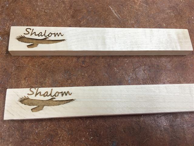

    Experiment Over - with some telling results!
    I went to Bone Timber in Adelaide and they don't stock any maple. I got some meranti and they said it's a similar type of "hard wood".
    My colleague on the other hand, actually had some maple offcuts so I used them instead!

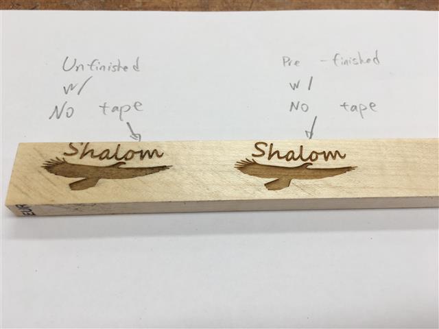

    The first picture is laser cutting on unfinished maple - one with tape, one without. It's clear to see that the one without got a bit of the ash smudge on it.

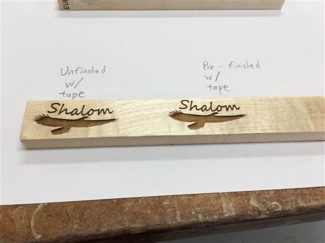

    Putting on the oil - there is a bit more gloss but during the rubbing some further smudging happened - because I didn't sand before laser cutting, the smudge fills up the cracks very soon. Leaves a dirty look. The one with the tape looks alright

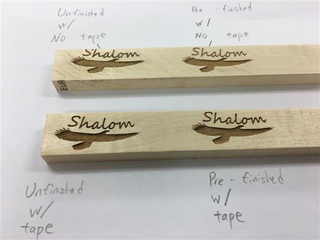

    Next, pre-finished and pre-finished with tape
Name:	IMG_2534 (Small).JPG

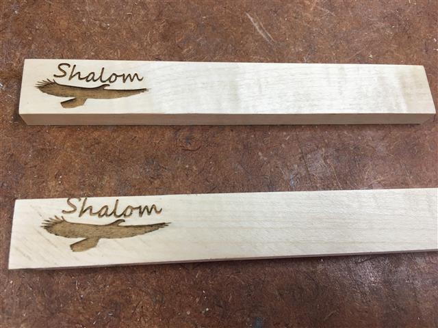

    I've only done one layer of oil due to time constraints, but it appears that cutting on unfinished or pre-finished doesn't make a lot of difference (pre-finish at 12 hours to dry), but the key is TAPE. without tape the smudge makes it very dirty looking.
    This is what it looks like after the 2nd coat
Name:	IMG_2551 (Small).JPG
