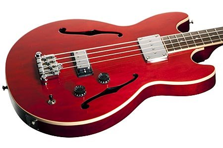

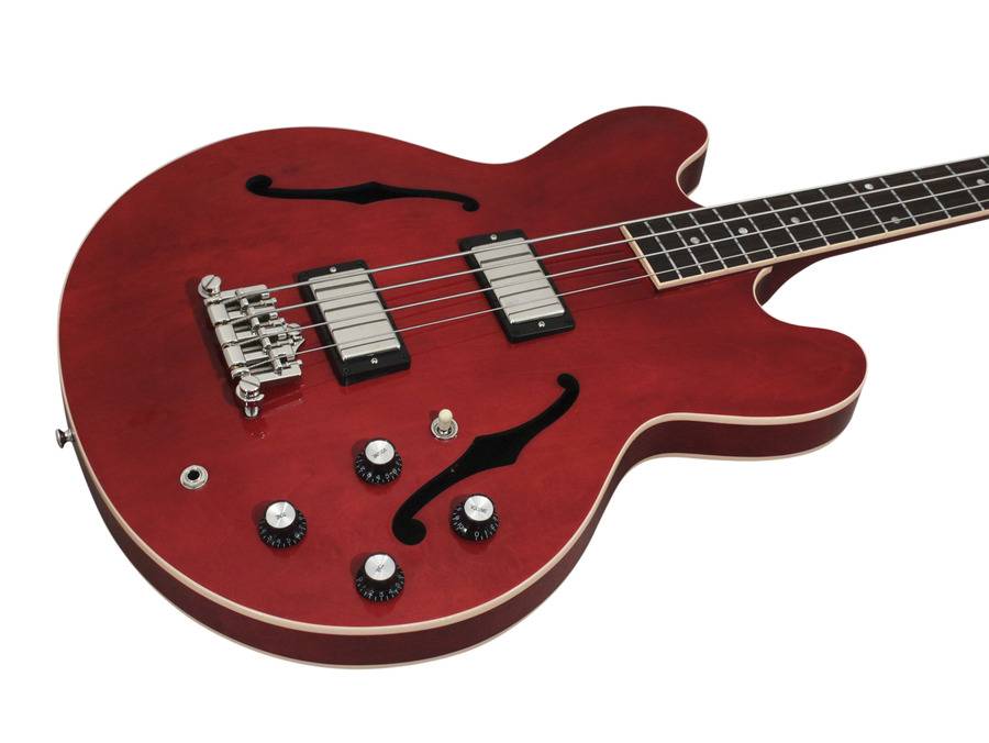

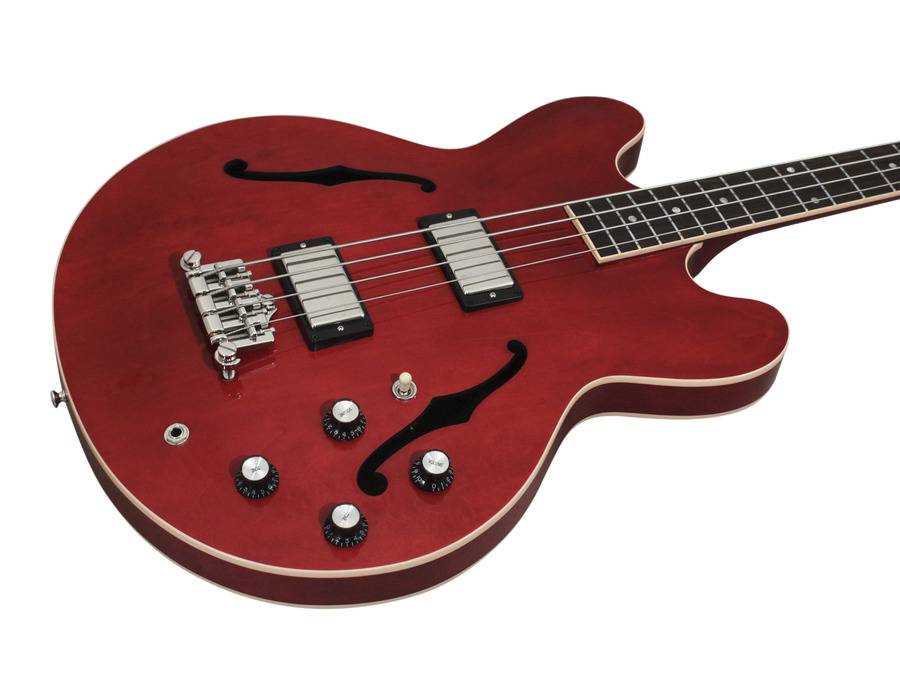

    I think Gibson is hedging its bets. The new ES-335 has the neck pup closer to the mid position. Both seem to be guitar sized humbuckers. The new Midtown (update of the EB-2) has a mudbucker bumping up against the neck and a mini down by the bridge. On YT the latter has a more traditional Gibson thunk. The ES-335 had a large range of sounds. Nothing like an EB-X, but nice....Click image for larger version.
ID:	27076Click image for larger version.
    This is pretty standard for how those pickup types were used traditionally. The bid EB-0 pickup was always up near the neck. Basses with the other humbuckers had them more in middle and bridge positions.
