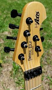

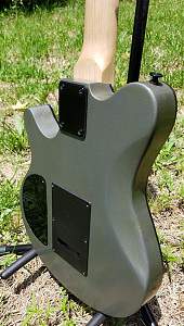

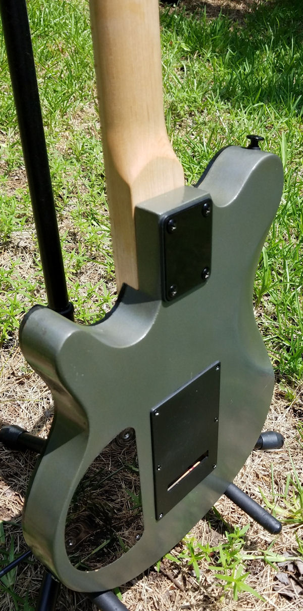

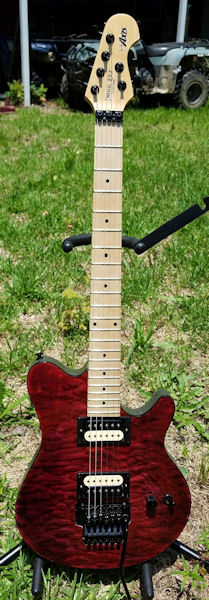

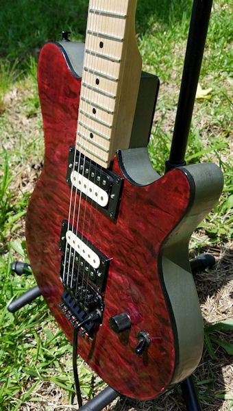

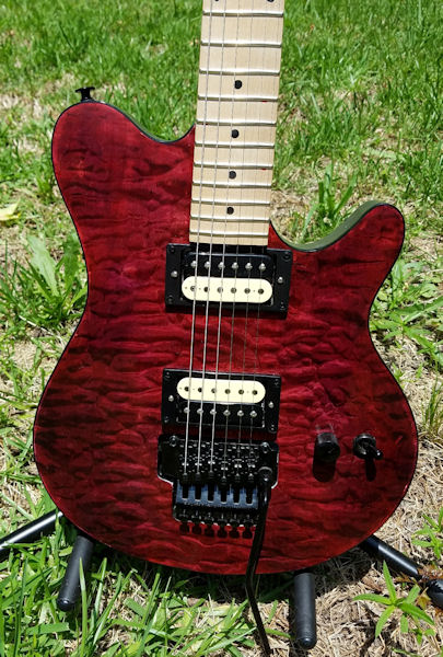

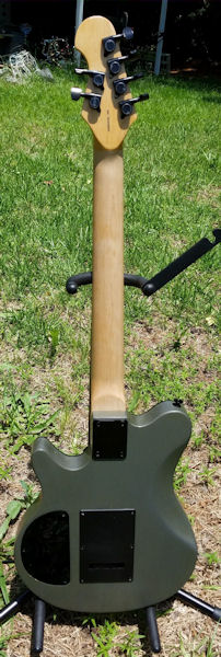

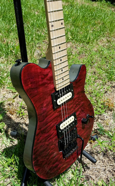

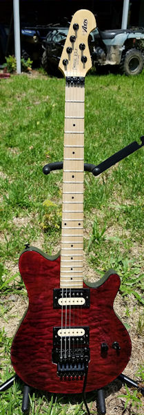

    OK, I'll go first with my MM-1Q, lovingly called the Haxis, that I just completed over the weekend. I once wondered if I'd ever finish either of these guitars, now I've gotten them both done within a month of each other. This was supposed to be my first build, and I chose it because I'm a full-fledged member of the cult of Music Man, and I thought an Axis-style guitar was the perfect build for me. I actually just added the JK-1 from last month's contest on impulse.

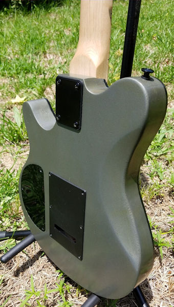

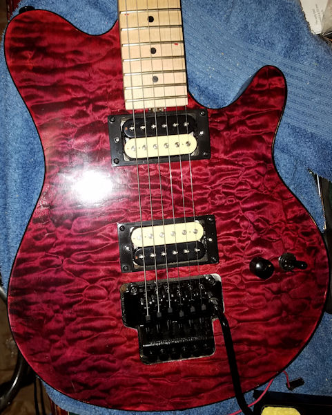

    The plan for this one was royal purple stain with a back that looked like natural mahogany because I like that look on some of the higher-end guitars that I've seen. I ran into some challenges with that, though. After much mixing and experimenting with stains, I never got quite the color I wanted for either. I got a purple that I liked for the front, and it is purple, even though it looks more like a dark red in the sunlight. I've included a bench shot of it that shows the purple tint, but it's really hard to get it to look in pics like it looks in person. As it turns out, it seems pretty much impossible to stain basswood to the color of mahogany, so I had to go with a painted back. When I ordered, the only MM1 kit available had black binding, so I didn't want to paint it black. I played around with a lot of colors until I found this hammered pewter that looked interesting on my test pieces. It was supposed to be a textured paint, and was on the pine that I played on, but the texture didn't pop on the basswood. Still, I'm not unhappy with the way it turned out. It's finished with Tru-Oil -- a whole bunch of coats and lots of sanding and buffing.
    This kit definitely had more issues than the JK-1. As you can see, there are some glue spot issues that I decided to live with because I was afraid to do much sanding on the quilt veneer as I didn't want to cut through it. I worked them as best I could with a wire brush and did a little sanding, but I just couldn't get the stain to take on them. Also, the neck holes were too far to the side and not straight. I had to plug those and re-drill.
    The neck is sanded to 2000 grit and finished with a Birchwood-Casey oil and wax blend, just like a real deal MM. I've gotten pretty good with that finish on the three projects I'm working on and plan to give it to a few other guitars I have laying around. The red spots that you see on the fretboard are stray pen marks from my fret-leveling. Unfortunately, it's permanent marker. I tried to sand it out, but didn't want to cut too deeply. Hopefully, they'll fade with time and play.
    As far as upgrades, this kit is mostly stock. I upgraded the electronics to a CTS pot and Switchcraft switch and jack, and I put some Dragonfire Classic PAFs in it. Very different from the Screamers I put in the JK-1, these are warm, a little looser and better for classic rock/Southern rock-style dirt. I briefly considered putting humbucker-sized P90s in it, but decided that wasn't a good idea with the Floyd. It will probably get a Floyd upgrade in the future, but that's a large chunk of change, and we're still in the bonding phase.
    Apologies also for my junky, old ATV in the background, but I was trying to get the best sun that day and didn't realize my background was not ideal until later.
    Probably not a high bar for the other competitors this month to top, but there it is.
ID:	26868 Click image for larger version.

    Nice one Spycho,you got a nice flame finish ther. Any problems with the Floyd Rose, did you have to add extra springs to pull the bridge down when tuning?
    Wayno.

    Nice work Spychocyco. I love the contrast between the red top and grey back. A very unique colour combo.

    Quote Originally Posted by Wayne.Mumford View Post
    Wayno.
    Thanks. The FR was surprisingly easy. I was worried about that. It took a bit of trial and error adjusting of the springs and the claw, to get everything right, but it wasn't the nightmare that I was worried about. I ended up with all three springs on it and the claw almost all the way in to get the action right. It doesn't have a ton of back action now, but enough for the rare times I use it that way. The stock Floyd is definitely not the best I've used. The fine tuners are pretty rough and it just doesn't seem really sturdy, but it works.
