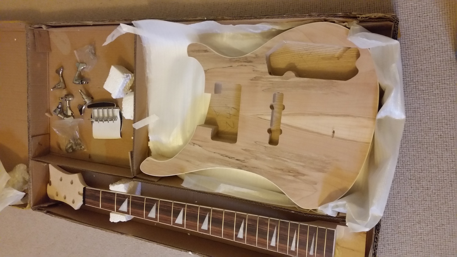

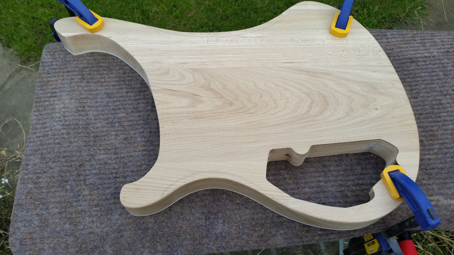

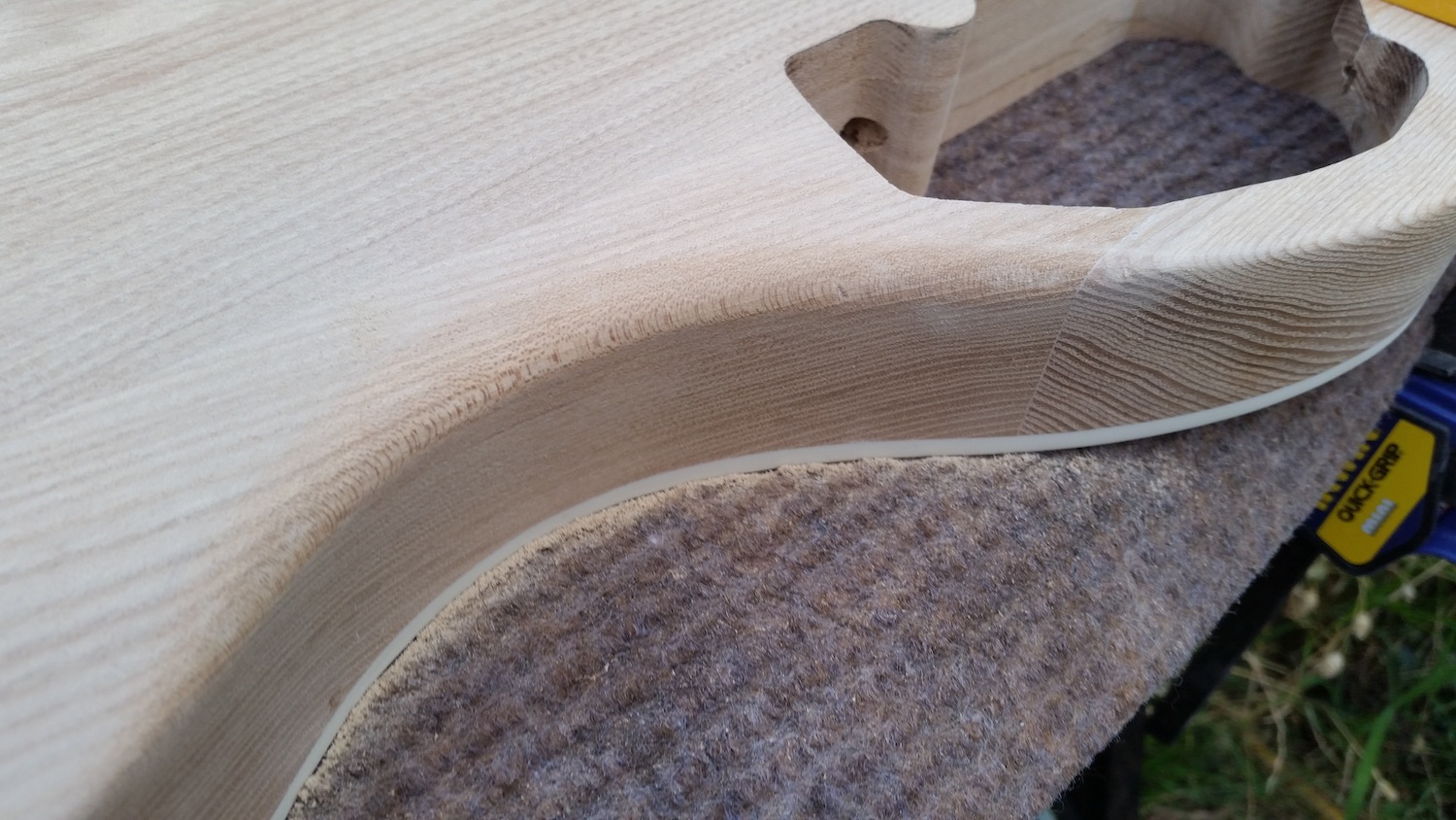

    This is what came out of the box.

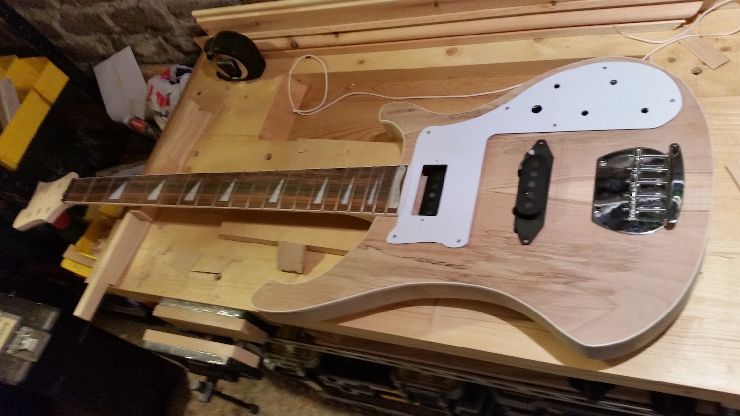

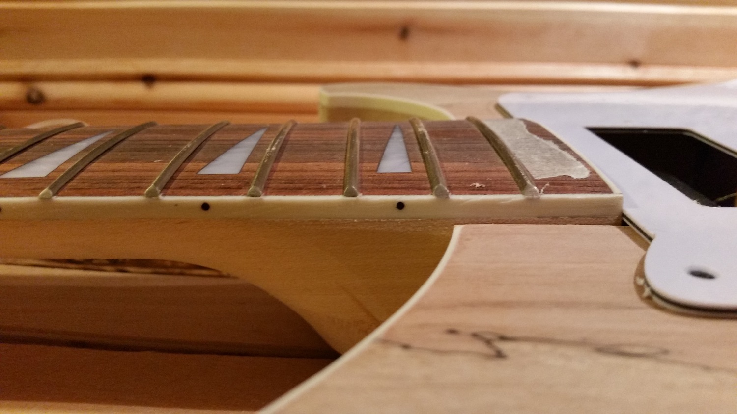

    Here is the trial assembly on the bench...
    It all went together nicely, Adam provided exactly what I'd asked for and the quality was indeed superb.
    The neck pocket was nice and tight, but not too tight!!

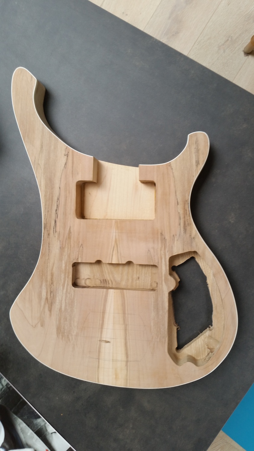

    The fun started when I tried to make the pickup cavity larger for the bridge pickup

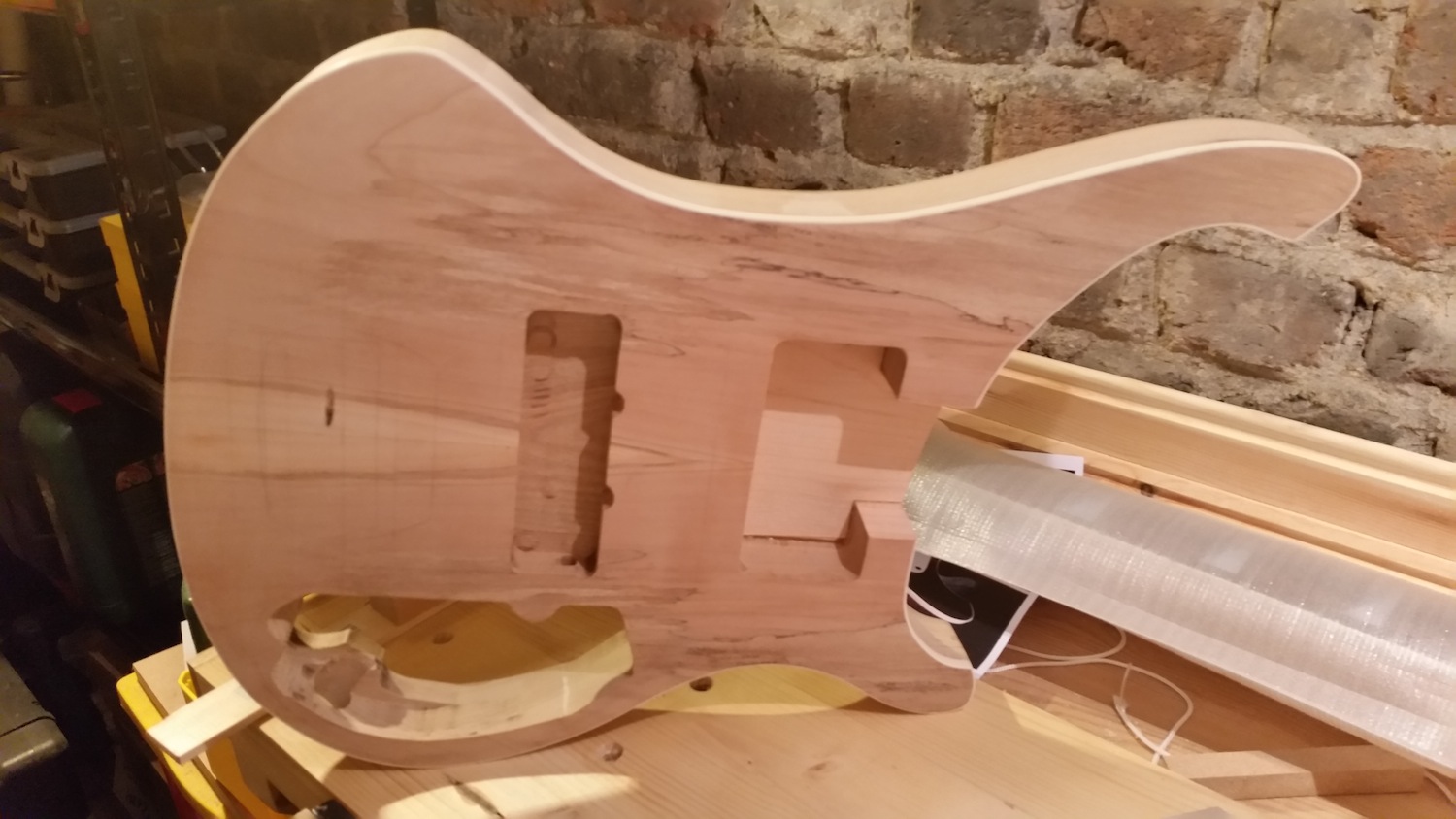

    I'd decided I wasn't going to use the plastic scratch plate, but instead use the spalted maple top I had left laying around. It was while trying to prepare for that I realised I had rubbed down through the existing top. I wouldn't be able to cover it with the spalted maple top! As I actually felt a bit unhappy about cutting the top up, I came up with the cunning plan to use the whole top and make a carved top for the guitar.
    You can see I also cut through the control cavity, the plan being to put a cover on the back for easier access.

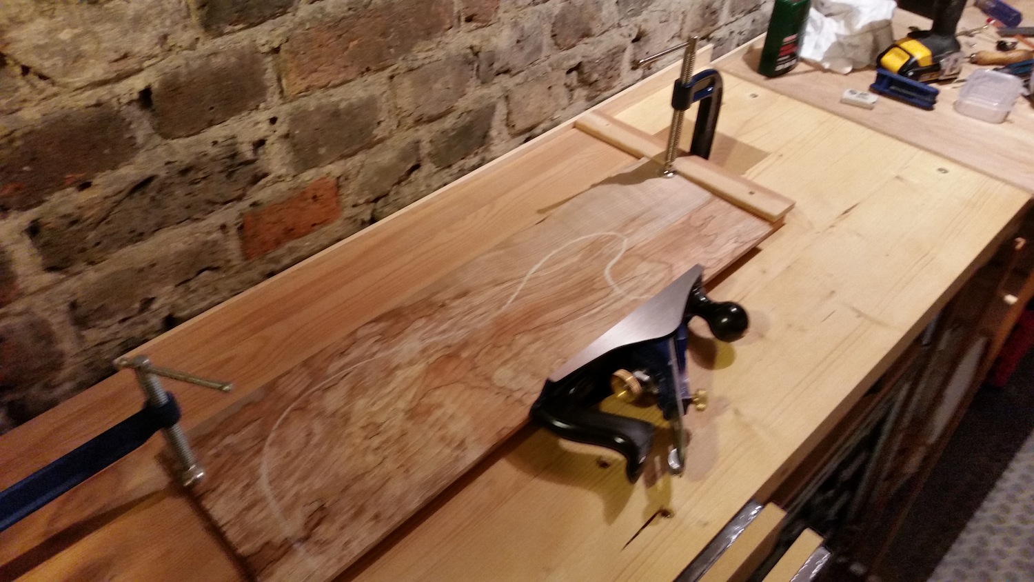

    Here is a view of one half of the book matched spalted maple top... I spent hours on a five minute job to join the two bits of top together!

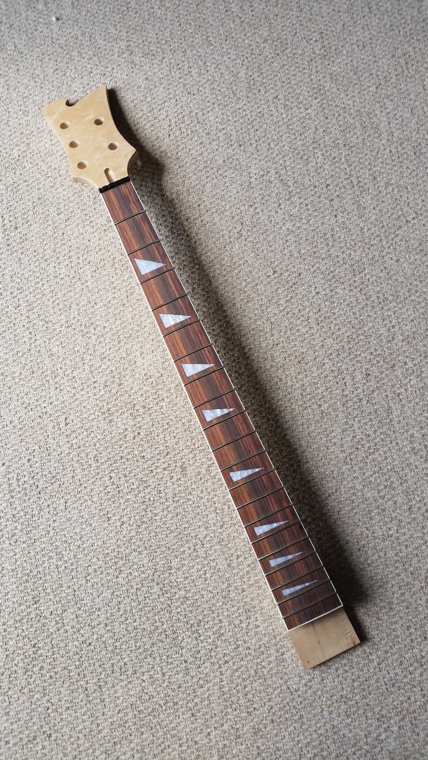

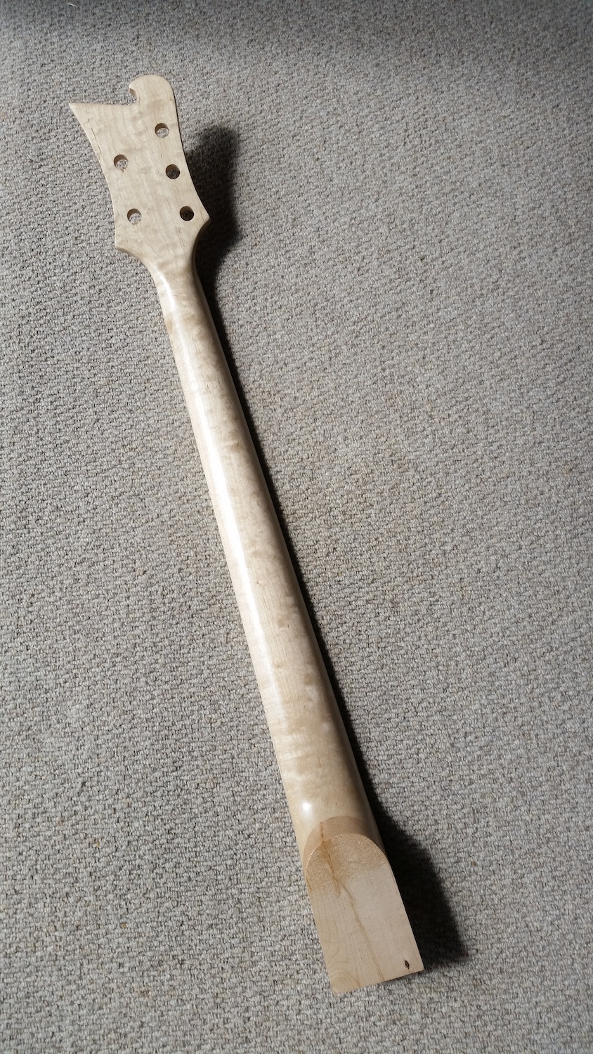

    The Neck
    The neck was a dream to finish, a careful rub down and a few coats of oil and it was good to go....
    The fretwork was excellent. The guitar, when finally assembled, played immediately without buzzing. Lowering the strings and working to get down to a low action turned up only two frets that needed minor adjustment. Nice one Adam!

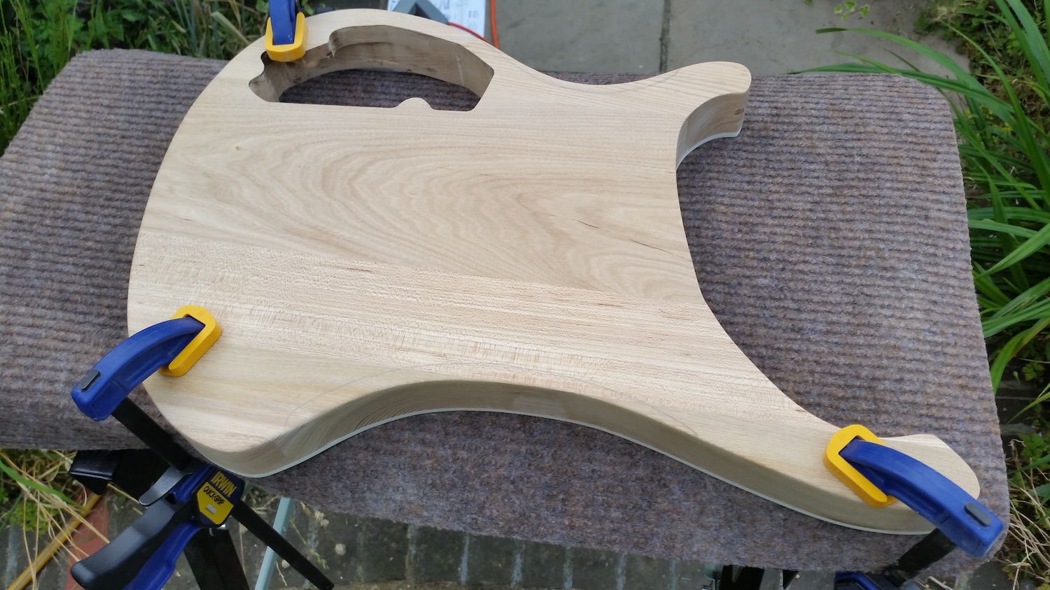

    I did more work on the back of the body... sanding... sanding I gave up sanding sorry!

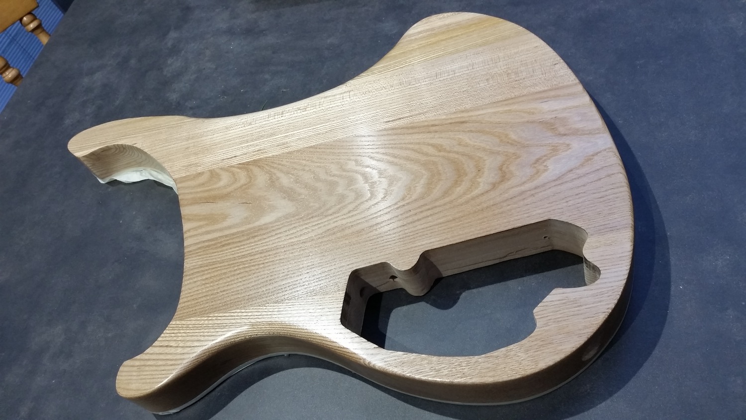

    The finished back... this took something like 4 days of work in total. Sanding, oiling, sanding oiling...
    Although the back is made of 5 different bits of wood, they work nicely together. They were clearly chosen at the right aspect of the moon, they make the bass sound really good!
