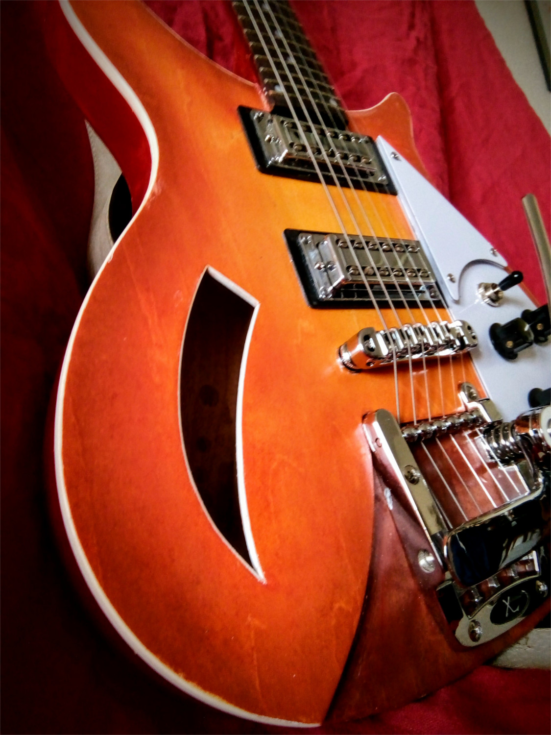

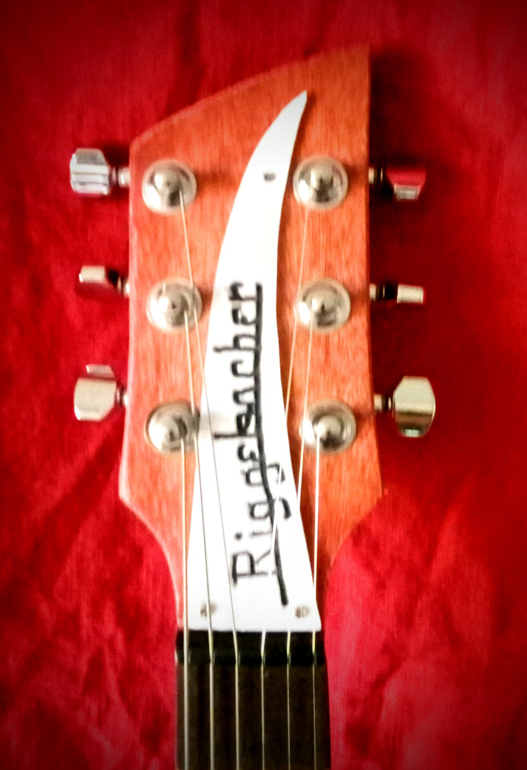

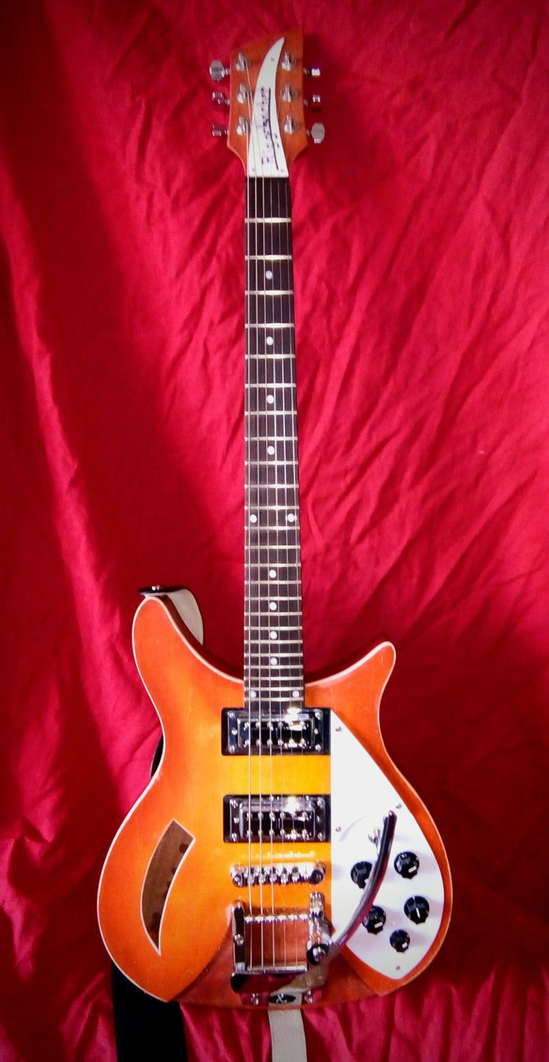

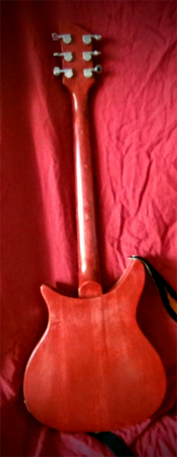

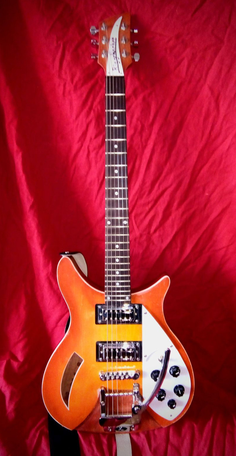

    So here's my Pitbull Guitar kit build. It is obviously a copy of that brand with an R that produced the legendary frying pan. I've wanted one of those (not the frying pan, the more common guitars) for a long time, but the originals are very expencive.
    The kit did indeed contain everything needed apart from paint. However I was not happy with the tailpiece and the fact that that carved part of the body underneath the tailpiece is mahogany and therefore much darker than the top. I therefore went for a B-style tremolo which looks nicer than the included one, conceals most of the darker wood and is a cool Tremolo. I decided to go for the Guitarfetish Vintage X-Trem. I then added a wilkinson rollerbridge (had to fit dowels in the original bridgepost holes and drill new holes because the post distance is slightly different.
    The pickups are also from Guitarfetish (minitron Liverpool), as well as the pots. The knobs and toggle switchare from Stewmac.
    For the finish I used waterbased pigments, diluted with some water and applied them with a sponge. So the sunburst is basically a watercolours painting. I then appplied a waterbased Polyuretane finish, again with a sponge, in multiple layers. Turned out OK but definitely not as nice as if I could have sprayed it.
    About the controls: I wanted the original 5 knob wiring with the blend knob. Once I was done with that and started trying the knobs I didn't like the way the blend knob works and changed the wiring so the 5th knob would funtion as a master volume. That is much better.
    Finally the headstock: I changed the shape to a non symmetrical shape that is pretty close to the original. From an old piece of pickguard I made the big, white truss rod cover and engraved it. If you look properly you will notice that the writing is not only shaky and irregular, it is also not spelt like the real thing. Since the name giving founder of the company that makes the original was born in my home town in Switzerland I decided to spell his name like we pronounce it here. So no copyright infringement here. And now the pics.

    Stain looks great! Wow looks fantastic. You must be pleased.

    Well done, I really like both of these guitars!
    The headstock and f hole decal I really love on the bass. Would love to hear how it sounds.
    The trem on the R guitar looks good, nice sunburst too.

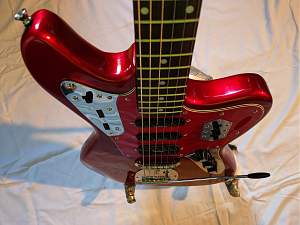

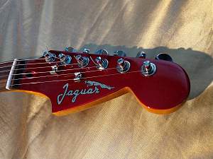

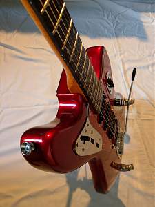

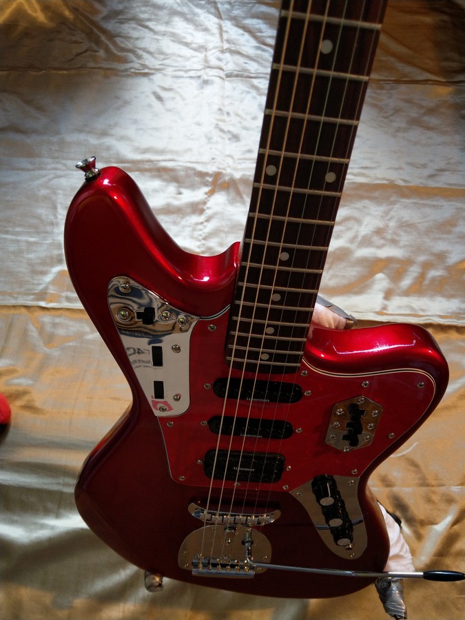

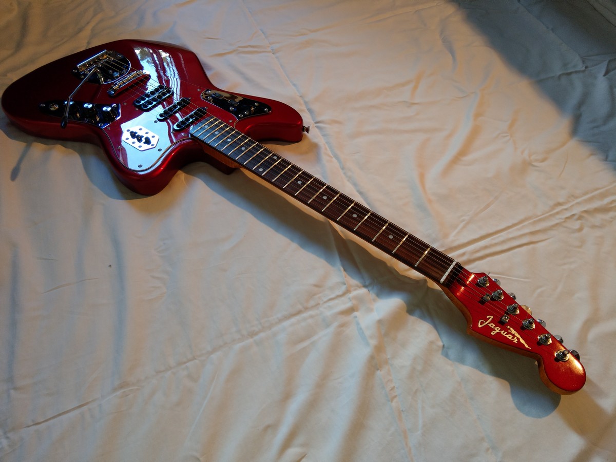

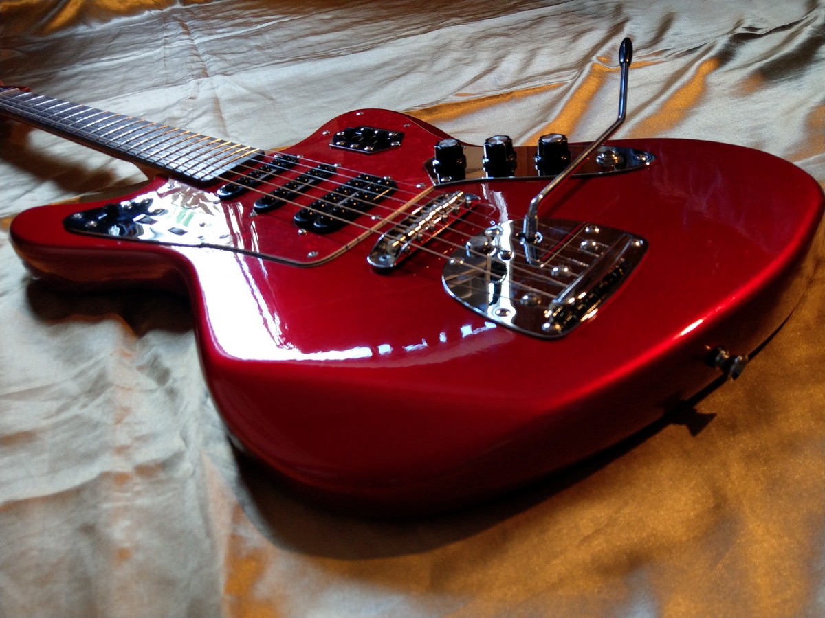

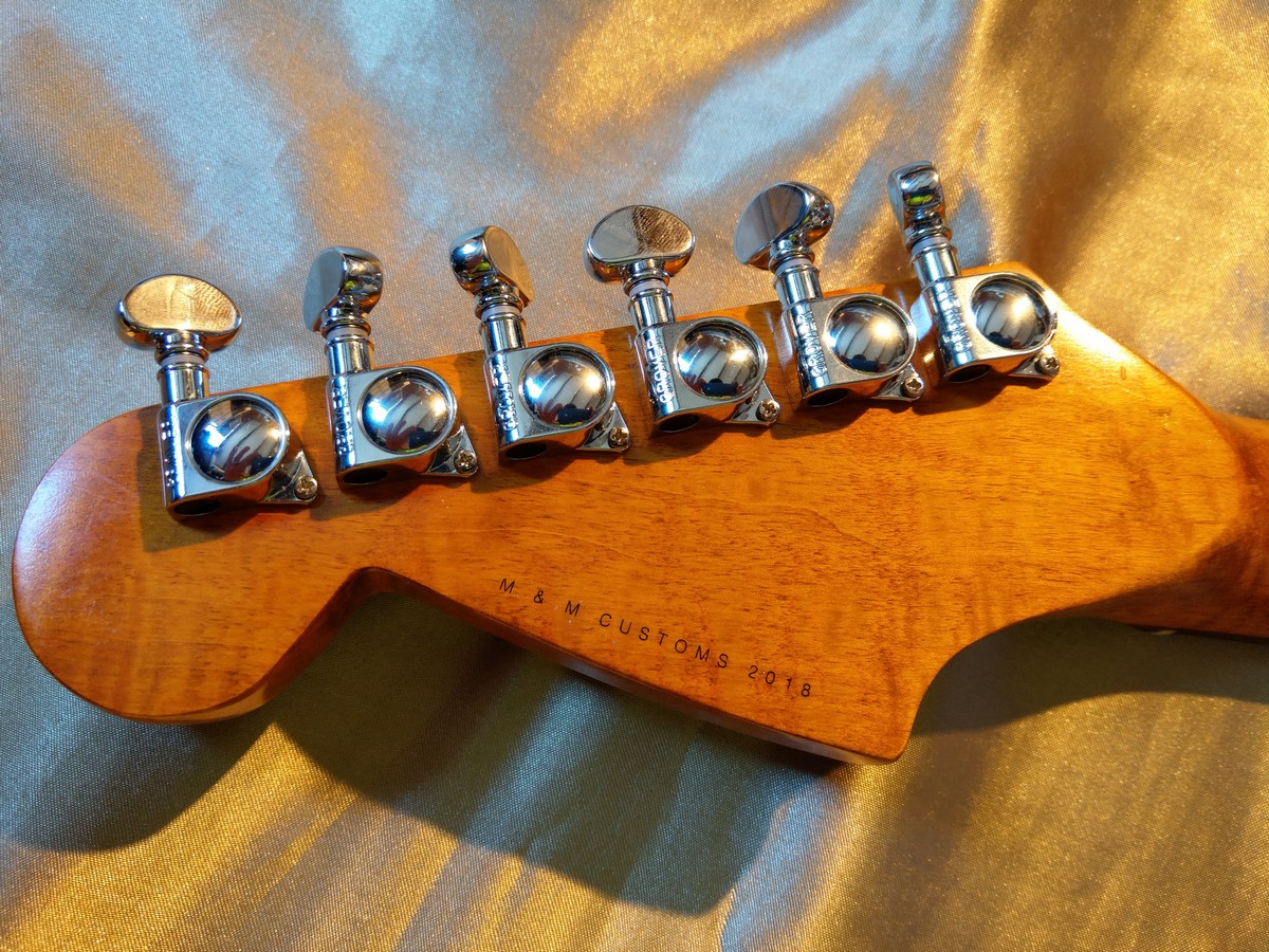

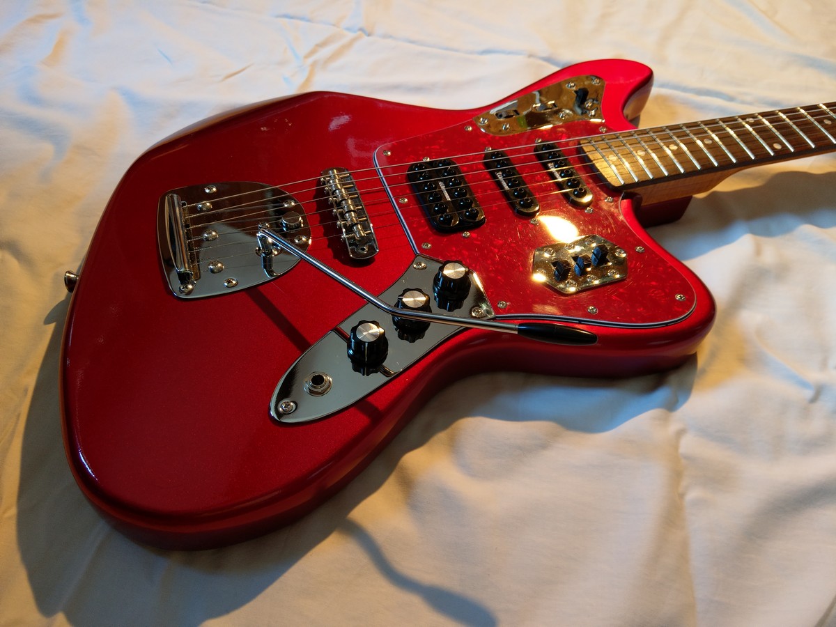

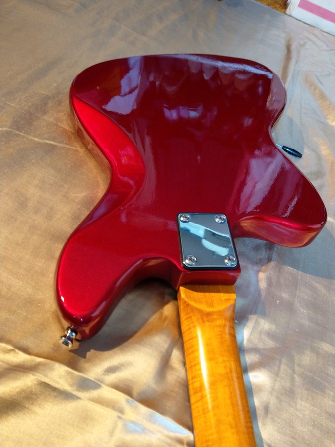

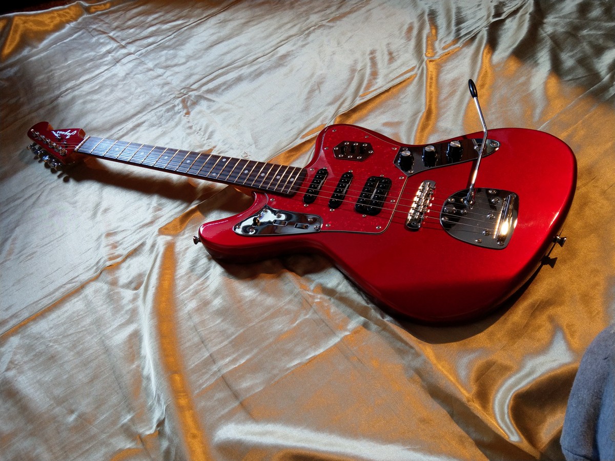

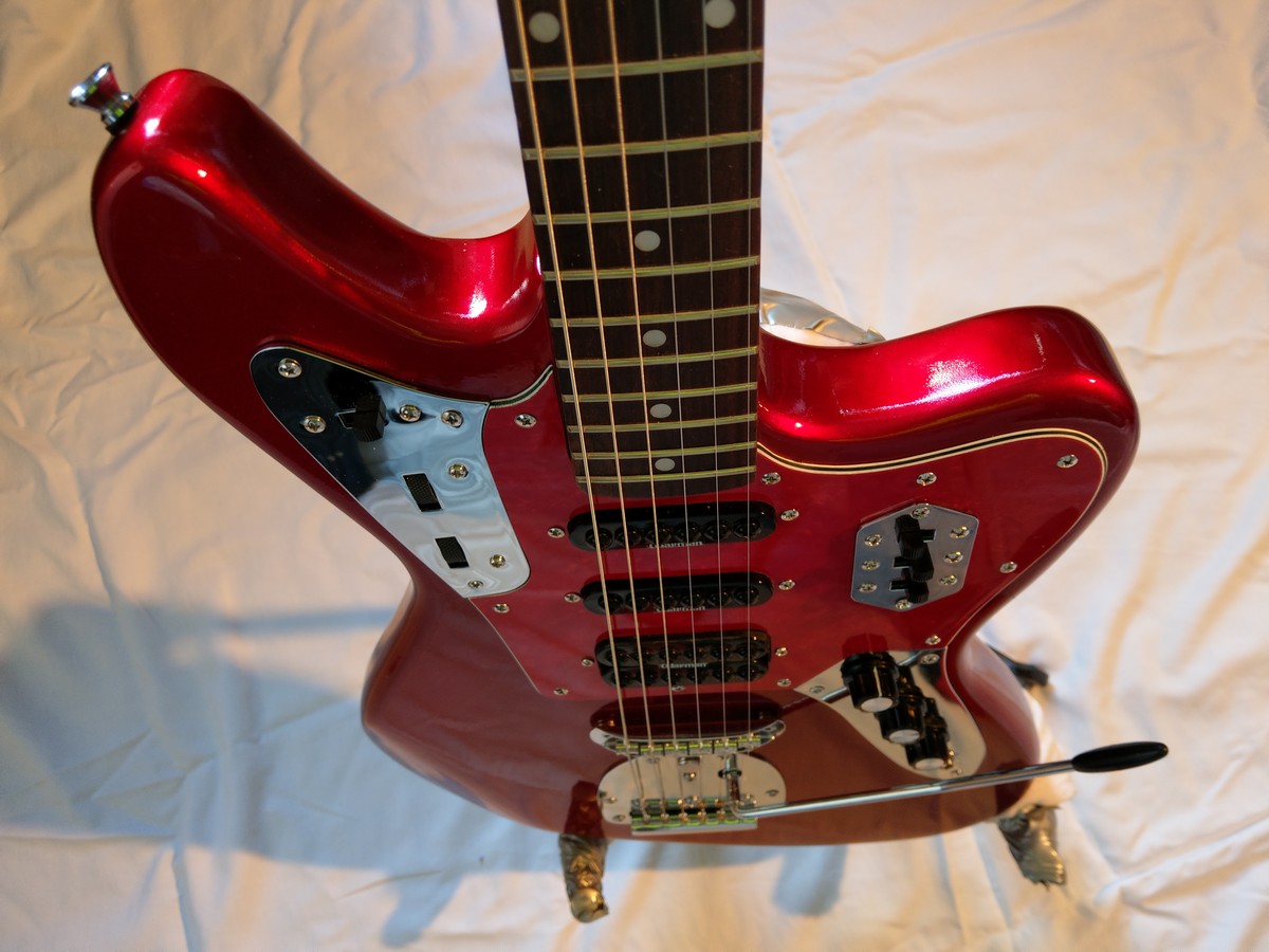

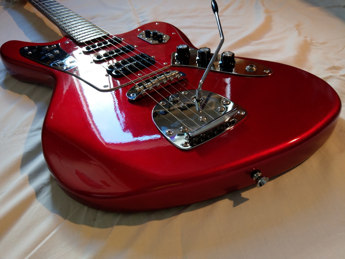

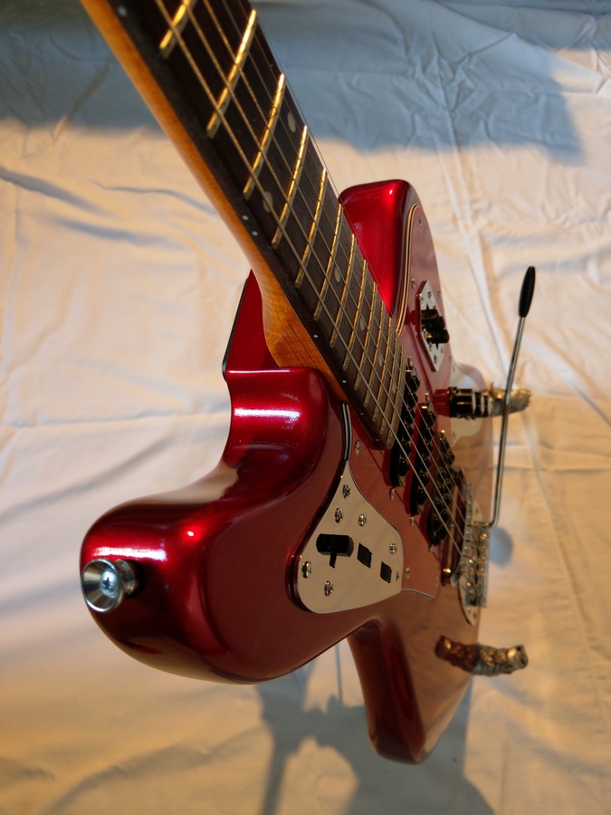

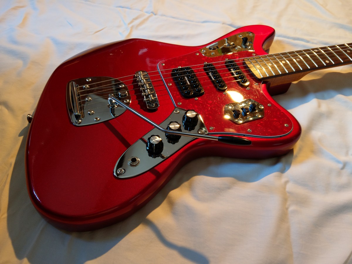

    JM-1 By Nitroburner aka Mitch
    Whew, im finally finished, 14 months in the making and a brand new learning experience at every curve only smoothed over by this communities help, so A BIG THANKS GUYS.
    Esp to...Weirdbits for the wiring help, Sonic Mountain and King casey for the headstock decal help, Simon for the technical detail, Wokkaboy, Dedman, Wazkelly, Frankenwashie, Chuck, Olisam, for the continued support, Zeromick for guidance, and all the others, you know who you are, without your help this project wouldnt be finished.
    SPECS
    As the JM-1 comes with a fender style bridge and is not setup for a jaguar bridge setup and tremolo assembly i had to custom route for the bridge and tremolo setup, custom make the pickguard from a blank.
    This guitar is setup like a normal jaguar but with these differences.
    The top horn switch in the up position activates the neck pickup with a separate volume and tone control set in the chrome addon.
    When the switch is in the down position it activates the humbucker and the middle pickups with their separate bass, treble and volume knobs.
    The difference her is that the lower 3 switches have been wired as 1) master volume 2) treble cut tone 3) bass cut tone. These are generally referred to as G&L Style PTB Tone Stacks. They have a very interesting sound.
    The last 3 switches are on and off switches for the 3 pickups.
    The body and headstock are finished in candy apple red with a 2k clear over the top. It has 4 primers, 3 silver basecoats, 3 cherry apple red coats, 2 clear coats, then 2 more cherry apple red coats finished with 4 coats of clear.
    The headstock decal was redesigned by Sonic mountain, painted and applied by myself and coated with 6 coats of wipe on poly then polished.
    Grover tuners, aftermarket knobs, and chrome accessories, and Warman pickups.

    Some more...
