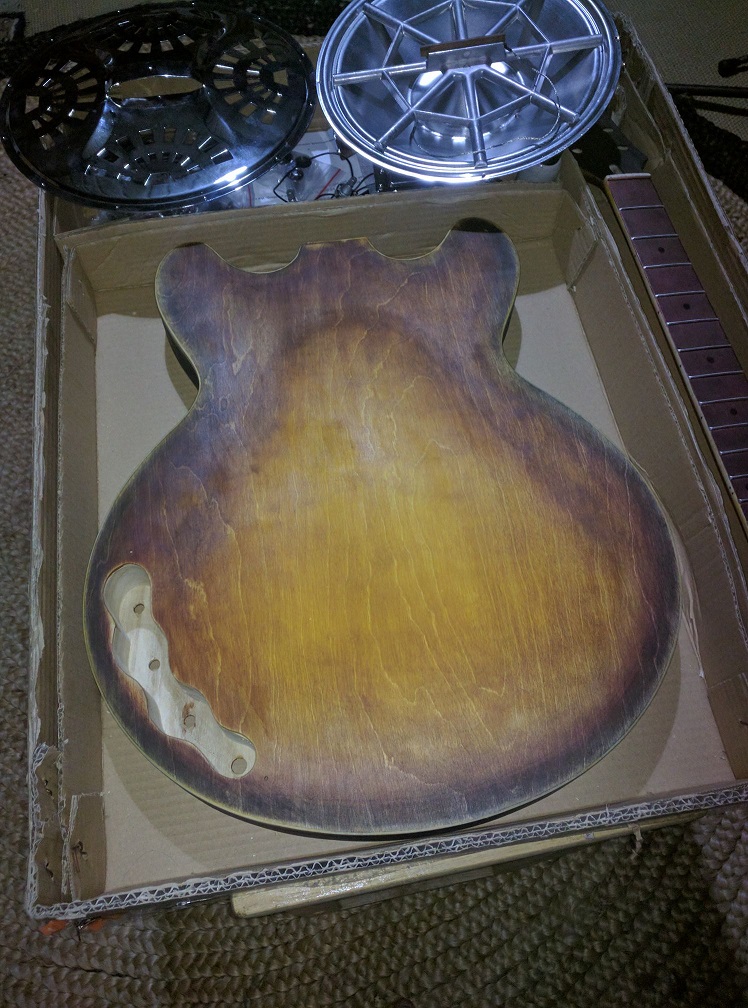

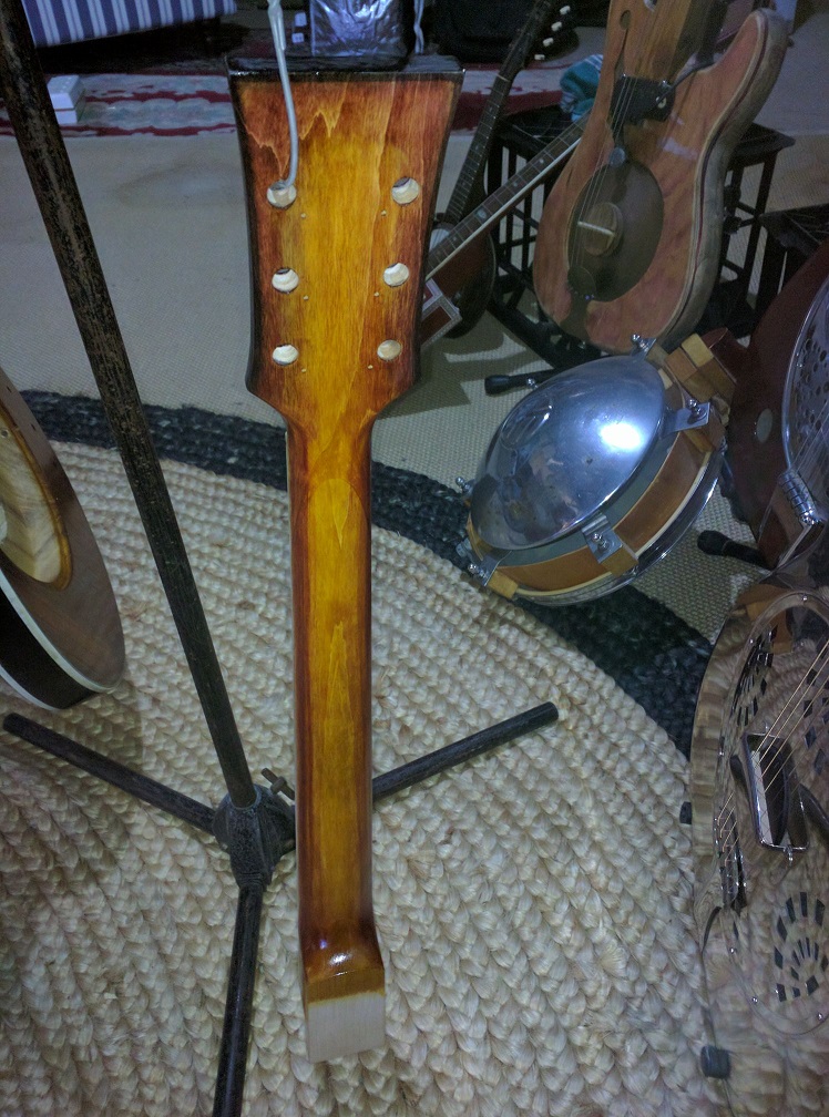

    First stage, no assembly , prep work, sanding and staining, stain colours : Golden teak, Mahogany, Black.

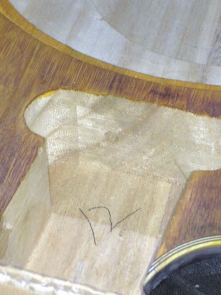

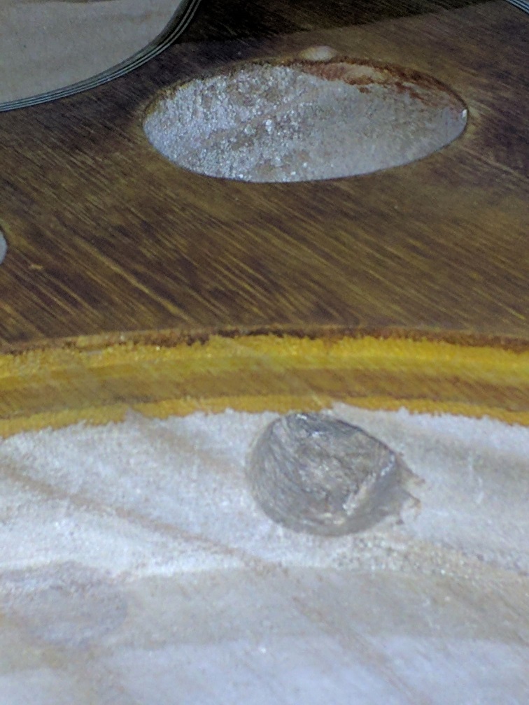

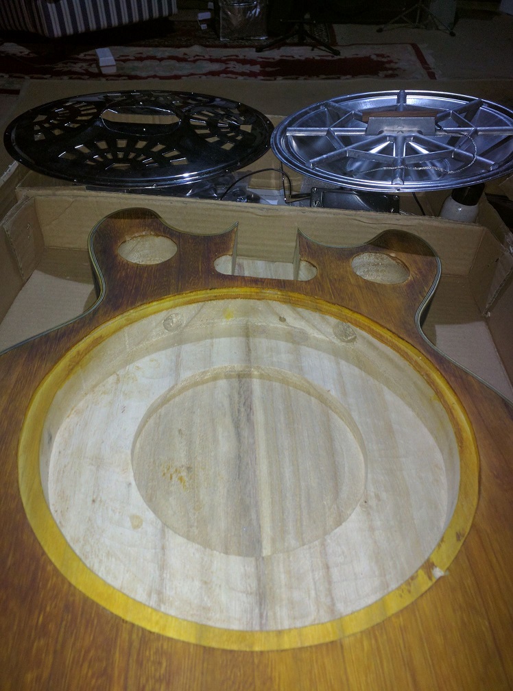

    Prep work pre assembly
    Drilled holes for pick up wiring and through to sound holes.

    5,666
    Nice work Mr Frog, how did you get into bore the through holes for the sound screens? I really like the burst effort, looks fantastic.

    Just used a battery drill and 14mm spade bit, drilled from both sides, happy with the stain effect should look good when varnished.

    I thought it would be easier to work on (sanding, staining , varnishing) before any assembly, sound holes,not sure it will make much difference to the sound as it's an electric guitar but may make a difference if just playing the guitar without an amp.

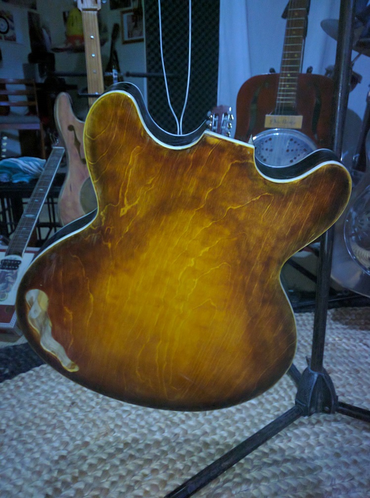

    second coat
    second coat
ID:	26240   Click image for larger version.

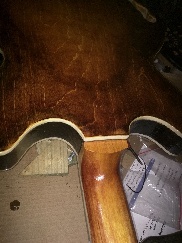

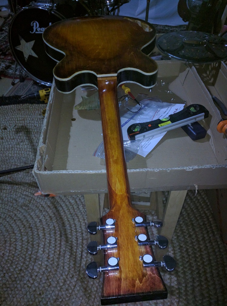

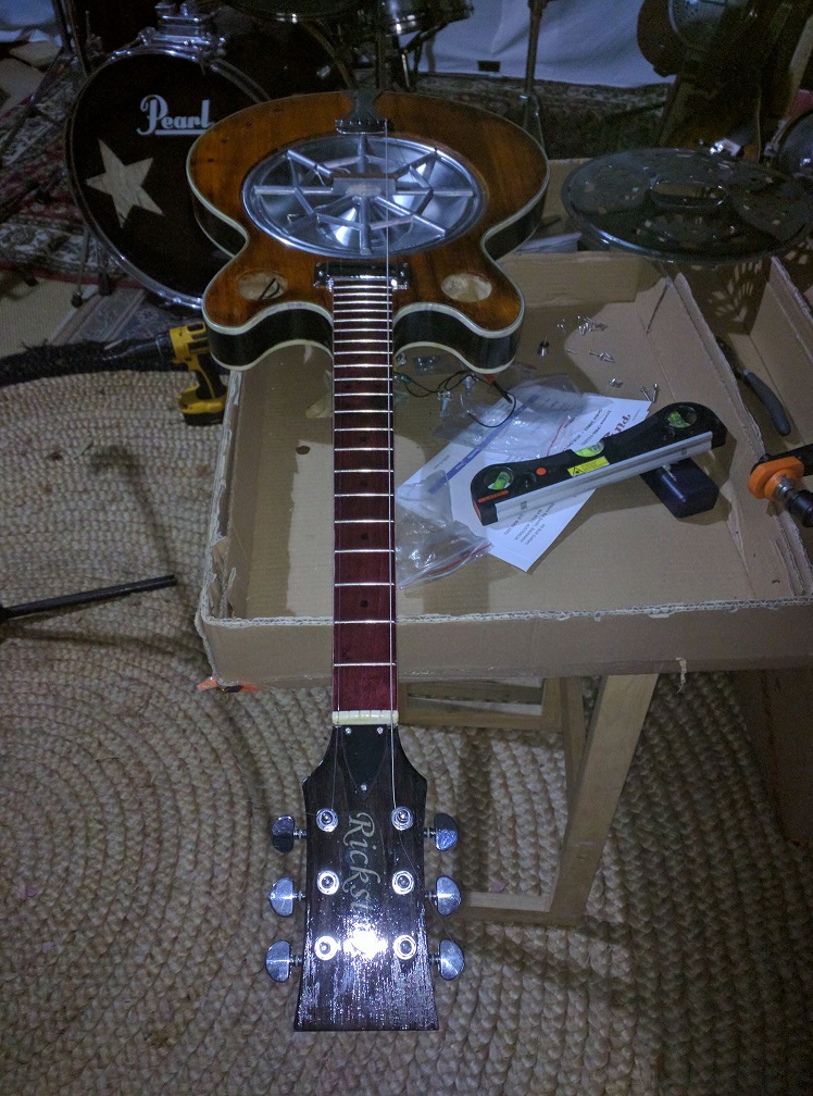

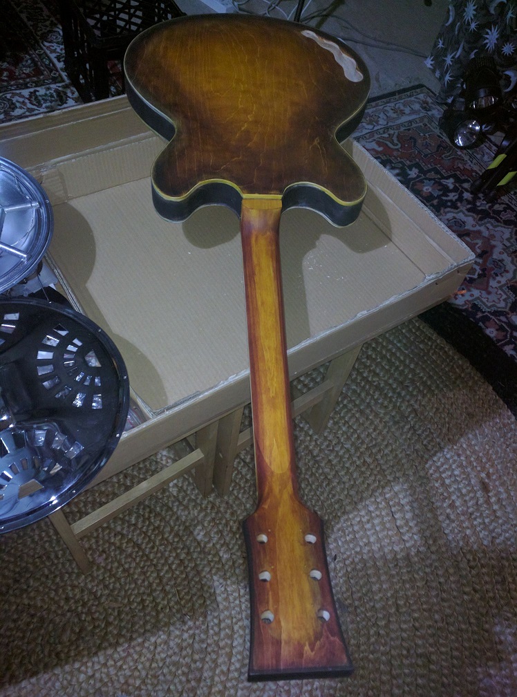

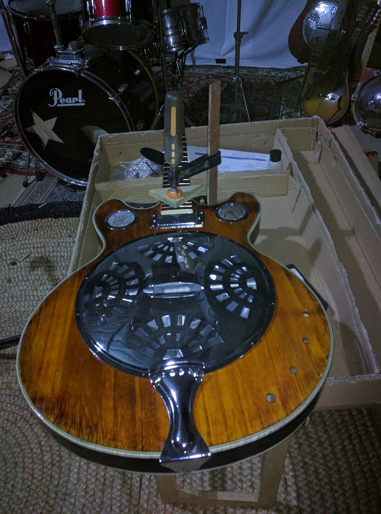

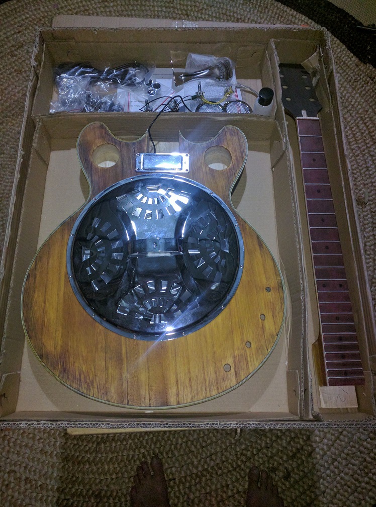

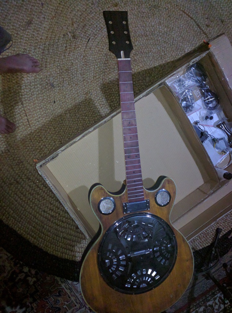

    Resonator

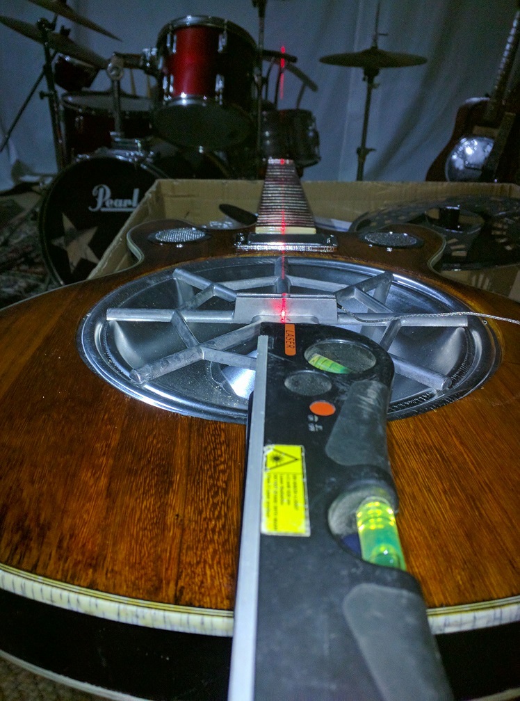

    Gluing the neck, fitting machine heads, checking neck alignment. fitting tail piece
Name:	A reso1.jpg
ID:	26378   Click image for larger version.
Name:	A reso2.jpg
ID:	26379   Click image for larger version.
Name:	A reso3.jpg
ID:	26380   Click image for larger version.
Name:	A reso4.jpg
ID:	26381   Click image for larger version.
Name:	A reso5.jpg
