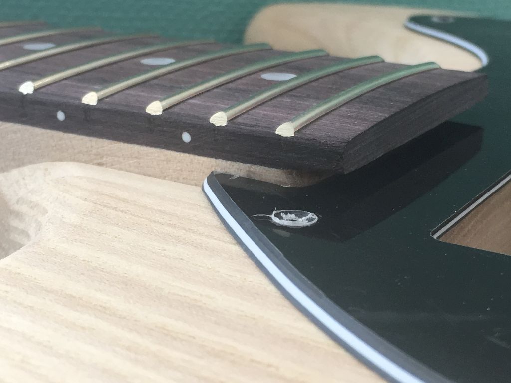

    I've read the full builds on here and have one major query. The neck fits nicely into the body, not quite as tight as I was expecting but no slop, however I wasn't expecting the fretboard to overhang with body with the pickguard in place by around 3-4mm. There's no way of seeing a proper one in the flesh to see if they're all like it and it's not obvious on the build diaries so is this correct? I realize the paint finish build up will lower it by a mm but the idea or taking a mm of the back of the neck and pocket is quite daunting for a newbie.

    Mine has the same over hang, nothing to worry about .
    That's great news, I just watched the Guns & Guitars video on YouTube and it's the same but as he was building straight out the box thought maybe he wasn't as fussy as I am!

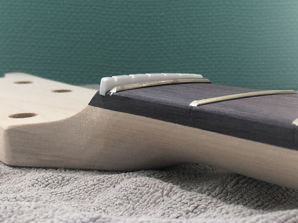

    Next issue which seems to be common to these kits is the height and unevenness of the nut. What's the best way to approach this, take it out and file down the base or file in situ and gradually refile the grooves? Alternatively replace entirely with a bone one?
    The zero fret looks like it needs tapping down in the photo, it's actually Ok and just a shadow.

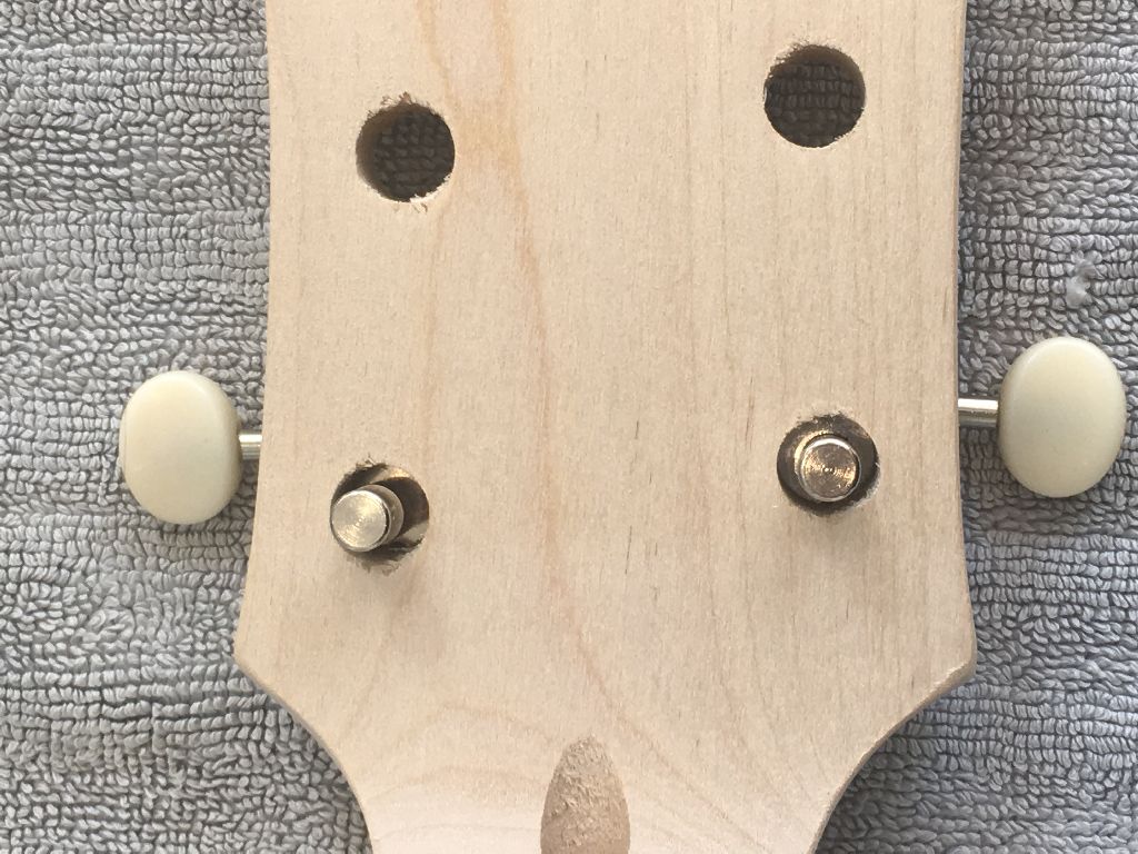

    First little hiccup today, soon solved. The bushings for the Kluton tuners (which look great) are too small and my first thought was to dowel the holes and drill or ream them to fit. However after a quick YouTube search it became obvious that this can be solved with wider diameter bushings so some 10mm ones were sourced and ordered.
    I also decided I'm going to knock the extended outer headstock detail down a bit to make it look more authentic, I need to make up some sort of template first, maybe from enlarging printed photos on a copier.

    You should be able to source a bone nut from Pitbull or eBay, I'd remove the one you have with a small screwdriver tapping it from the sides and lifting it away, after scoring the joint with the fretboard with a sharp knife. Really worth the upgrade, especially as you are upgrading so much of the hardware.
    Thanks, I've ordered a couple of bone Strat nuts from China from ebay. Risky bit lets see what arrives.
    I did a very quick mock build with the stock parts and all lined up OK with a bit of a wiggle, maybe a bit of veneer in the pocket is required but I'll deal with that after the sanding. The bushings for the tuners arrived and solve that problem, they may need a wrap of tape on the shaft to tighten the fit or maybe a bit of epoxy.
