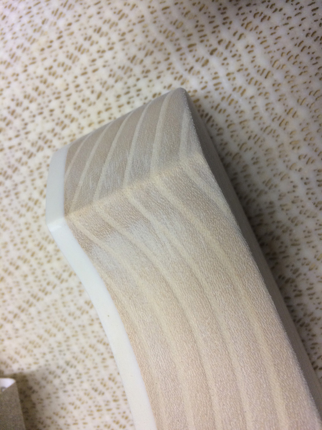

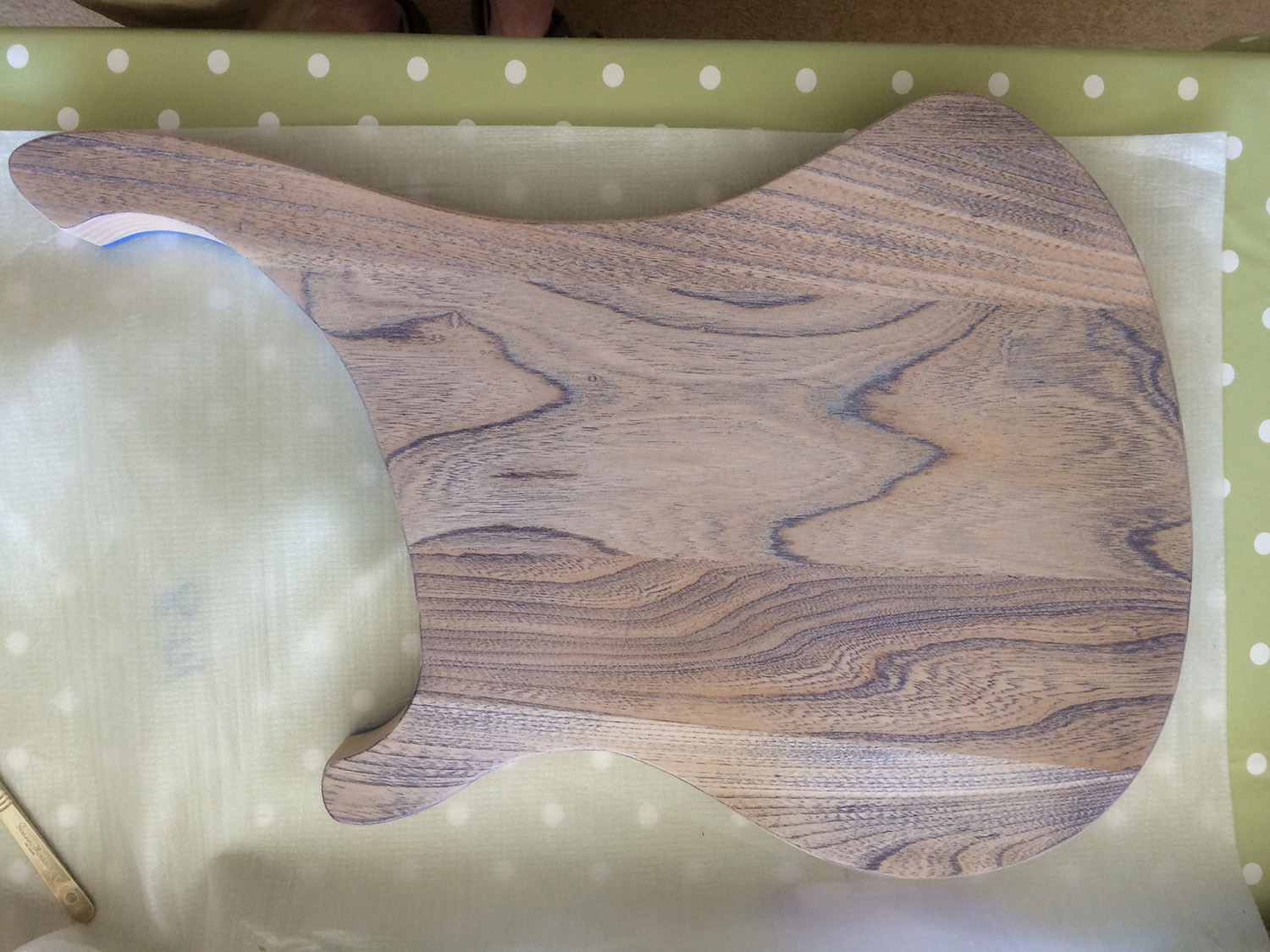

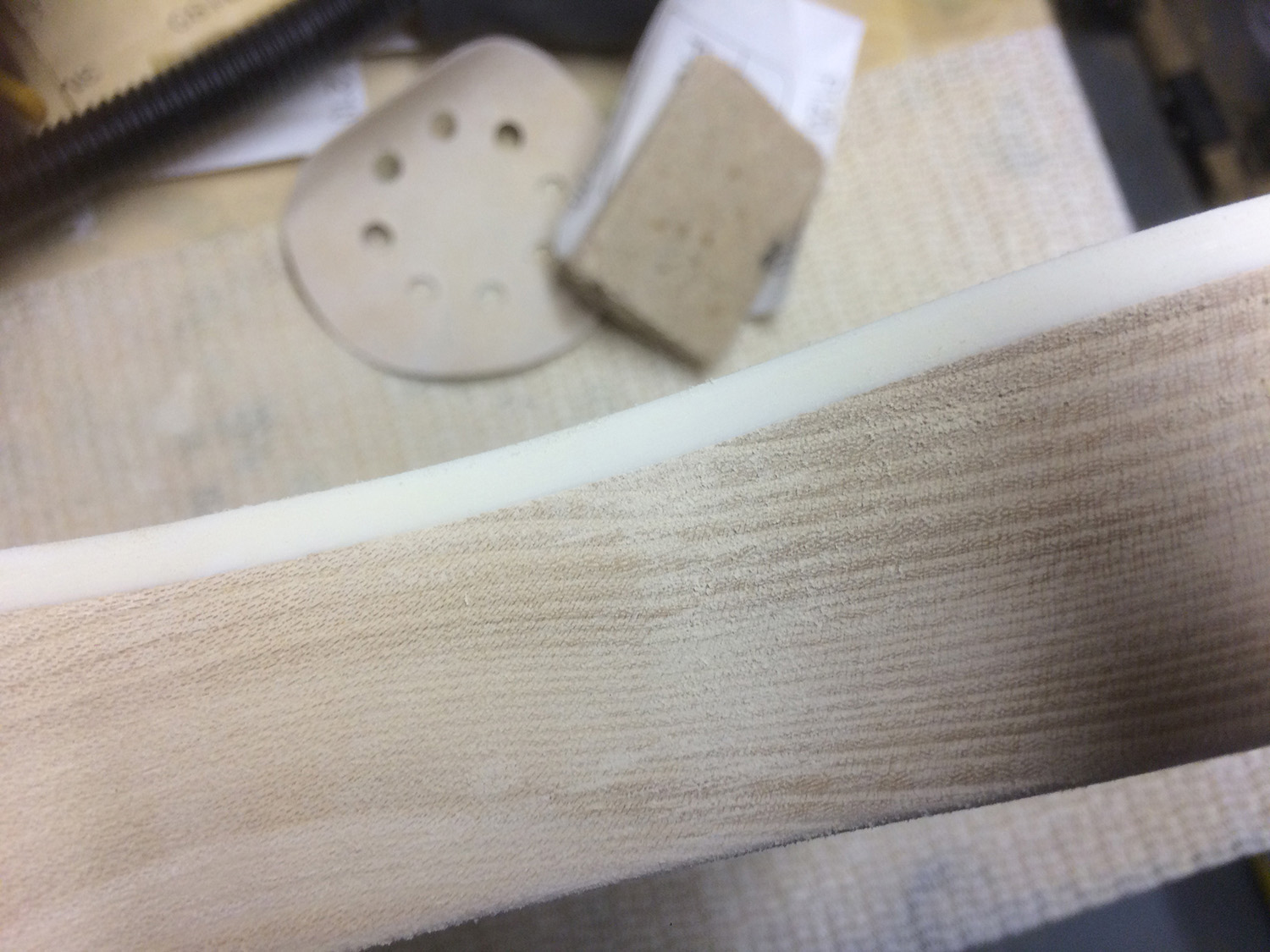

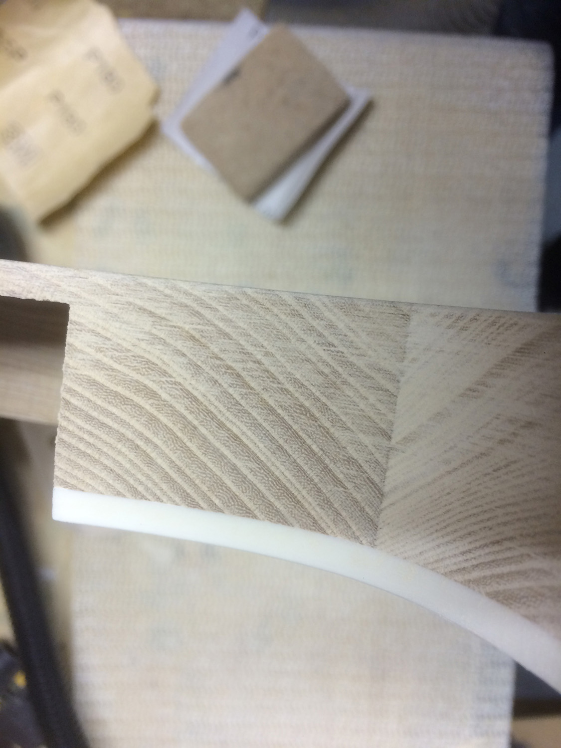

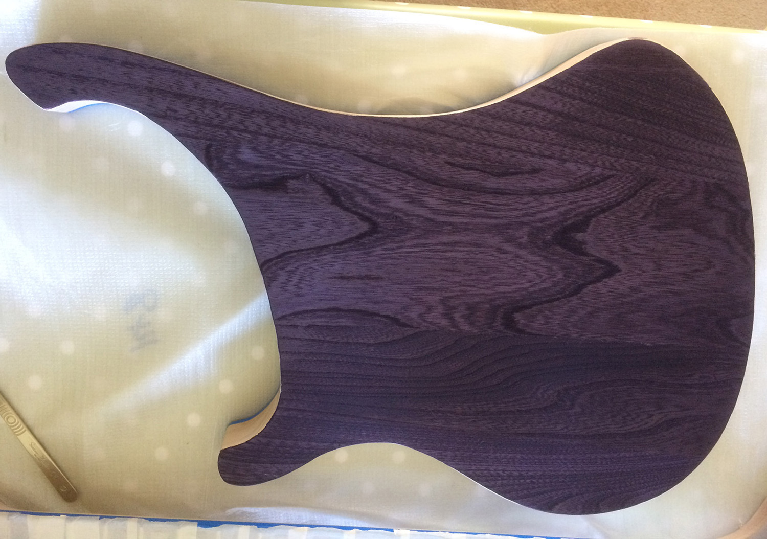

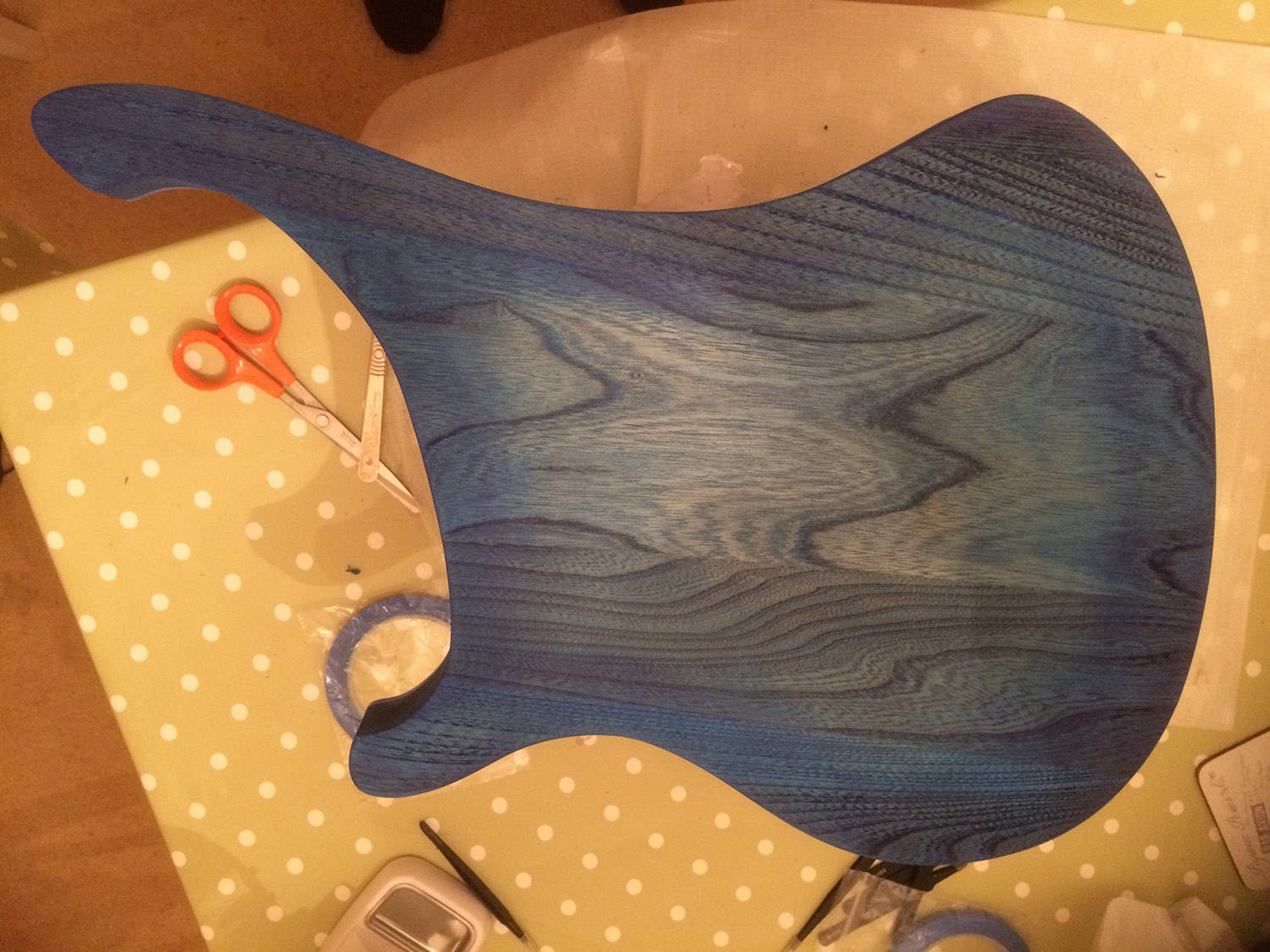

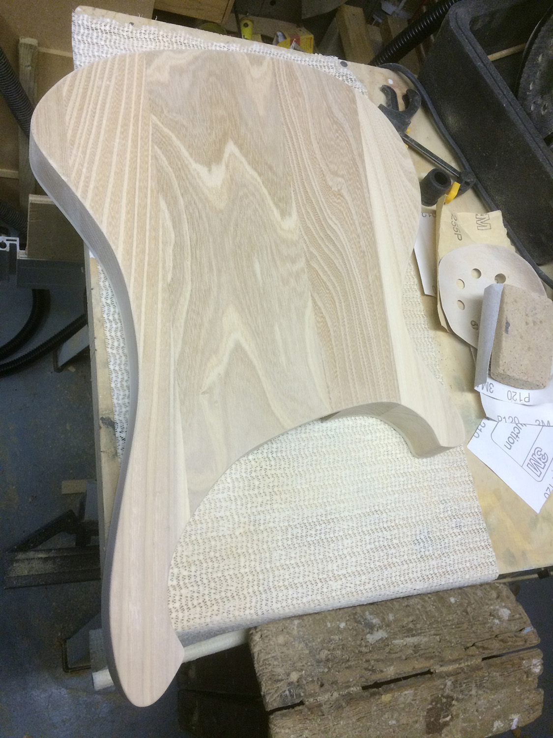

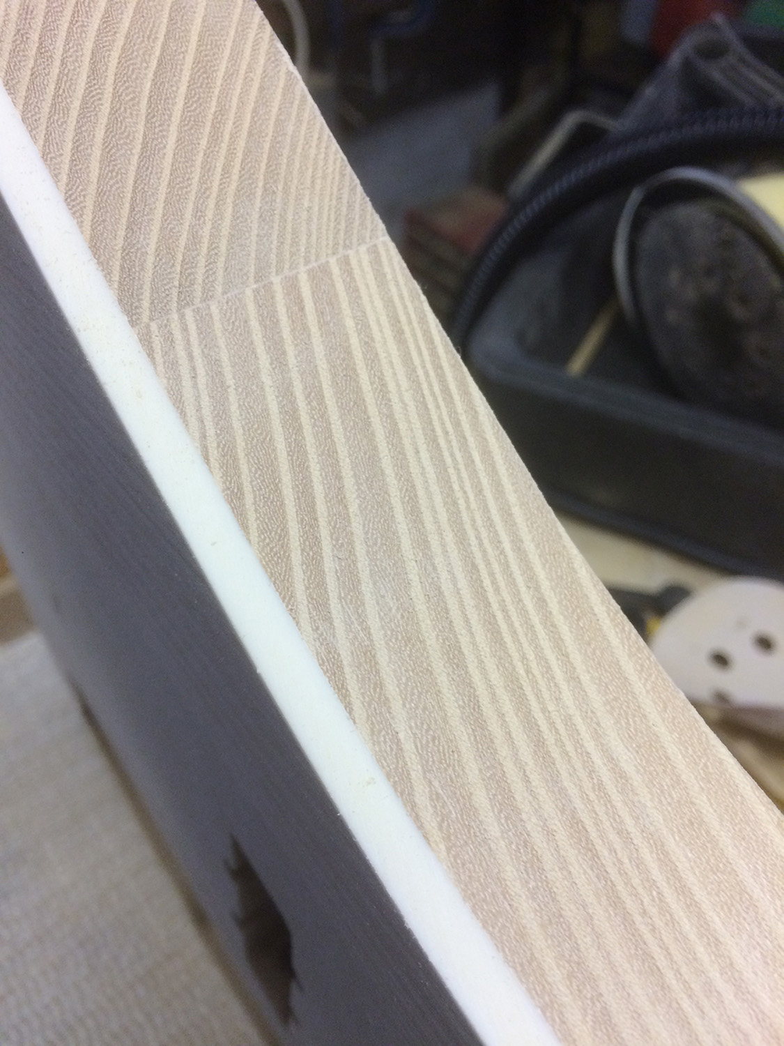

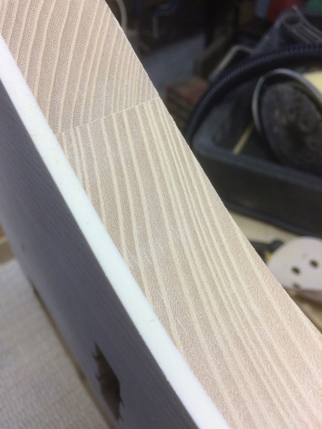

    So I've made a start...

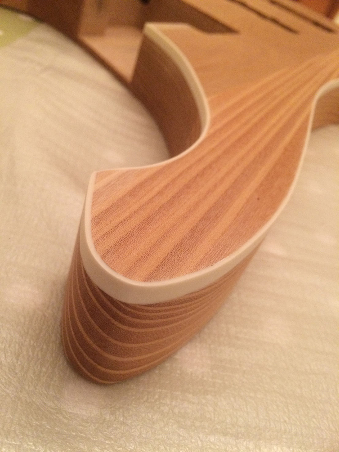

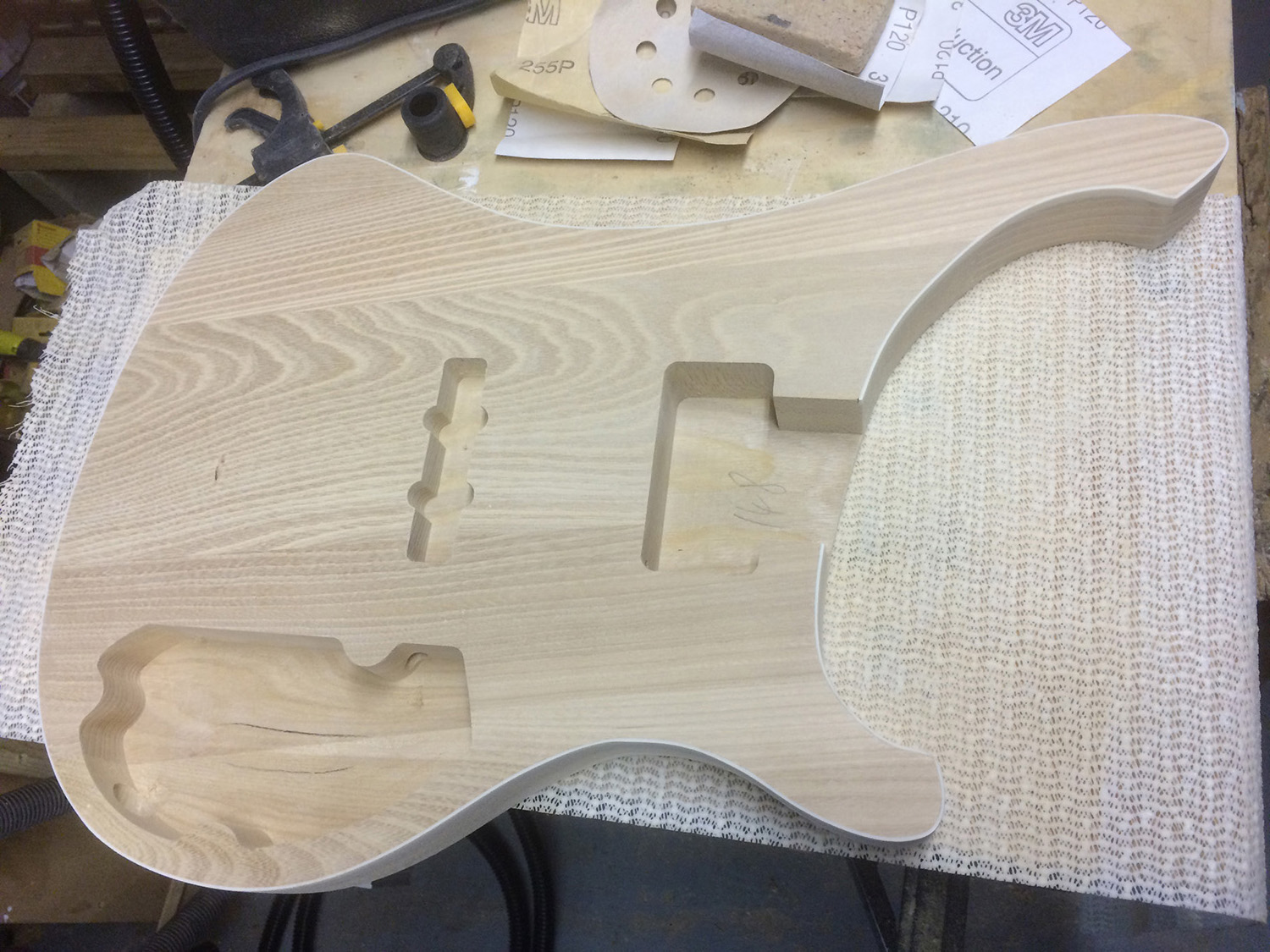

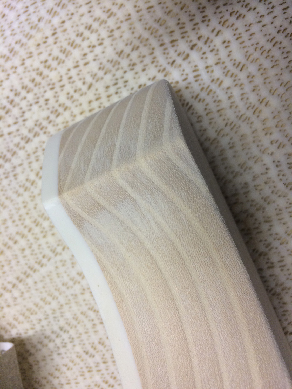

    Been sanding a lot, 4-5 hours on the body and most scratches are out... end grain concave edges are a sheer delight! Ordered some stain tho!

    Member Booooooom's Avatar
    Apr 2018
    England
    51

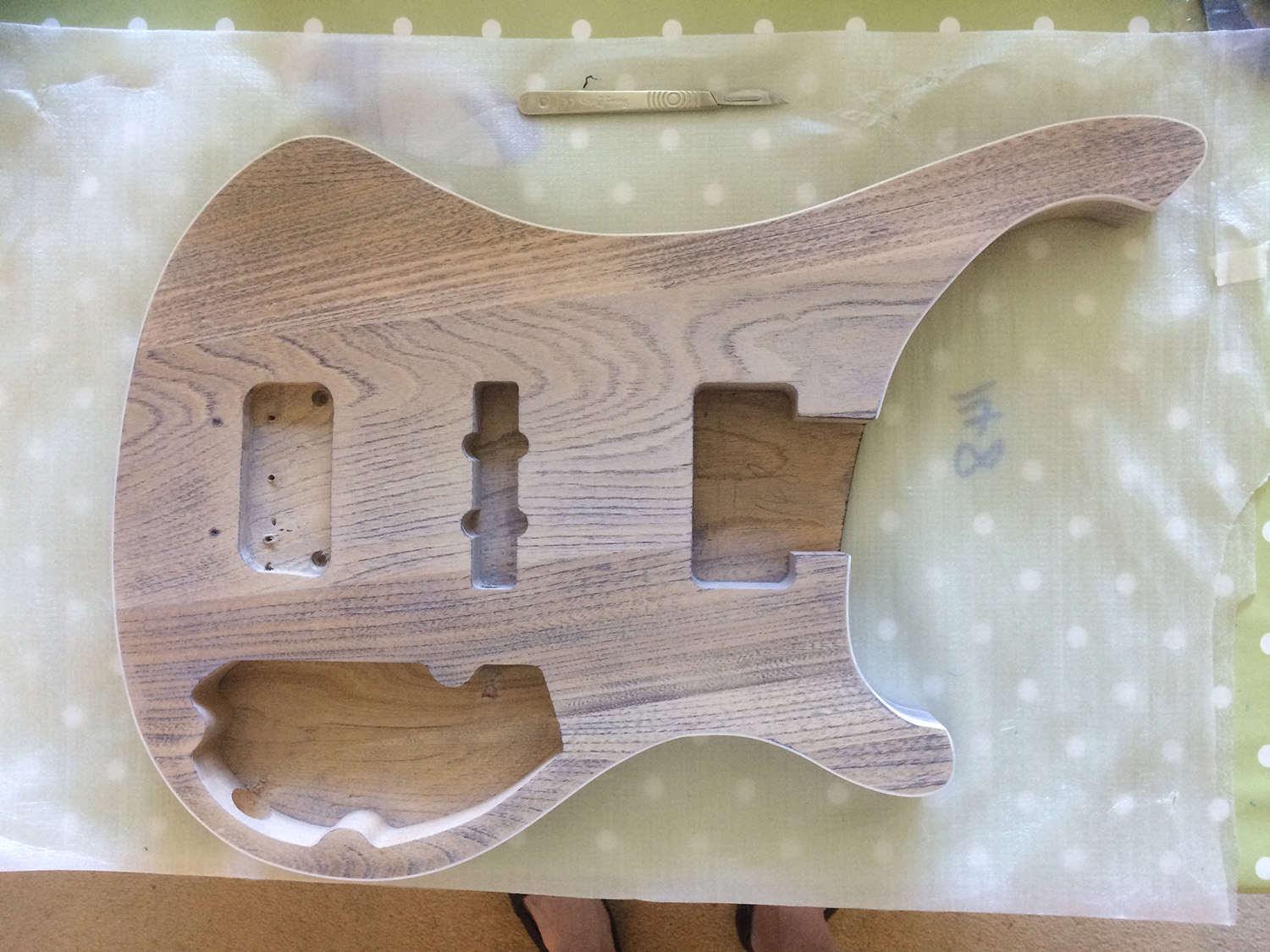

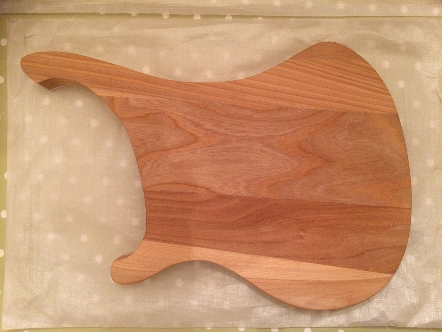

    more sanding...

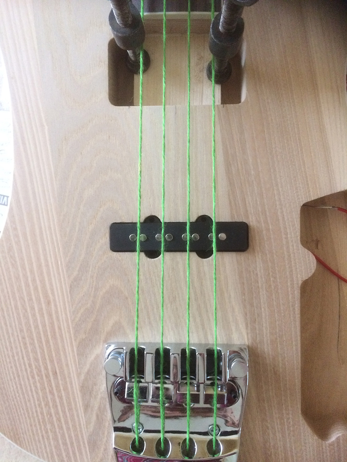

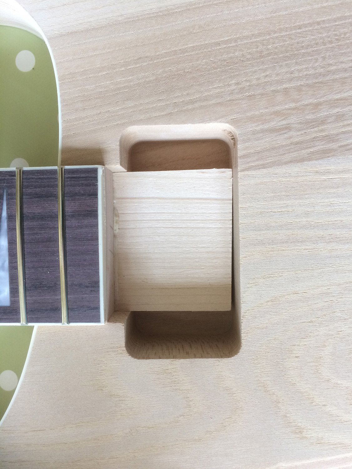

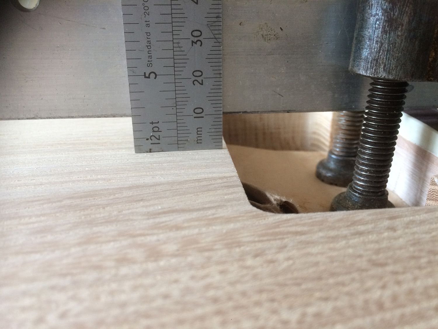

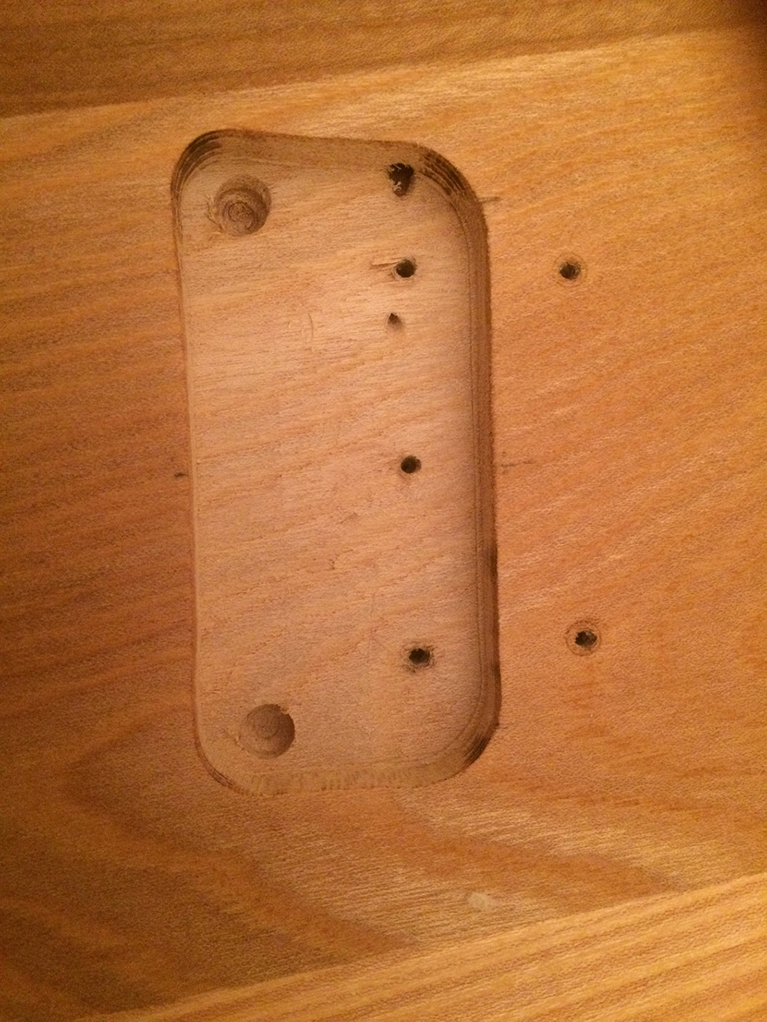

    Done a dry fit - neck pocket is nice and tight although the end of the neck doesn't sit square with the end of the pocket.

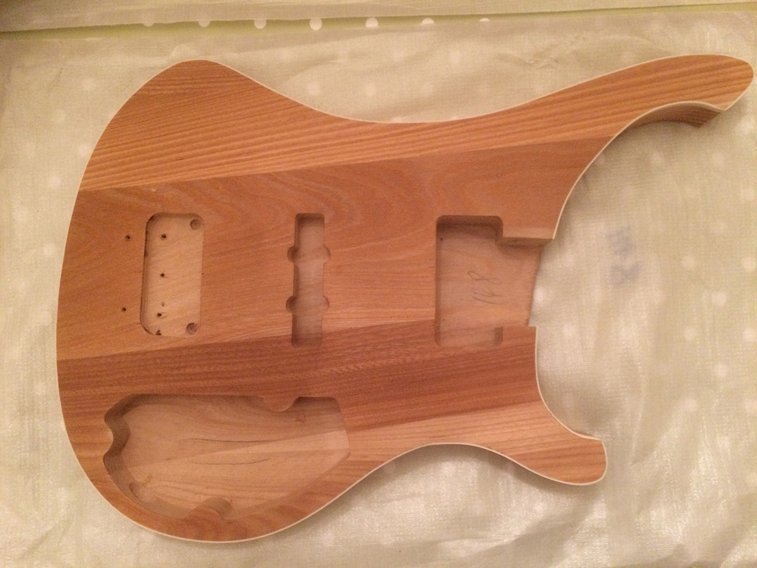

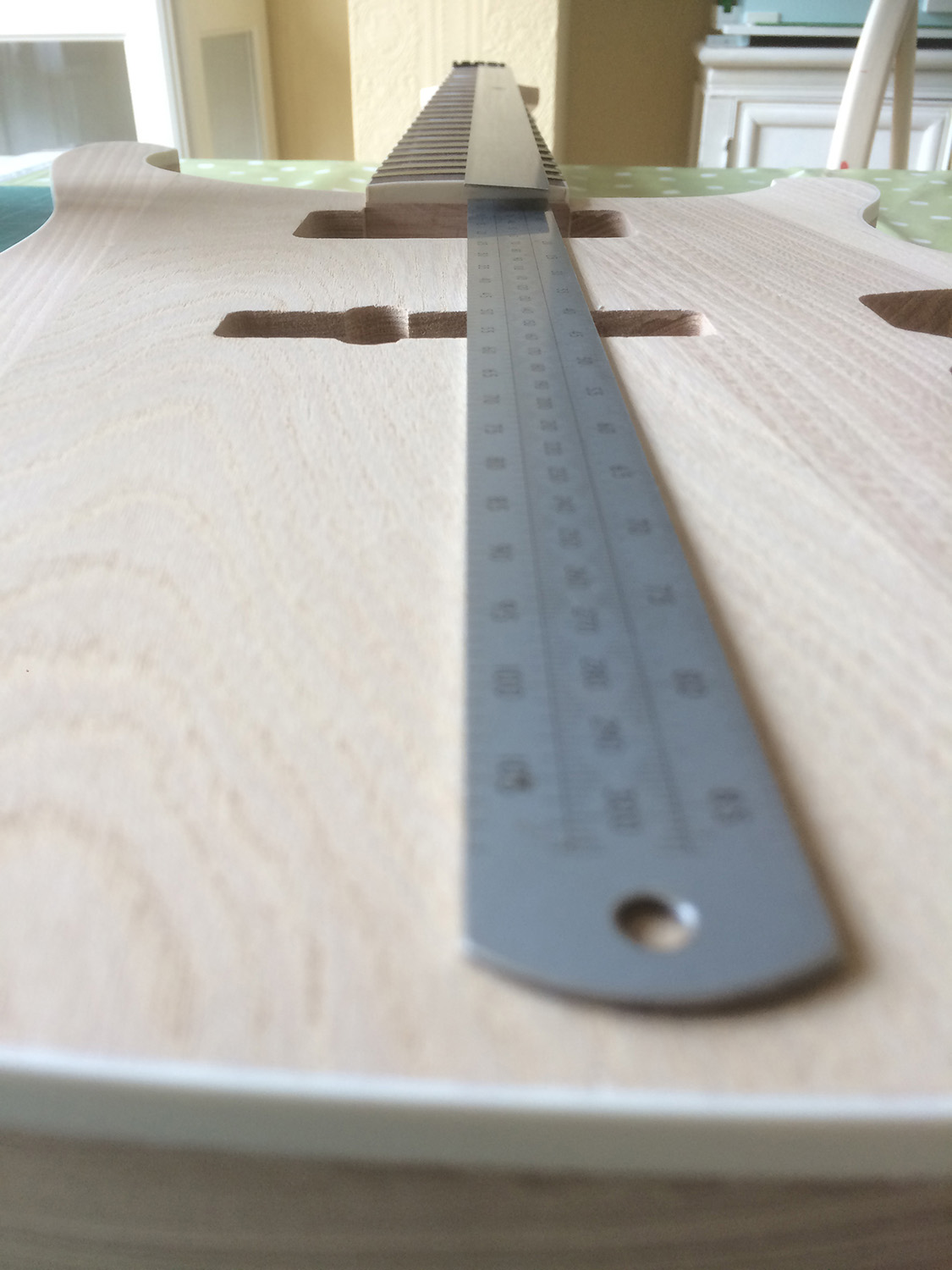

    Laying a rule down the centre of the neck and another lining up the centre of the pickup cavities shows that they are not perfectly aligned.

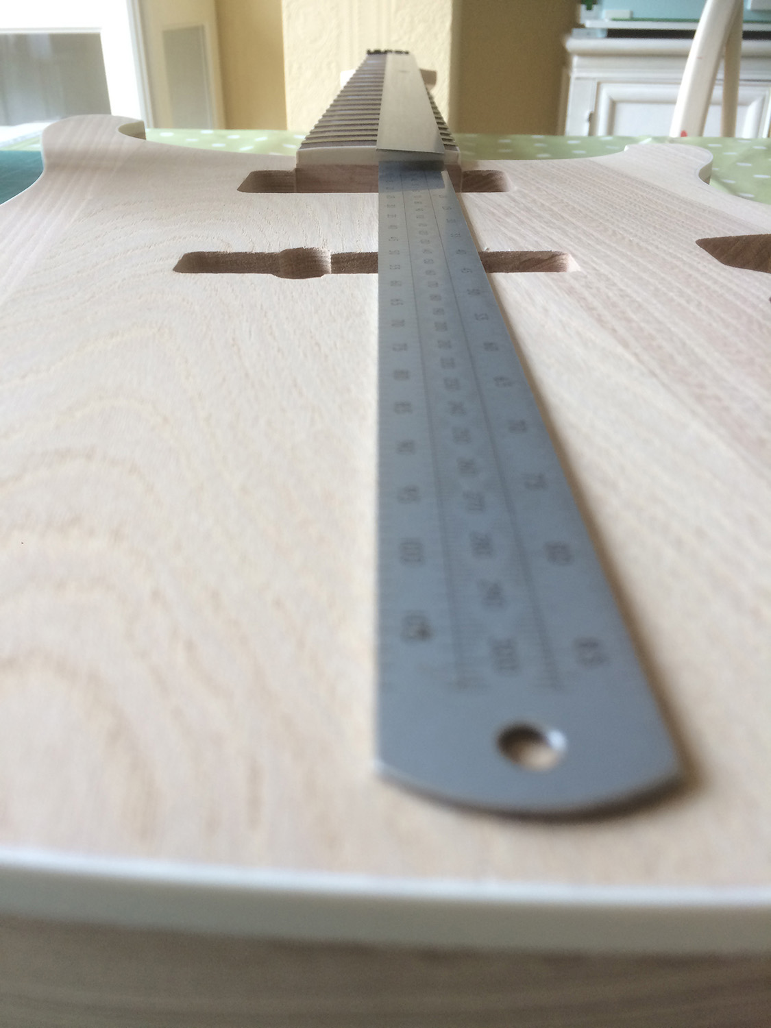

    Is this an issue as I presume all hardware will be aligned to the neck/strings? With the bridge positioned 34" from the nut and using a straight edge, the bridge/nut/pole pieces on the J pup seem to align ok.

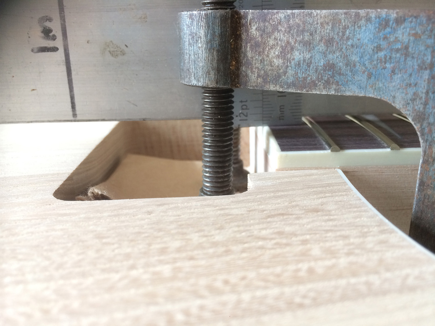

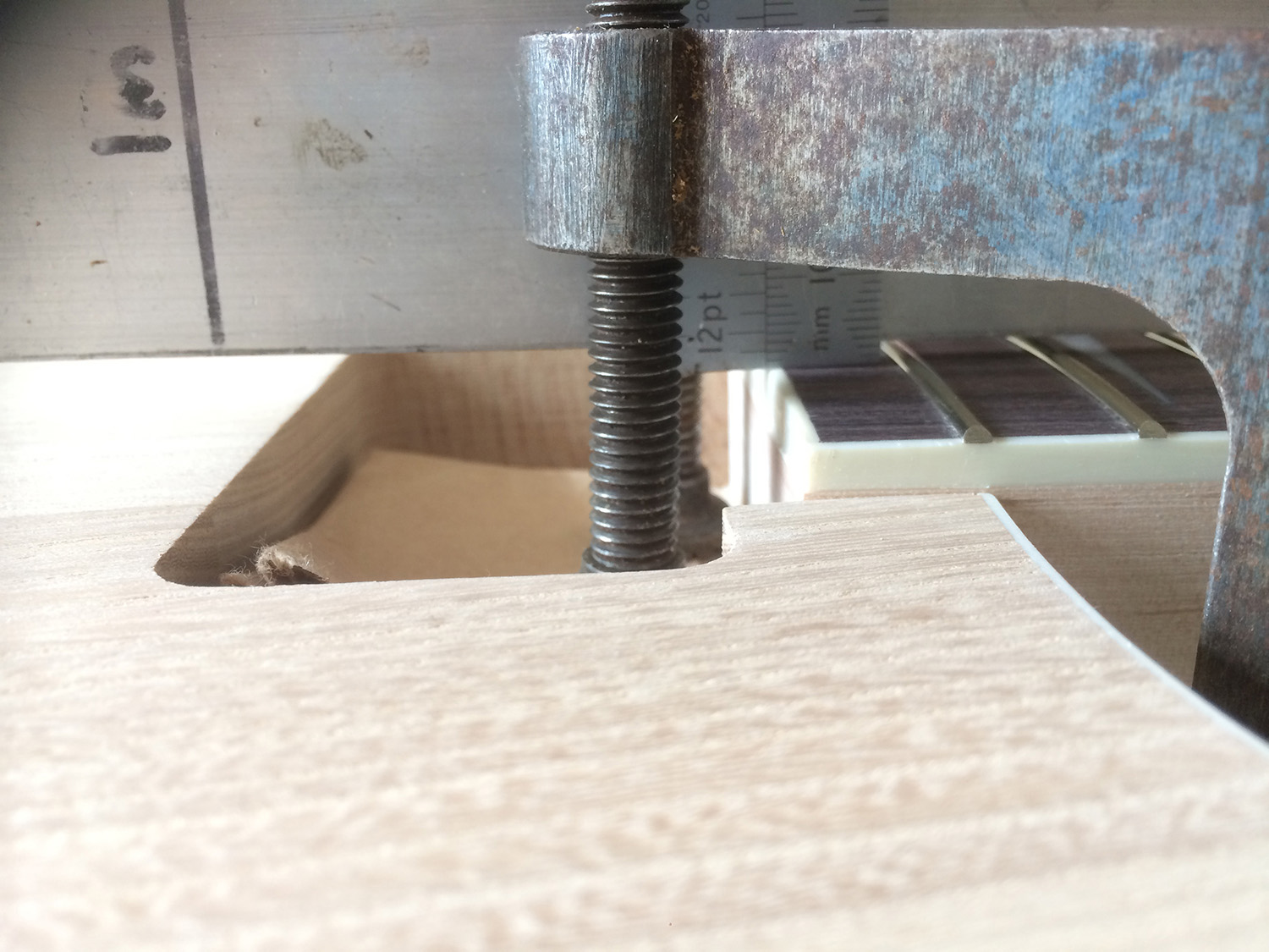

    Also, from the top of the guitar how do I know that the neck is at the correct angle? I'm considering upgrading to a ric style bridge rather than the supplied musicman style... obviously both have string height adjustment. Is there a measurement/way of making sure the neck is the correct place? With the neck clamped in place and the bridge saddles positioned 34" from the nut, a straight edge resting on the bridge and nut gives a gap at the neck of about 3mm from the fingerboard and about 10mm the body. Is this about right?

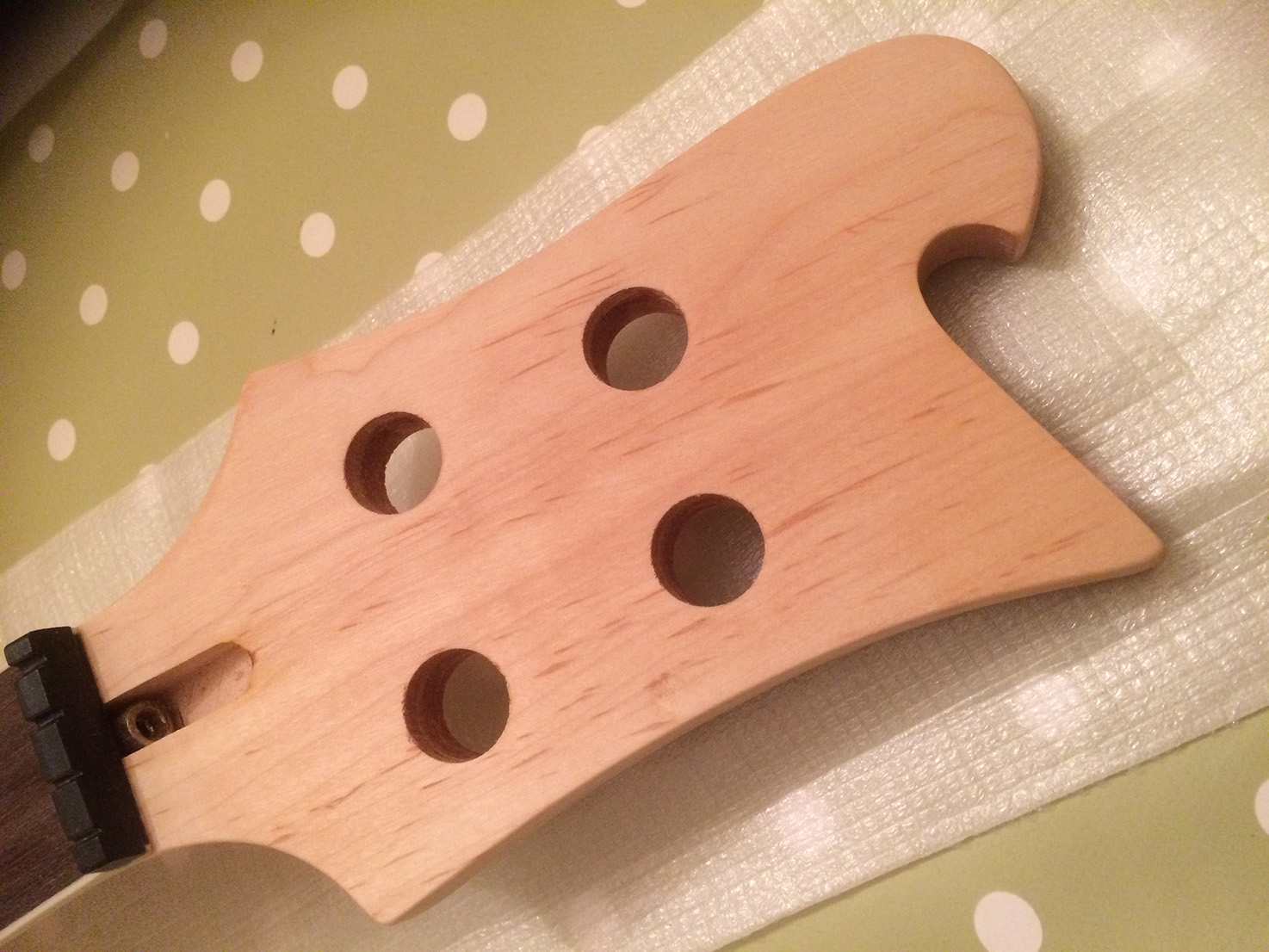

    Only other question I have so far: should the truss rod be fixed in place at the body end or is it a friction fit that secures itself once tightened? I ask now as I can slide the truss rod in and out at the moment...
    Thanks in advance for any comments and advice
