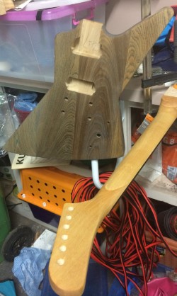

    I have done my mock build and sanded the body, but have come across an issue for clarification:

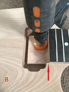

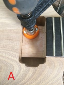

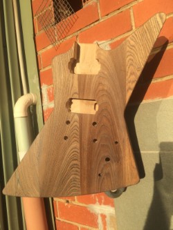

    When I clamped the neck in place to measure for the bridge (post holes pre-drilled) the measurements worked well when the neck was flush with the space for the neck pickup (Image A)Click image for larger version.
    However, in this position there is not enough room for the neck pickup to fit (as it has a ring mount). When I move the neck to accommodate the pickup, the measurements for the bridge are out by about 3-4ml (Image B)Click image for larger version.
    Having just watched the video link about neck measurements, I am assured that I would not need to cut the neck. So I am not sure how to proceed.
    I am not going to glue the neck in place until after I've stained the body so not a huge rush but it will need to be sorted!
    thanks guys

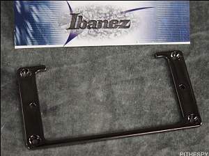

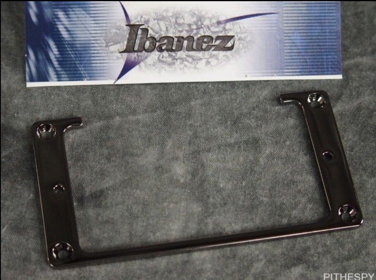

    You can buy pickup rings like this that have a piece missing in order to fit the neck position.

    Or if you have a plastic pickup ring than you could cut a piece off so it fits.
    Good point Joe, I’d forgotten abut those guys.

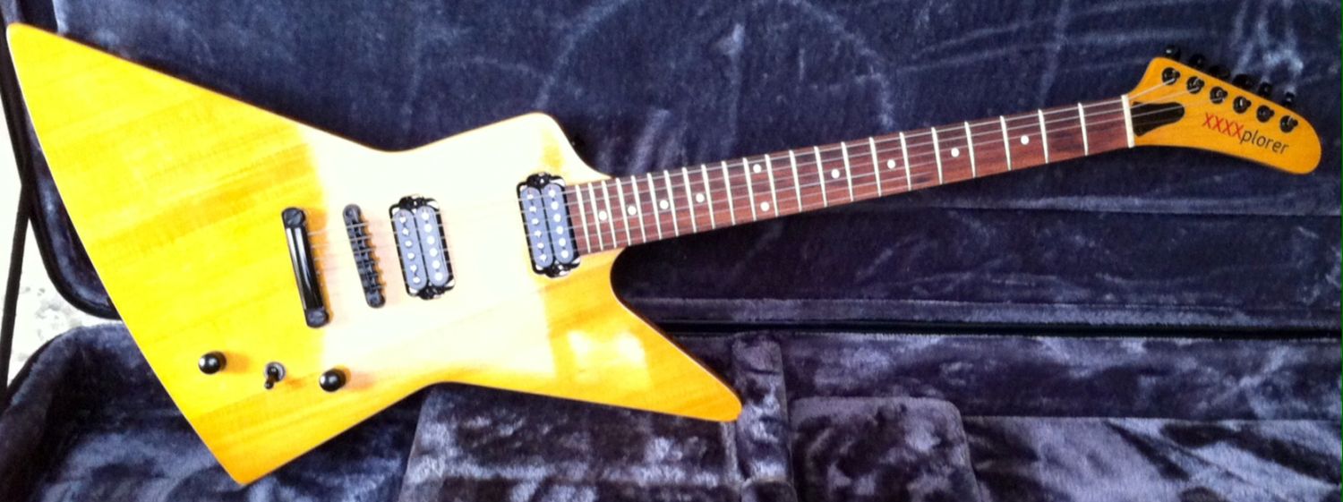

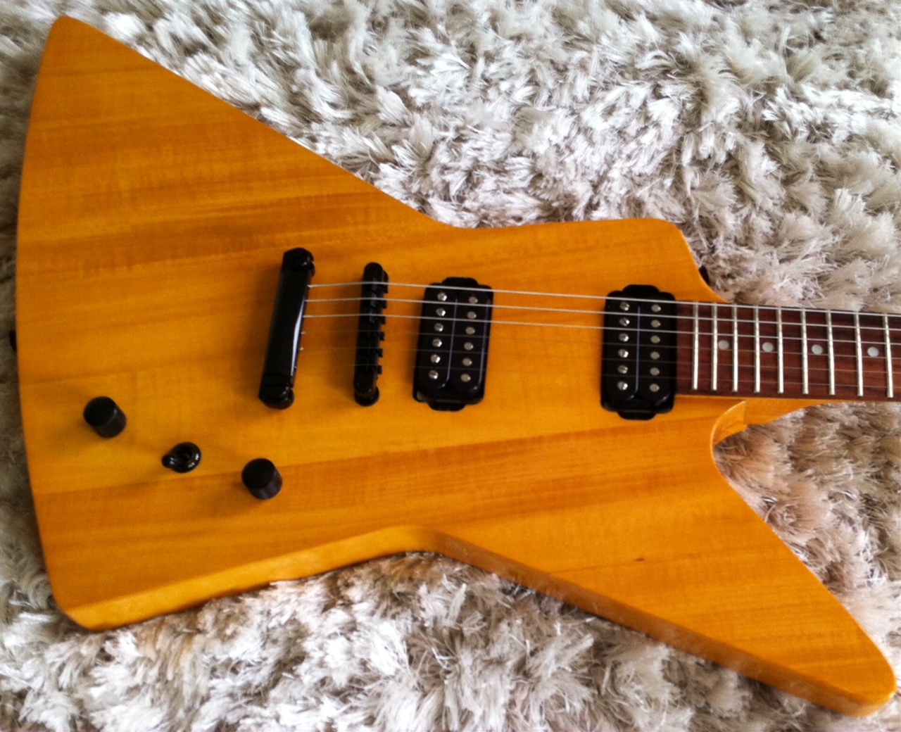

    Hey Joe, that is a great idea.
    Hesh, I had the same problem you mention here and ended up top loading without mounting rings. Fiddly job but IMHO looks great.
    Here are a couple of shots to give you the general idea of how it looks...plenty more to be found under that build thread in my signature
ID:	24855Click image for larger version.
    One alternative I seriously considered was buying Rosewood mounting rings so that once the neck one was cut it would blend in with the end of the fretboard and not look so obvious that there was something funky going on.
    Cheers, Waz
