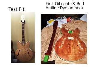

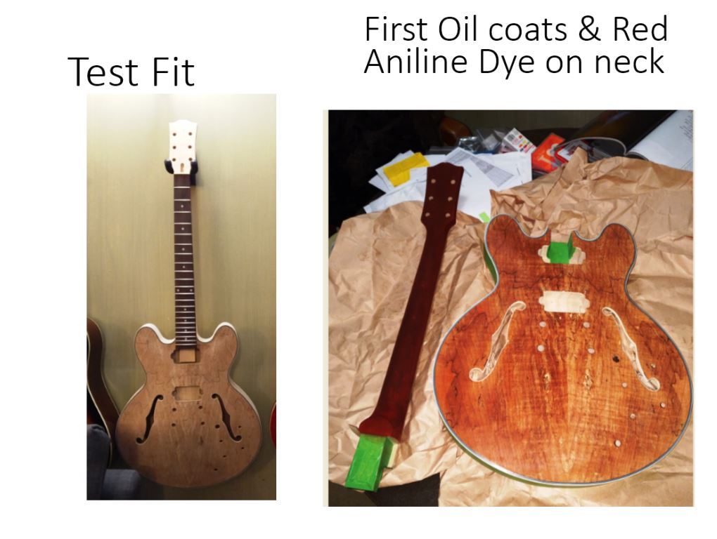

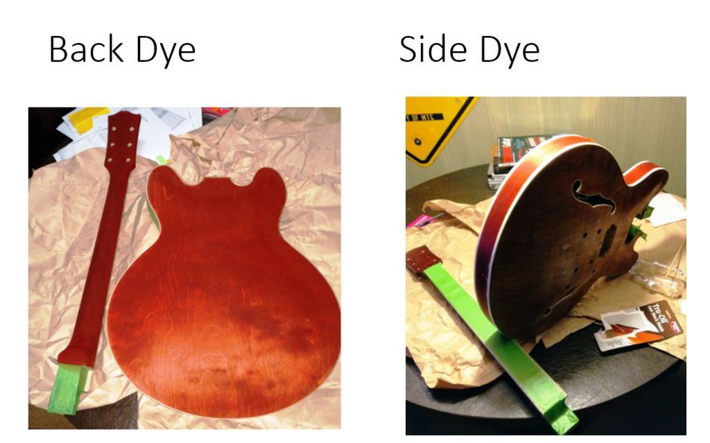

    Processing on the build. After much research on options for finishing spalted maple I have elected to simply Tru-Oil the veneer on the top face. I have sourced the Tru-Oil at Lee Valley in Ontario and also found they stock Red Aniline dye that am using for the rest of the wood work (sides/back/neck). I put a few coats of Tru-Oil on the face (after masking off the sides with Fine Line tape to prevent oil bleeding through onto the sides). This protects the top from any accidental staining when I use the Red Aniline dye.
    Super happy with the red dye, it produced a beautiful cherry red that will offset the ivory binding and spalted top. Once I figure out how to post a picture I will.
    There was a great deal of experimentation on some maple veneer samples I purchased to make sure colour / grain would look good since you only get one chance with stain. I can say that I am not dissapointed!
ID:	24866. Here is the test fit.
    Feb 2018
    Dundas, Ontario
    14
    The first coat of Tru-Oil revealed the grain nicely. As additional coats are added the sheen improves gradually.
    Feb 2018
    Dundas, Ontario
    14
ID:	24867. This photo shows how nicely the red aniline dye has coloured the sides of the guitar. The raw spalted top is set off nicely by the cherry red dye on the sides.

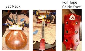

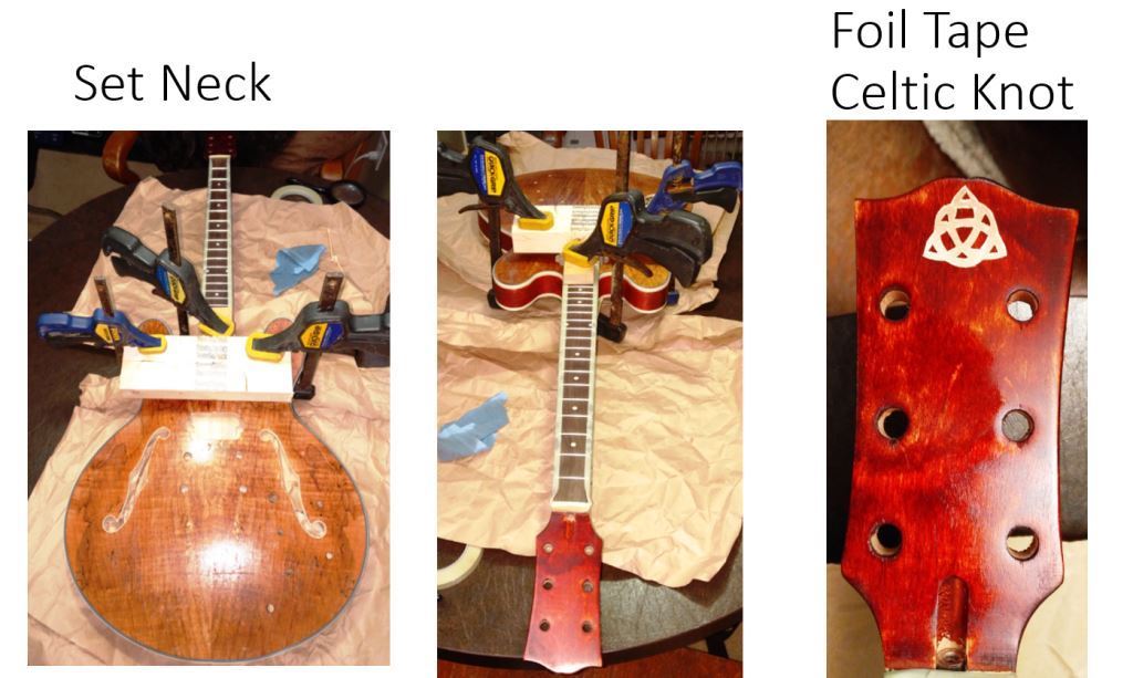

ID:	24868. I have finally set the neck. With all of the discussion about different glues I am relieved that I purchased the neck set glue from Pitbull. I had no idea of the controversy and issues with various glues. I want the neck to set and stay put without worrying about creep or weakness of the joint. I admit I would be more comfortable if I could drive a few screws in there to bolster the connection, but I am going to trust the glue supplied by Pitbull. I trust that 24 hours is sufficient to set it up so I can get back to Oiling!
    Feb 2018
    Dundas, Ontario
    14
    I also made good use of the Copper Tape to create an emblem for the headstock. A razor knife cuts it easily and if you place a printed image over top you can trace the outline and it will mark the tape. Then it is quite simple to cut out the parts you don't want and then peel and stick. Using a roll of masking tape to "iron" it out gets rid of the wrinkles easily. I Tru-Oil over top and eventually it will be buried under the hardshell coating and protected so I can Polish without worry of pulling up the transfer.
