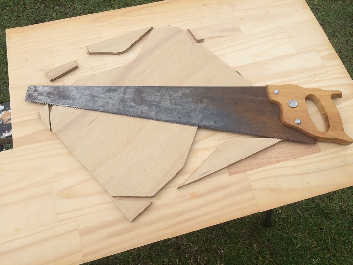

    First step is to individually cut out the rough shape of the guitar from the 3 pieces of timber. Using a hand saw all the cuts are straight lines so it is hard to match them up. Obviously there is a lot of work to be done with my favourite toy, the Shinto File Rasp.
    Every journey starts with the first step.

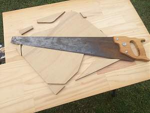

    This is typical of how the pieces are cut

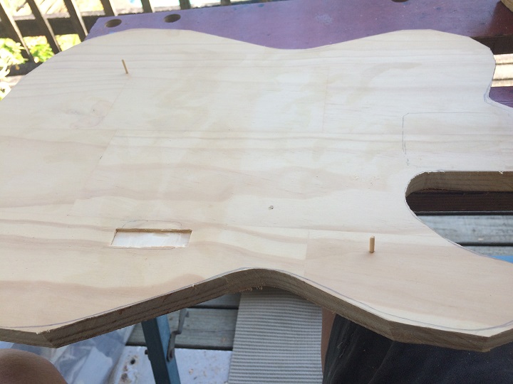

    When all 3 pieces are roughly cut to shape I use 2 small locating pins (made out of a bamboo skewer) so that when clamped together all three pieces will stay in place. This is critical when it comes time to gluing the pieces together.

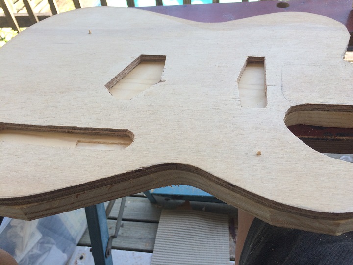

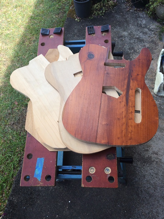

    Here are the back and centre pieces stacked together. You can just make out the bamboo pins poking through ready for the top to be put in place.
    Next step will be to make sure all the internal wiring routing has been done then glue the 3 pieces together and start the final shaping process.
