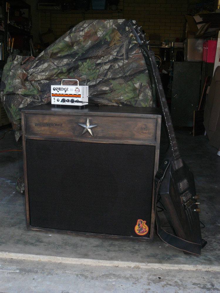

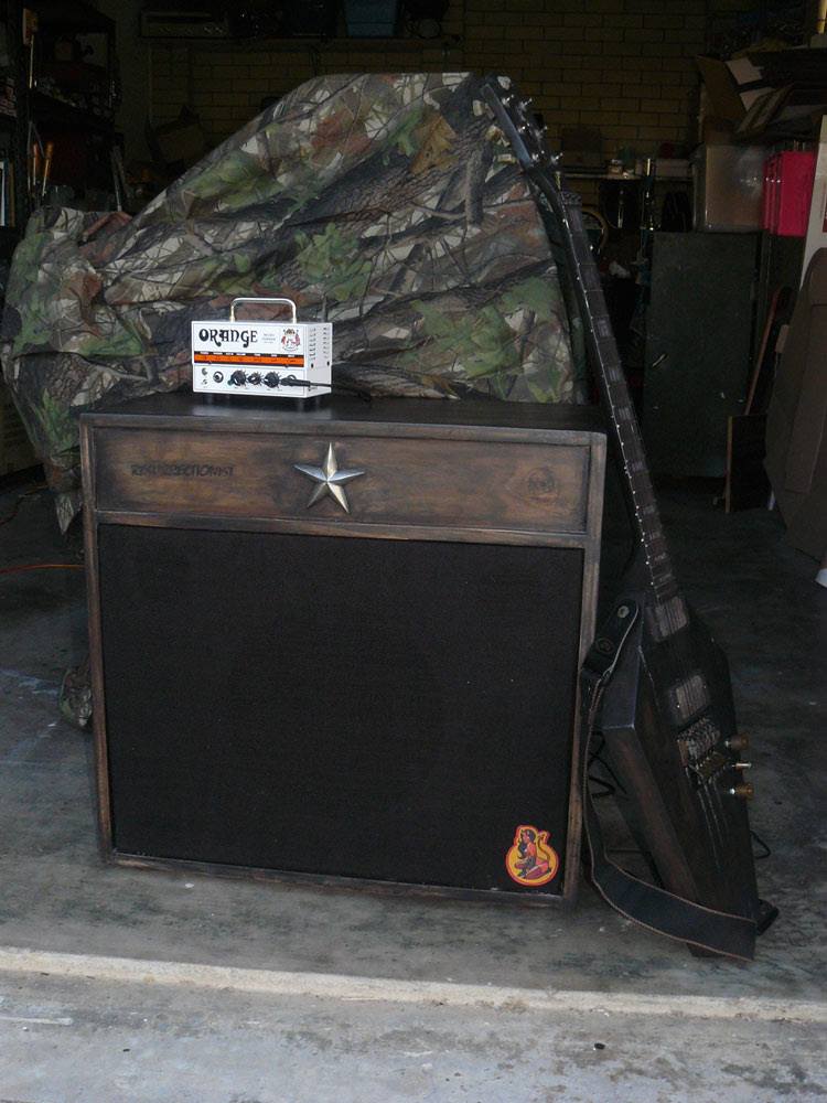

    One of the most absurd rigs I have seen is an Orange Micro Terror sitting on top of a Marshall quad box, sounded surprisingly massive
    Sounds great ( has a single 12 "Jensen in it)
