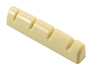

    Would like to know what the "nut" is to measurw from... is it the one at the top of the fret board (truss rod) or am i completely missing the translation... this is my first build i have an RCA 4 kit so any help would be appreciated.
    Hi and welcome.
    The nut is the piece of plastic (in this instance) at the headstock end of the neck with the notches in that the strings sit in.

    The flat side facing the fretboard is the face to measure from when checking scale length. The scale length is defined as twice the distance from the nut to the middle/crown of the 12th fret. So if this distance is 17", the scale length = 2 x 17" = 34".
