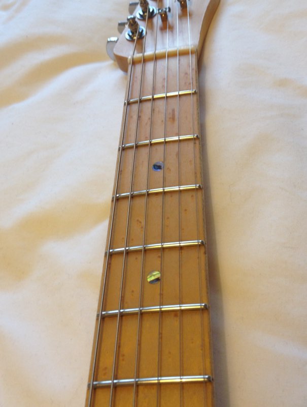

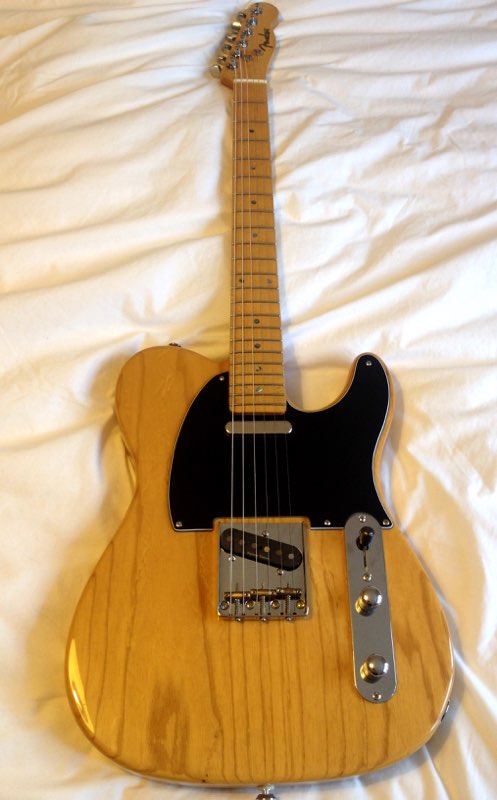

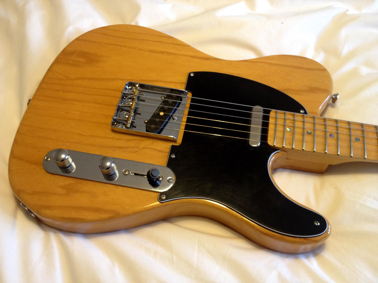

    It's got a solid 1-piece light ash body, 9.5" radius birdseye maple neck with abalone dot markers and a Seymour Duncan Alnico II Pro pickup set (these were standard fitment). The previous owner had rolled the fretboard edges and added an Electrosocket jack plate. They'd also 'fitted' a bone nut - but hadn't filed it down, so the ends poked out the slot. They'd also forgotten to glue it in - which made filing the ends down and polishing it a lot easier!
    All done, sorted and restrung in an hour or so. The action is good, but could be improved, so will wait 'till tomorrow for the neck to settle (as I did tweak the truss rod slightly plus it has the new strings) and then do the final fettling.
    The bridge isn't a standard Fender bridge (and no fender stamp) but has holes in the back edge so that it can be top-strung if wanted, as well as the normal rear-strung method.
    I'm not 100% sold on the abalone dot markers, they don't stand out that well on the maple neck, so may well swap them out for black ones at a later date.
    Tinted clear poly gloss body and an all-over tinted poly satin neck finish. No sign of any fret-wear.
    A web search for these guitars will show that a lot of them had twisty necks. I have seen necks with extreme levels of birdseye present which may well have contributed to this, as straight-grained maple is a lot stiffer than figured maple. Or the wood may simply not have been seasoned long enough. But I'm pleased to say that this neck is fine. It's at least 8 years old, so any problems should have shown themselves by now.
    £399 (which is the general market price for these in the UK on eBay). That's currently about Aus$688 with today's exchange rate. So not cheap, but worth it in my estimation. Sounds just like a Tele should. I'm very happy with it.

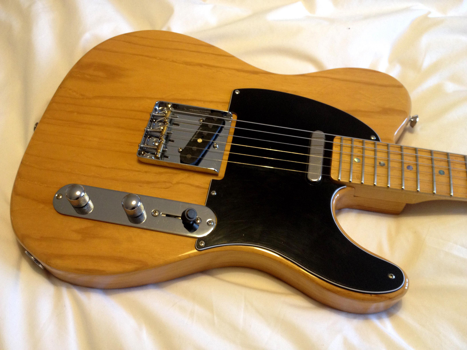

    Here's a slightly better shot of it.
    I did sell off another guitar to a friend before I got this, so I've still only got 23 guitars and basses, not counting the three unfinished PBG kits (one of which is still on its way to the UK after various delays).
    Nice looking guitar, I like the neck pickup against the pick guard, looks neat.
