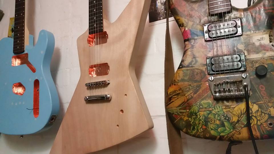

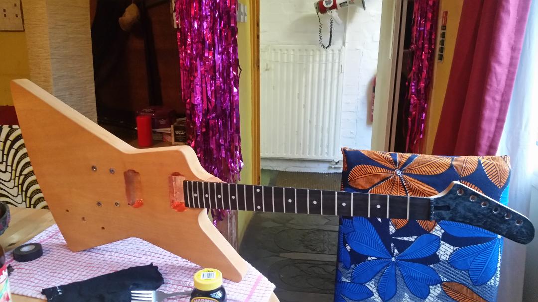

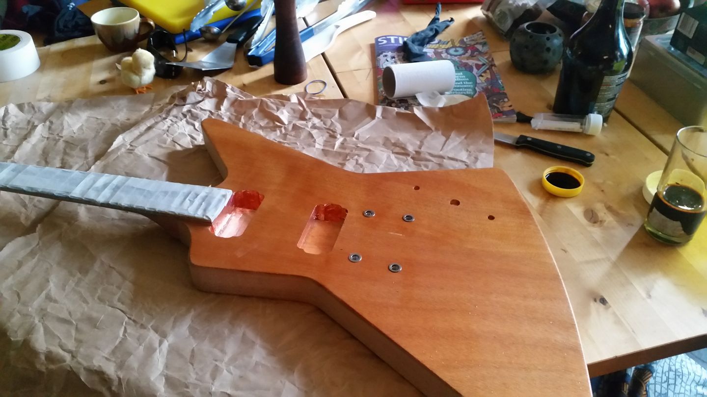

    Have just started an EX build. Not sure where it is going but am going to keep it simple.

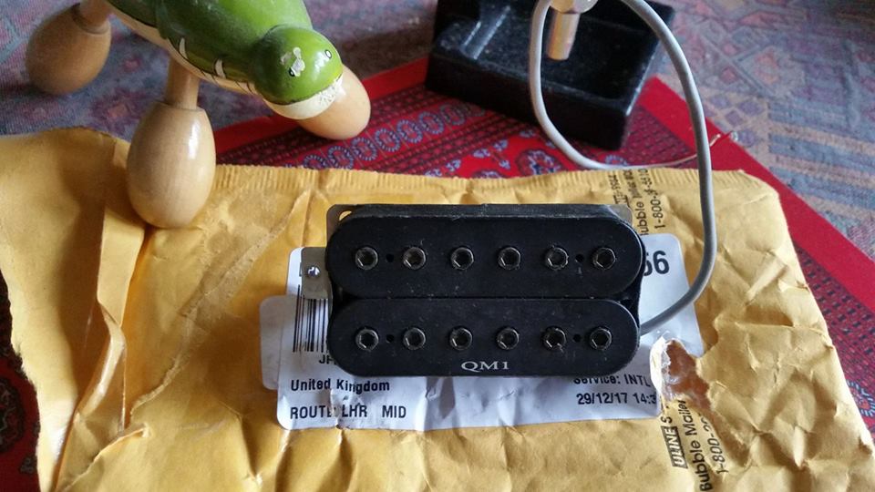

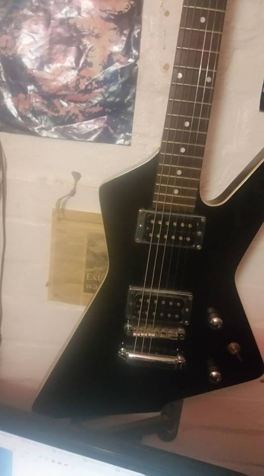

    Ibanez QM1 turned up from the States. QM2 is coming. Was going to put them in my destroyer but am wondering if they would suit this build.
ID:	23986Click image for larger version.
Name:	Ibanez destroyer.jpg
    Mentor Kick's Avatar
    Feb 2017
    Amsterdam, The Netherlands
    823
    I think they will be an improvement. The stock pu's are ok but nothing more than that.

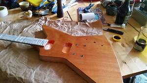

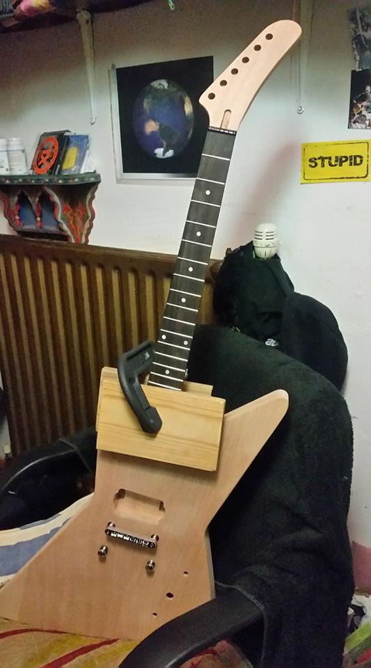

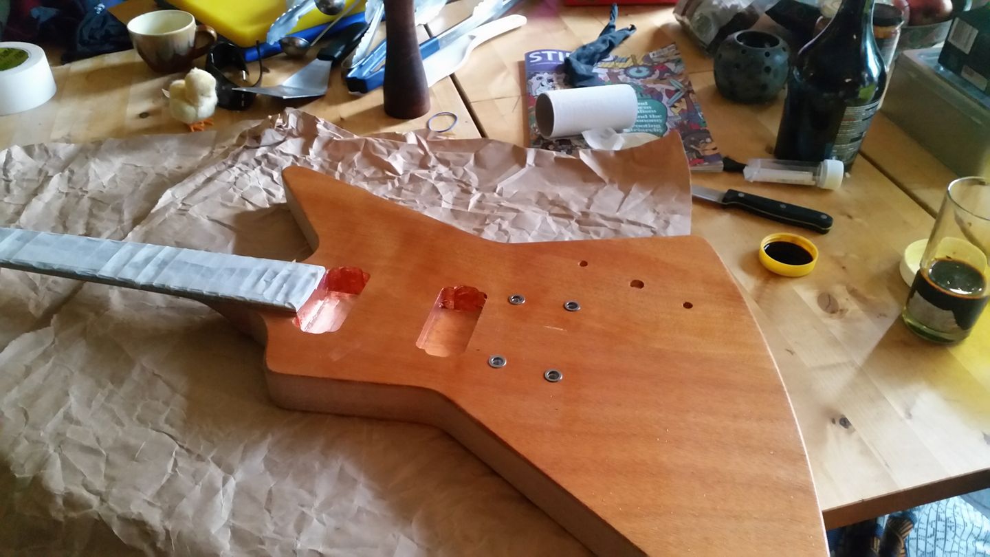

    Well the first coat of stain is on. Is Crimson guitars Amber diluted down 3 parts with water. Doesn't look Amber at all even in the bottle but it is making this look very Gibson Mahogany which is cool enough. One problem I realised as soon as I took the clamp off the neck- I forgot to try the pickup fit and sure enough, it wont fit without cutting a bit off the fingerboard. I measured correctly I think. Set as it is it is 24 and 3 quarters to the middle of the bridge.
ID:	24037Click image for larger version.

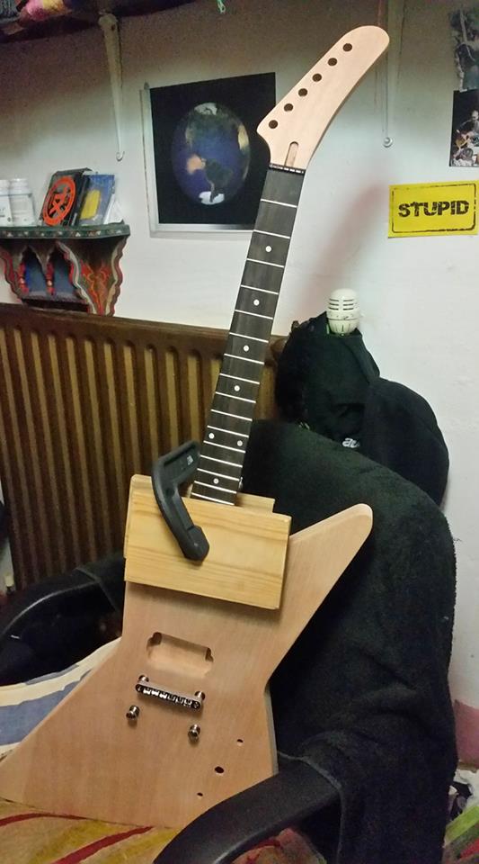

    this is a bit closer. You can see there is obviously no room for the neck pickup surround without cutting the fingerboard down a bit. Unless I am doing something totally wrong?
