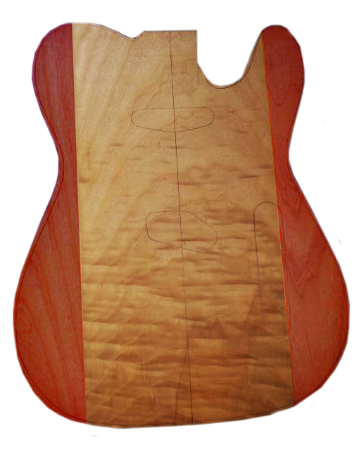

    Just playing with Simon's idea - it's bit rough but it will hopefully give you ideas:
Name:	Quilt Tele 1.png
    Col.
    \m/
  13. Liked by: Bundy1964

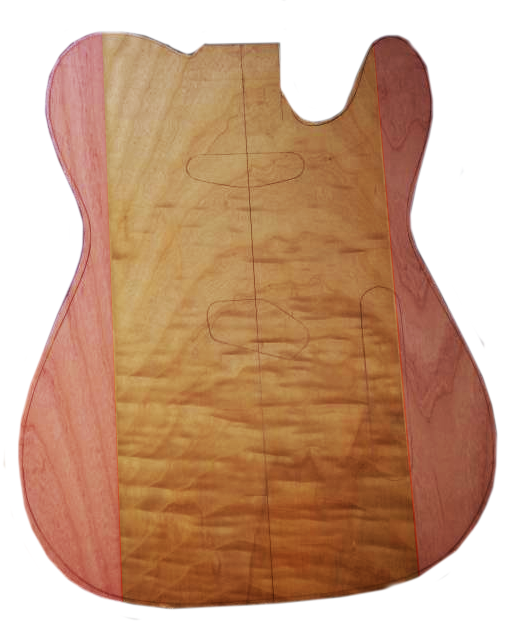

    I'd go even darker on the edges to really pop the central quilt.
  15. Liked by: Bundy1964
  16. #10
    Mentor Rabbitz's Avatar
    Apr 2015
    774
    A bit darker.
    For me it is starting to look more classical than rock. Sort of like some Wal basses look.
Name:	Quilt Tele 2.png
