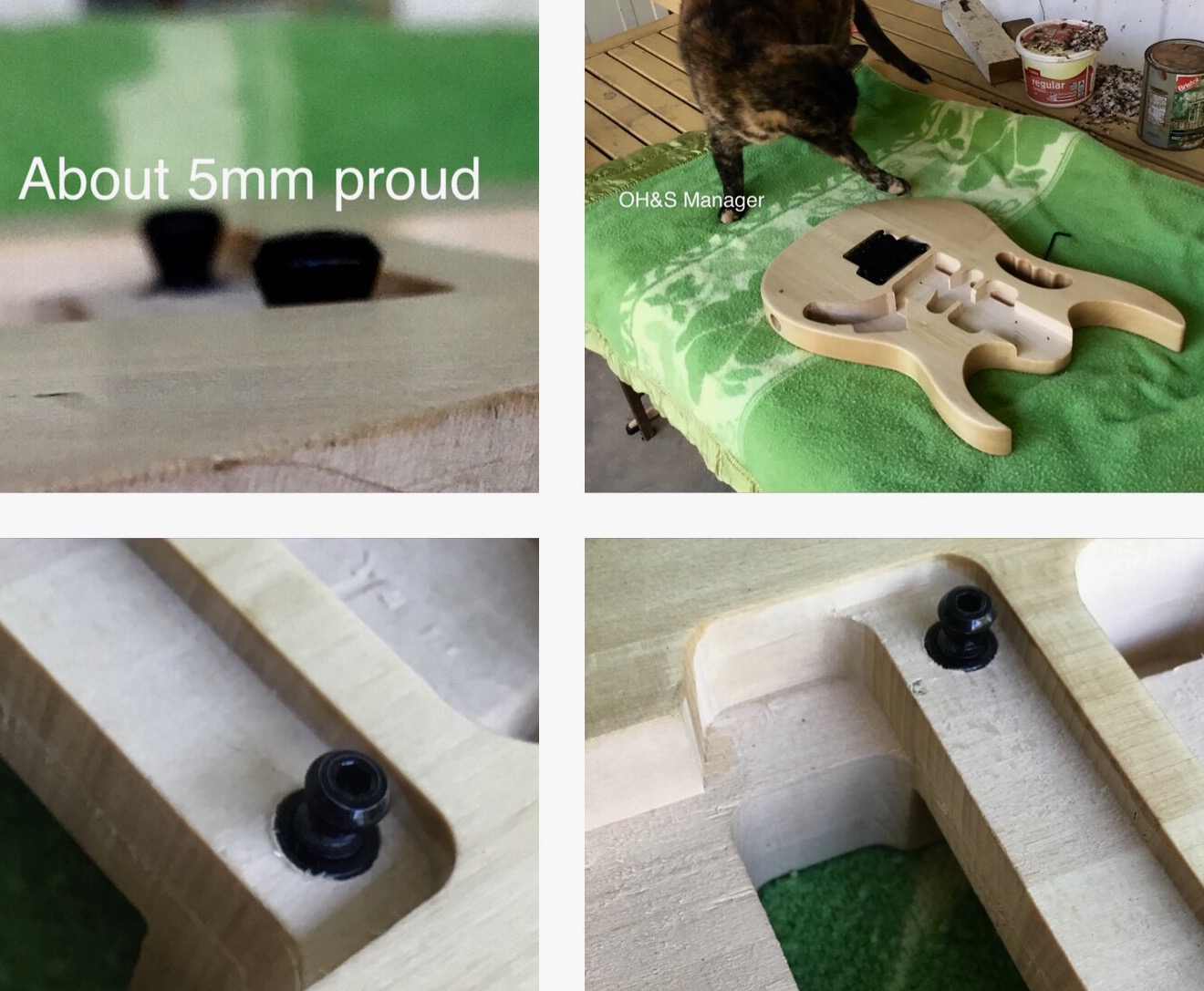

    Hi, am building an SV-1 kit. But I have a question before I go forward please. I have watched the video of mounting the FR and it was said to tap in the mounting posts until level with the top plane of the body.
    I have gone as far as I can go using a dead hammer, the top of the posts are at the top of the routed out area where they fit but the screws are about 5mm proud of the top of the body and are tightly fitting in the posts.
    This means the FR is sitting almost on the routed out area. Yes I realise the screws can adjust the actual height but this was not explained in the video.
    Am trying to attach a few pics so you can see. Hmmm blooming iPad junk. Sorry can't squash the pics on this which is my only connection. I live in a remote area and only have access by this thing until the Neighbourhood House opens in a few weeks.
    So please have I done the right thing with the posts or ?
    Thanks for your advice.
    Doug.

    Here is a pic (finally new software etc) hope it works so you can see.
    Doug

    That's the screw heads sitting about 5mm proud of the top surface and the posts are at the level or the routed out section. Yes that's the OH&S manager checking out things, haha.
    Is this correct or do I need to pull the posts out?
    That's fine. The screw inserts will probably need to be screwed out by a few mm to get the bridge at the right height once it's all set up.
    It's good to ask questions though. Keep doing it!

    Thanks Simon. Greatly appreciated.
    I understand it is the screws that the bridge sits on which gives the height adjustment for the bridge assembly.

    Looks all good to me, it's quite normal for those bridge posts to be like as shown in the photos you've posted.
