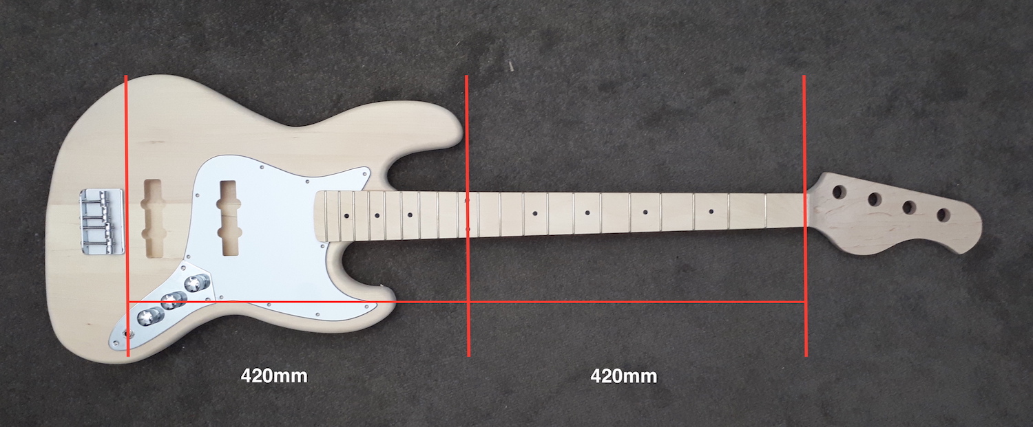

Just need some guidance with the bridge placement on the JB-4M Bass Guitar.
I have come across some other threads explaining the process, but I just wanted to make sure I properly understand the process and know that I'm getting the best placement for this particular guitar.
From what I've read, I should be measuring the space from the nut to the 12th fret and using that same distance from the 12th fret to the bridge placement area. Is it as simple as that? or is there a particular measurement I should be working with when it comes the the JB-4M bass?
Below is a rough outline of what measurements I'm working with.
From looking at a few jazz basses, it seems that the bridge is set back much further, so I'm a little concerned that I might be missing something.
Does anyone have any suggestions?
