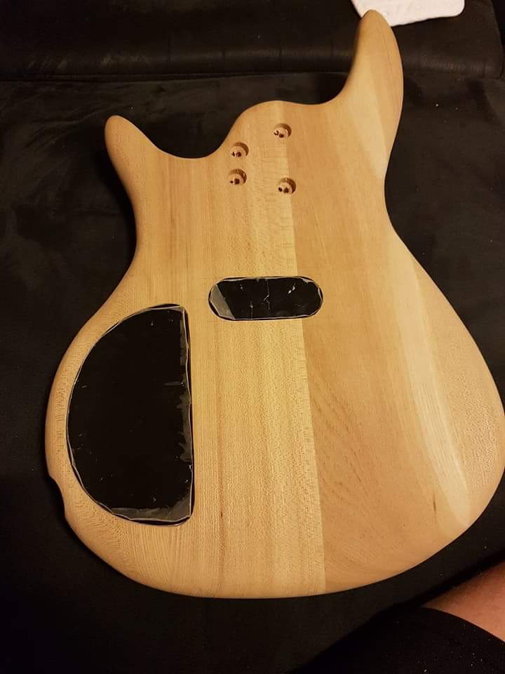

    Finally got a bit of time have a look and jack fits nicely now not fouling on any pots. After much mind changing an measuring i have decided to route a battery compartment and make a cover similar to picture. I will have spare material after cutting new control cover (the one supplied was bevel edged and i think would look of recessed) so hopefully will work out well
    Member Thigg88's Avatar
    Inverell nsw
    55
    Round two with the picture

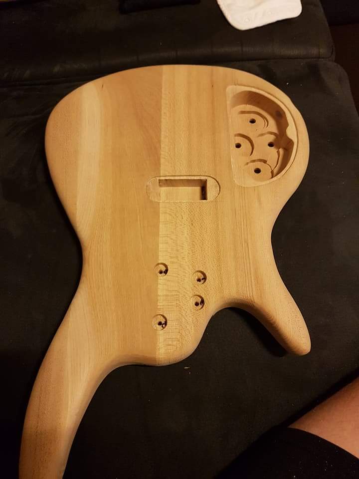

    Finally a bit of progress. Bit the bullet and crossed fingers and toes. Now i have battery compartmentClick image for larger version.

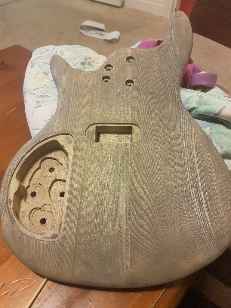

ID:	25277 getting close to sanding time now
    Stained up getting ready to. Hard to get a good photo inside to show the colour.
