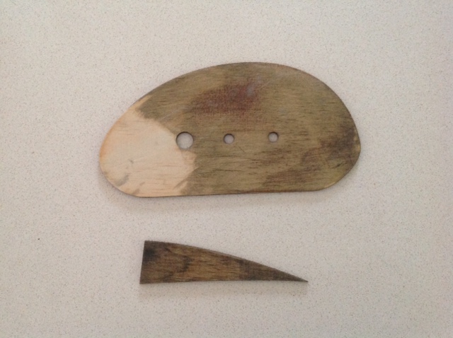

    I used the acrylic parts, but was planning on staining the ply and using them instead originally. When the stain looked crappy I binned the pickup covers, but I have just found the other parts pictured laying on the top shelf under a layer of dust. I also have the original white scratch plate. You can have the lot, either you can paint and badge this truss rod cover or use it as a template to cut one from my scratch plate to match your plate.
    PM me with your address and I'll pop them in the post if you want them.Click image for larger version.

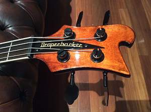

    Here is the acrylic one on my bass, same shape and size...

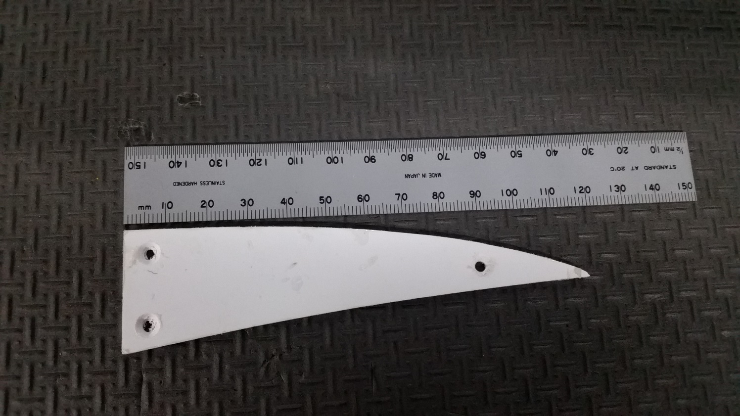

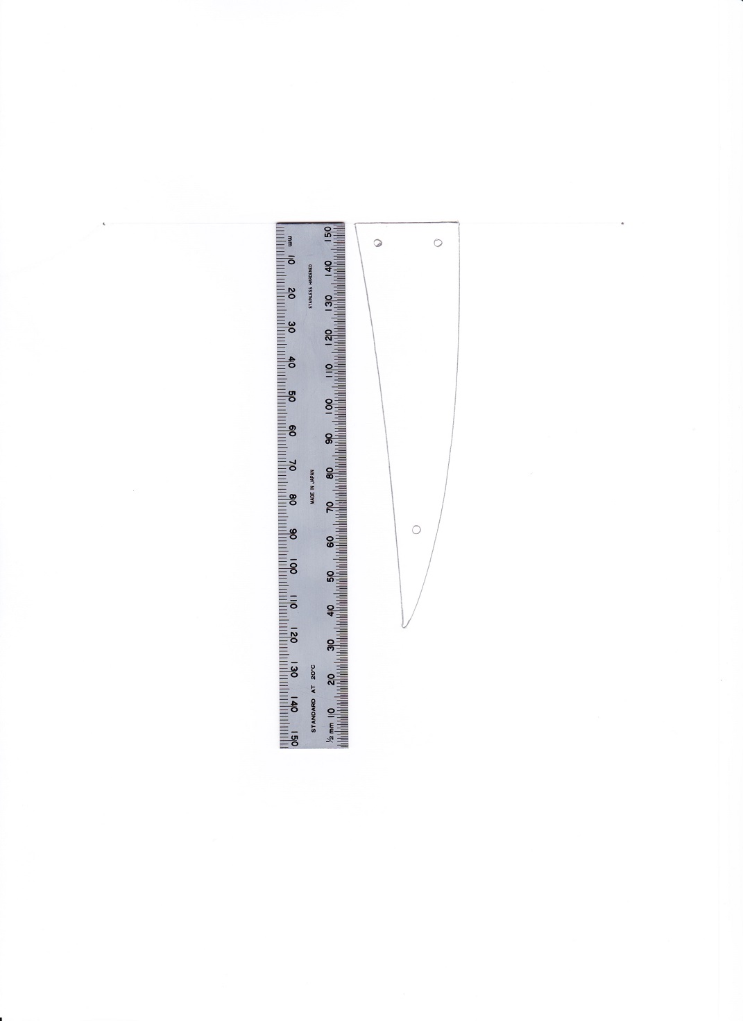

    Hi Jeff
    If you don't take Andyxlh up on his kind offer here are a pic and tracing (with ruler for scale) of my unused trc from a build a couple of years ago. I expect they would still be the same dimensions.
Name:	stock rc4 trc.jpg
