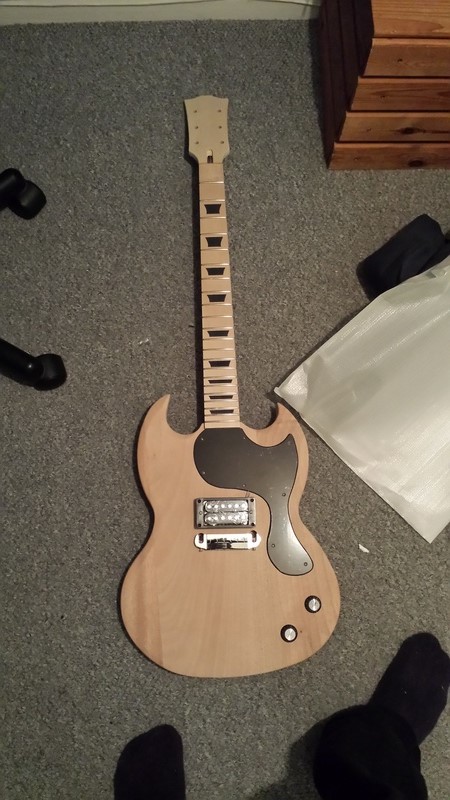

    Hi guys,
    I ordered my kit on the 4th of November and it bloody arrived by the 12th of December, talk about a winner! After some explaining to the wife, the kit was finally in my hands!
    Its an SG Jr with maple neck and maple fretboard, routing for a normal humbucker and the input jack on the side of the guitar, rather than the front.
    I'm hoping to get started on this early in the new year, when I have a little more free time.
    Maple board and trapezoids!! Very cool!
    more Juniors! this looks very promising!
    Nice - whats the plan with it?

    That looks cool!
    nice looking kit IK7 and the maple neck looks cool ! Look forward to see how it turns out
    The plan was originally to go all out on this beauty, however, I have had a lot of time to reflect and I think I'm going to go a single colour for the body and front of the headstock and keep the neck clear. For the humbucker I was thinking a Super Distortion, however, I think I might go something 59, maybe a PAF or PAF plus.
    The bridge wasn't attached when I unwrapped the neck, but it doesn't matter as I'm thinking of replacing it with a bone nut...just a shame I can't get bone in black.
    I'm going to start ordering all my sandpaper in after Christmas, however, I have a couple of questions I'm hoping you guys can help me with:
    1. Is it easier to glue the neck in place first, then paint the whole guitar, or paint the neck and body separate and marry them up?
    2. I'm in the UK, so what clear coat products can I use on the neck and fretboard, I ideally want a glass like finish.
    3. Whats the best location for the upper strap button for the least amount of nosedive?
    Standard strap button position on SG style guitars is behind the neck joint. Whether that is best I can't tell you.
    If the the neck is going to be clear coated, rather than stained/painted, it would be better to finish then glue. Just remember to not finish the areas that will be glued together for a better neck joint.
    I put my strap button behind the neck and it tips the guitar forward a bit too much for my liking. Not a huge issue, but if I were to do it again I'd put it behind the top horn ala...
