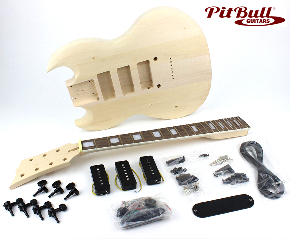

    So, I used the wrong code when ordering a custom kit and this very unique and surprising kit turned up.
    It's a Lefty 7 string with 3 P90's and string through body bridge.
    Definitely one-of-a-kind.

    Make some more mistakes Adam, you are coming up with some good kits.....
  3. Liked by: adam
    Hey Colin when the kit arrives can you please post some pics of the control cavity and let us know if the jack hole is on the side or not ? Looks like only 2 holes for controls but if the cavity is big enough should be able to have a switch, master volume and master tone. Being a 3 pickup axe you need to order a freeway 6 way toggle switch. You might as well order that. Link below
    http://www.stewmac.com/Pickups_and_E...8aAi7hEALw_wcB
    Once we work out the cavity size we can finalise the wiring layout. Hopefully the jack is on the side but you may need to drill a side jack hole, Reading the description sounds like there is no switch hole drilled.
    Pretty cool looking kit by the way thats a good price for a 7 string/3 pup SG !
    The string config is your standard E A D G B E with a low B on top so is usually about 0.55/0.60 gauge
