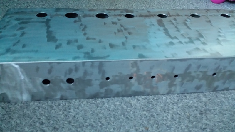

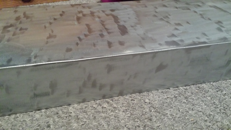

    So today I managed to clean, fold and start drilling the holes in the chassis. There has got to be an easier way to put 28mm holes in mild steel! Still can't decide on what finish, if any to go with.
    Tomorrows task is to position the power transformer and choke, however I'm still waiting on my audio transformer from Italy.

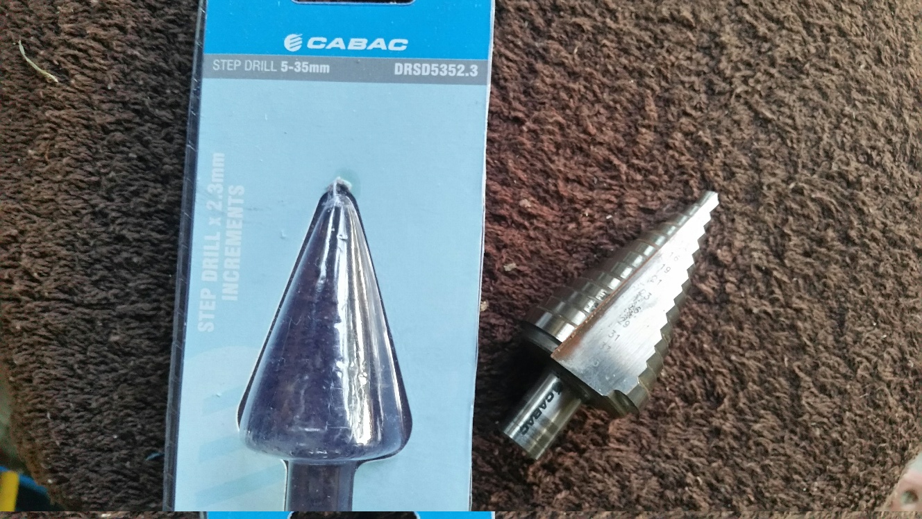

    To get those larger holes I use a step-drill made by Cabac. Available and most good plumber or electrical wholesalers. Only problem is the need for a 13mm or 1/2" chuck on the hand drill to make the buggar turn...
  11. #9
    2,818
    +1 for step drills I have a few in different sizes ( and a bloody big drill press )
