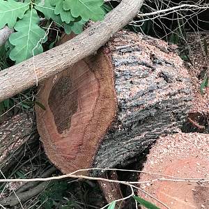

    My landlord has just cut down a Peppermint Tree that was in danger of falling (onto a neighbour's house).
    Can Peppermint be used for guitar bodies?
    I did find some results for "Caps", but nothing on Bodies.
    Here's some info on the species: https://www.stirling.wa.gov.au/Servi...20flexuosa.pdf
    And here's some photos of the former tree:

    You have nothing other than some time and effort to loose if you give it a try...
    Cut the right way virtually any piece of wood could be made into a body, however how it responds to drying out and its eventual weight will be the major issues discovered before you ever find out its tonal contribution...

    Pity he cut it up they way he did, as it always preferable to have any wood used for instrument making quarter sawn, for structural integrity.
    I suppose you could quater saw what bit's are there, but it would depend how long the pieces are on what you could use them for.
    Was it a peppermint gum tree ?

    There are a few longer logs which could be cut with enough length for a Tele, LP or even Strat body.
    Anyway, I might just grab some and put them away in storage to dry out.

    If it's what I think it is, it's going to be pretty dense wood, and looking at the core of one of those log's, possibly as hard as Iron-bark.
    If so, you might be better off cutting the logs quartersawn ASAP, then air drying the more manageable pieces.

    Thanks Tweaky, definitely out of my comfort zone now. Maybe DB or Wokka will see this and come and grab some if they think its usable.
