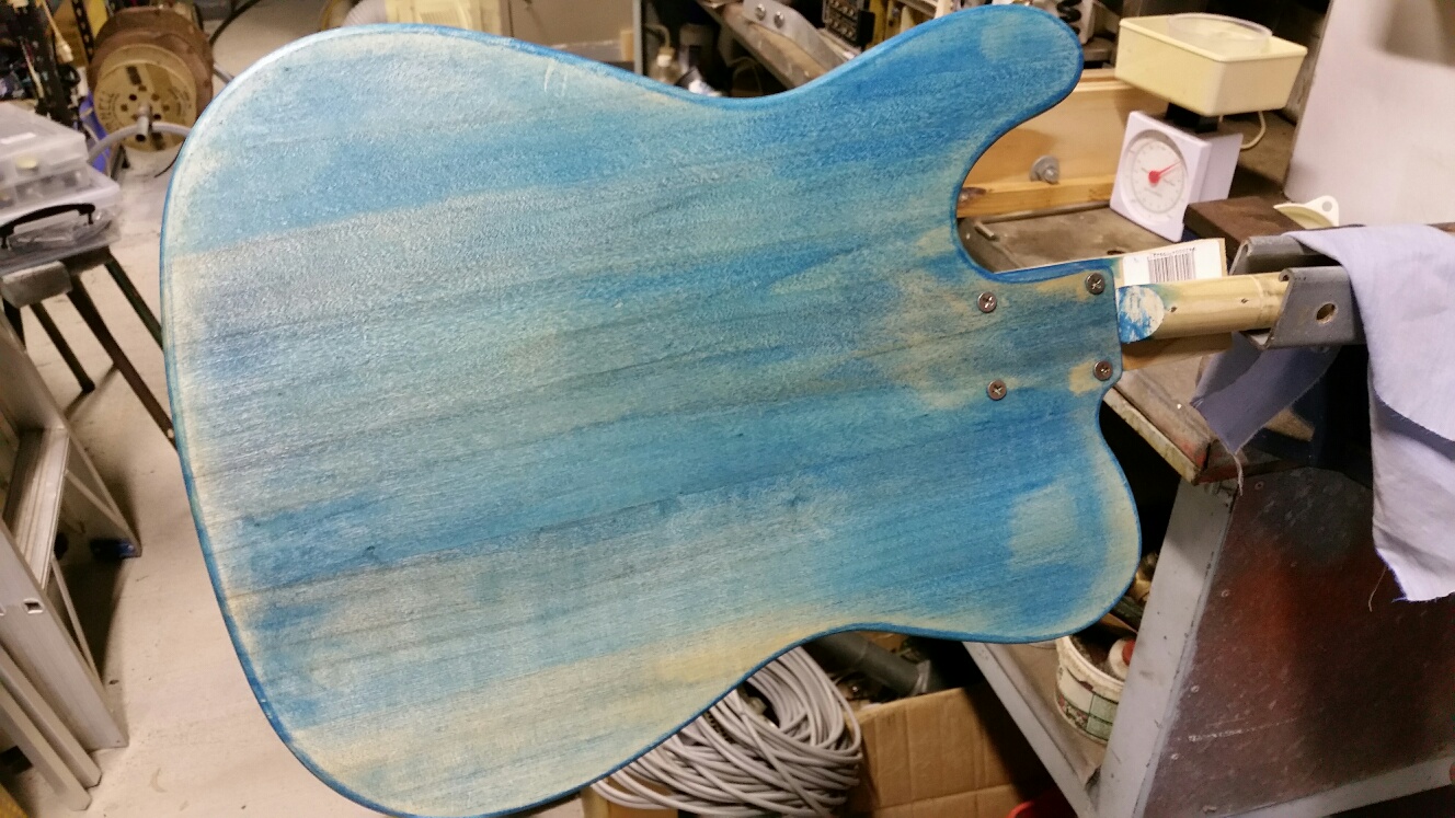

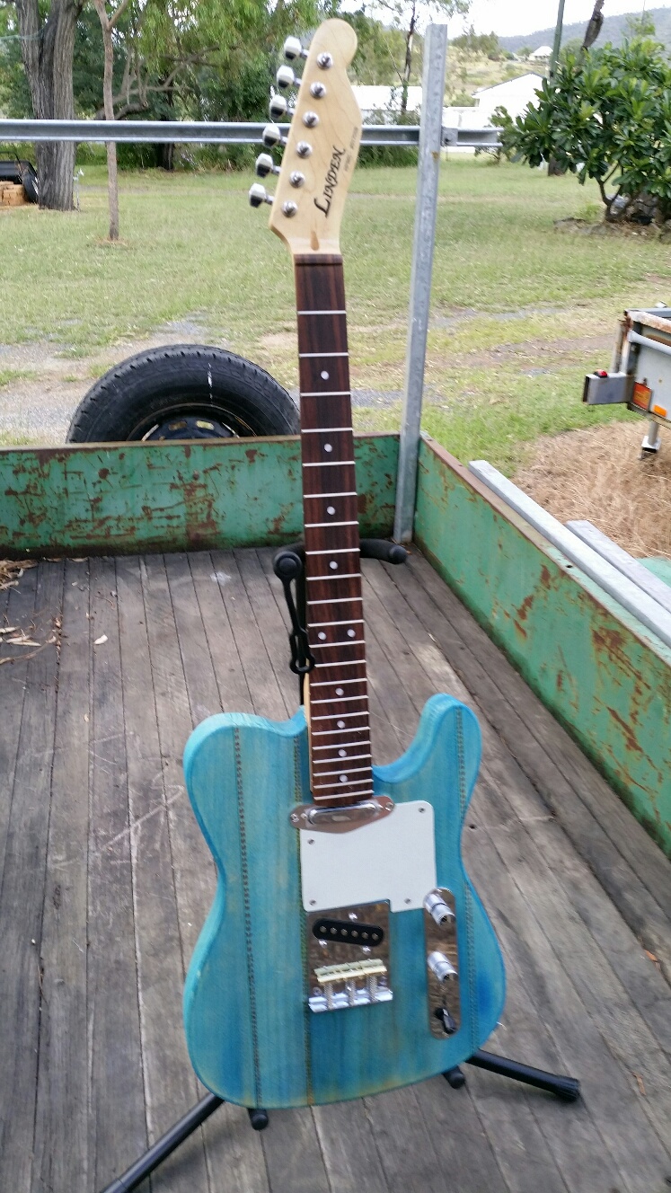

    This is a project I started almost a year ago in the vain hunt for getting myself a Blue guitar.
    It's a parts build, with the sealed Alder body from Ebay, the Kmise neck from China, and a kit bag of basic Tele parts from here at PBG.
    So I stained the body ... and was vastly disappointed with the results. I persevered and assembled it and posted a few pictures on guitar kit builders forums on FB....

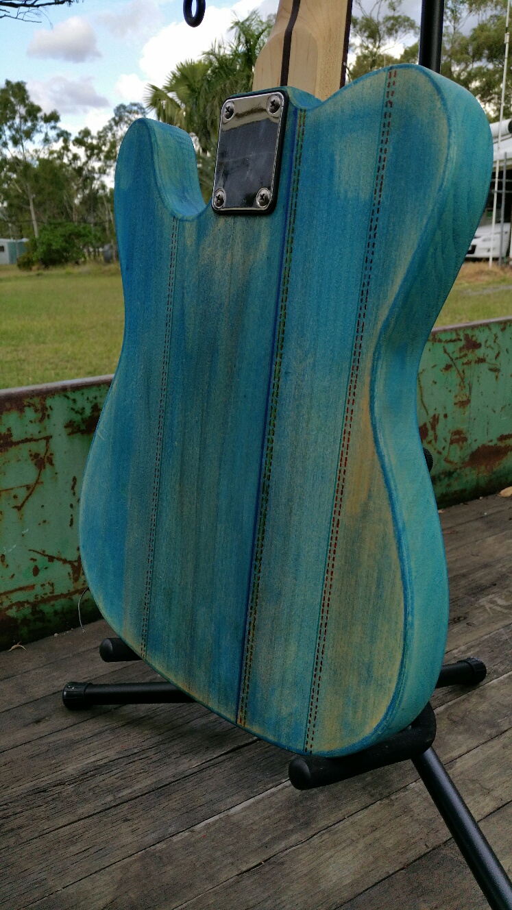

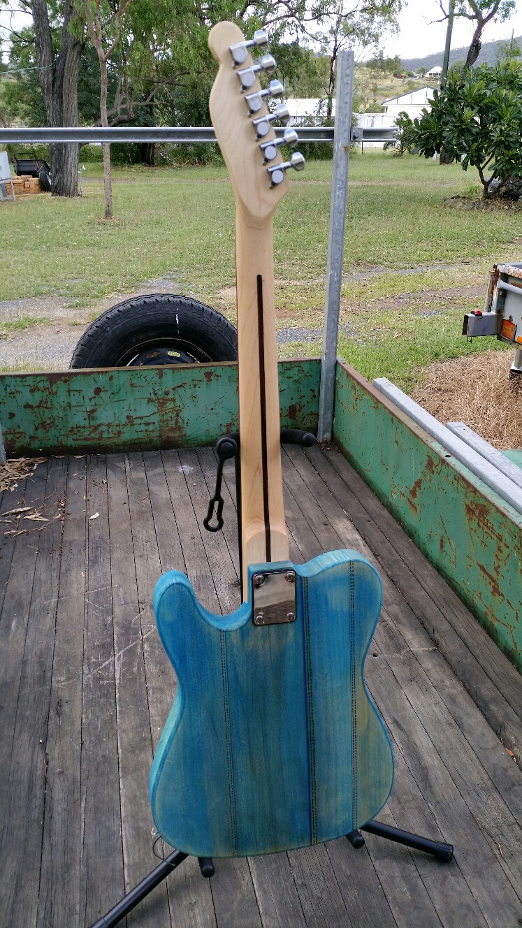

    I got a lot of positive feedback.... Many saying how much the failed Blue stain job looked so much like faded Denim, So I decided to strip it down and use real Denim....

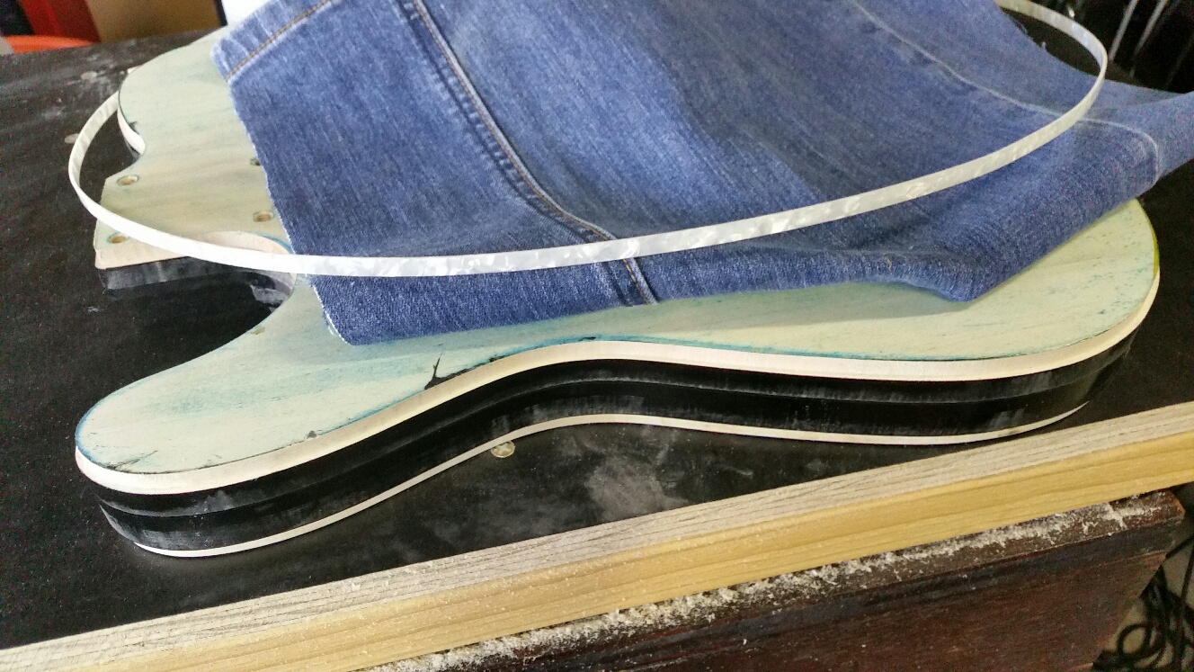

    That's when SWMBO got involved.... She suggested that in reality it should be Denim & Lace, but as we can't have Lace then Pearl would be the next best thing.... one Pearl guard and some Pearl binding ordered..

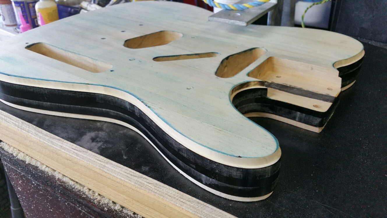

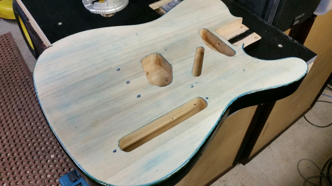

    Completely covering a guitar body in Denim is next to impossible. That meant I needed to find a neat way to finish the Denim edges.,. and Pearl binding seemed the most logical choice.... So I had to build a table so that I could route for the binding... And I needed to sand off the failed Blue dye job so as to not spoild the Denim cover that was about to go on....
ID:	22396   Click image for larger version.
    Mentor Marcel's Avatar
    Apr 2017
    Bouldercombe Qld.
    1,168

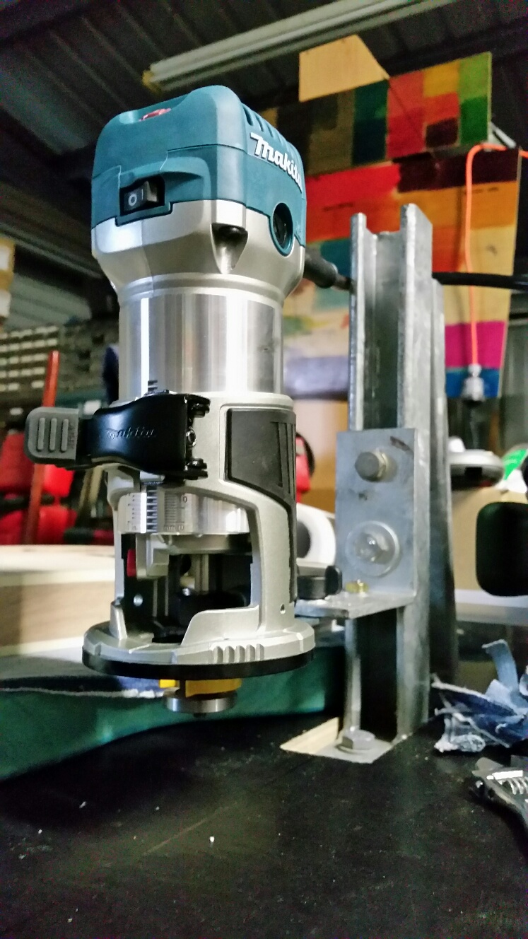

    My rebate bit cuts a 3mm deep channel.... the Binding is 1.3mm thick, and the Denim I am intending to use is 0.5mm thick....I need a shallower rebate cutter...
    I searched high and low and could not find a 1.8mm deep rebate cutter.... None!!... I had all but given up when the young fella at a local bearing shop suggested I sleeve on of my existing bearings..... He explained the process by saying all the bearings on these router cutters are basically the same with just a simple steel sleeve over the outside machined to the size you want. He didn't have steel sleeves but brass works just as good. So I got two brass sleeves and trotted off to a neighbours house whom I knew had a lathe.... After 20mins on the lathe and a couple of beers I had the rebate cutter bearing the exact size I needed....
    I blackened the edges of the Body... I figured Black would be best against the Pearl and Denim..... and cut the channel around the body edge.... The intention is to have the Denim fold over into the channel and have the Pearl binding lay over the top thus creating a neat edge...
    Now to glue it all together.... Bearing in mind that the Denim will remain soft to the touch.... None of this buried in epoxy nonsense....
