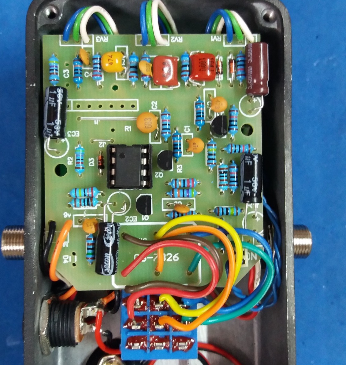

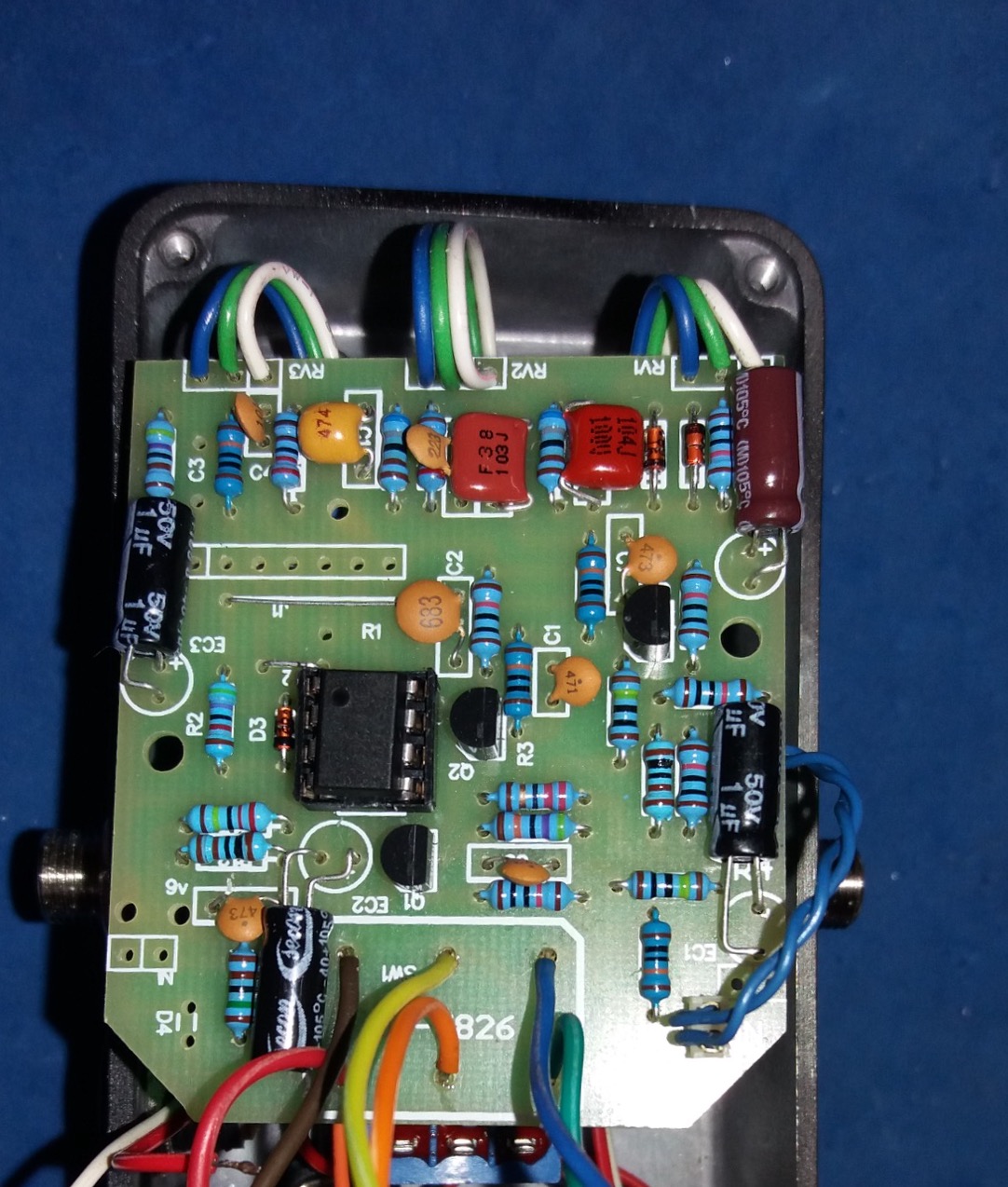

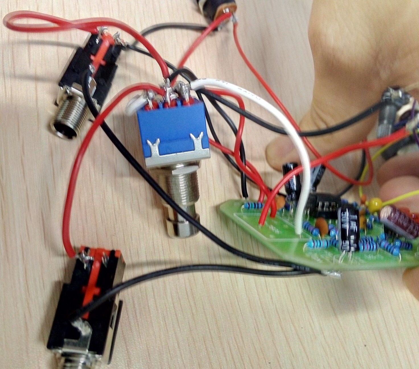

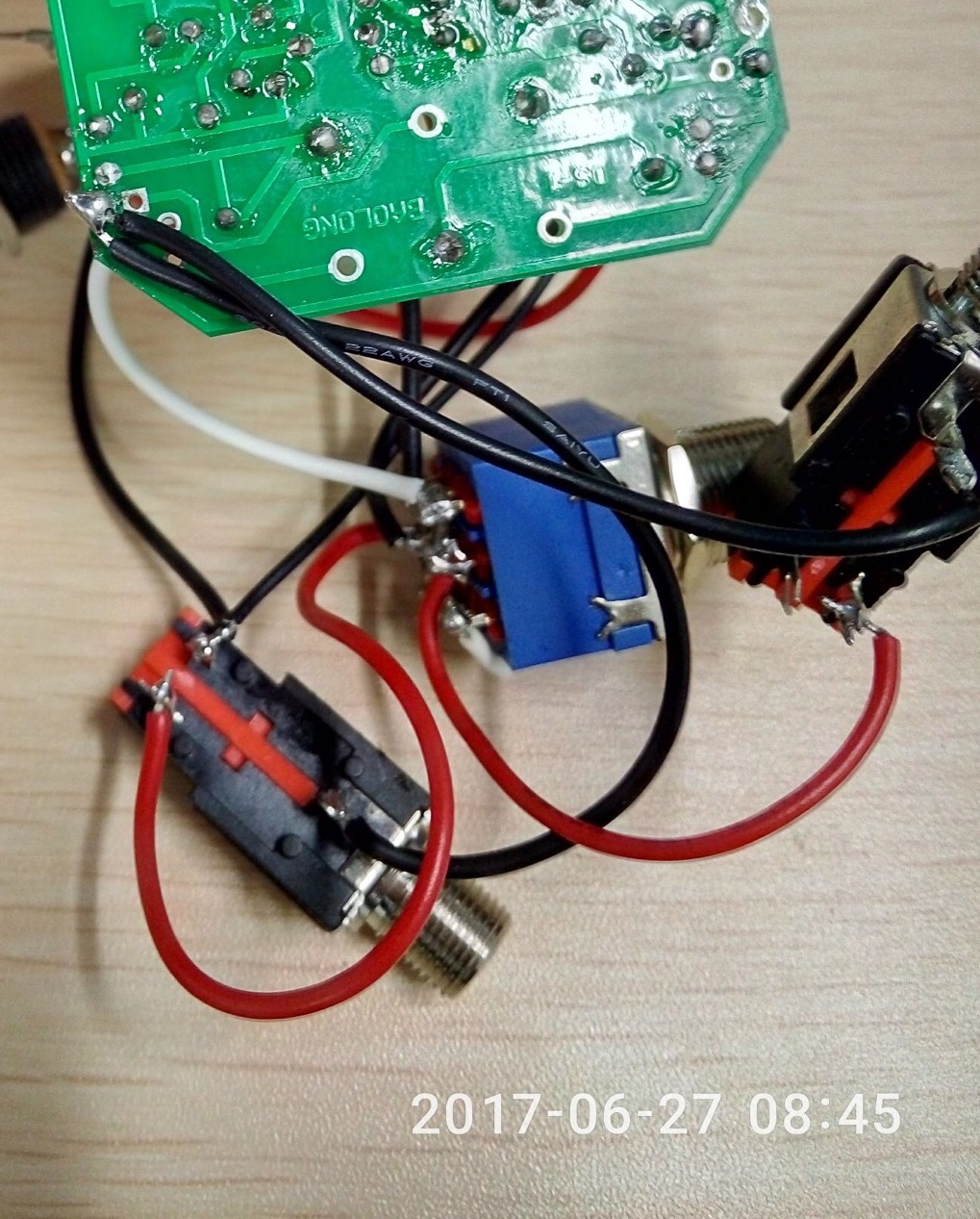

    I found the seller on eBay and decided to buy one. It was only $25 for a distortion pedal kit which obviously came with the components however they could not supply me with an actual diagram, they did however send me 4 images that are supposedly going to tell me exactly what goes where. Feel free to judge on whether or not these images are good enough to easily follow.

    I'd say no, not clearly. The last photo is the only one showing the orange and black wires to the holes above the ones marked 'input', and they then run under the board without showing with any certainty what they connect to. Whilst you can probably assume that RV 1, 2 and 3 run across the box in order, there's nothing to definitively state this, though it should be easy enough to test once built and correct if necessary (if you haven't cut the wires too short).

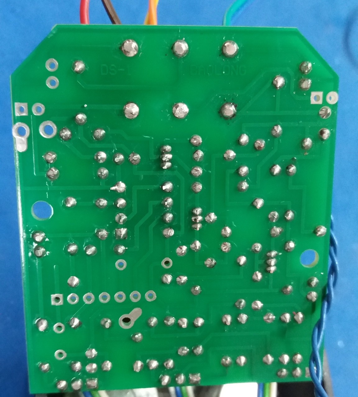

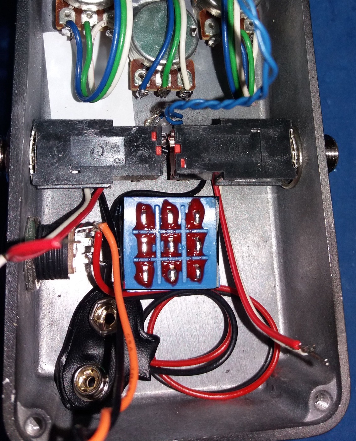

    I ordered from landtone1008 too, Marcel. Other DIY pedal kits that they stock do have actual paper instructions that come with the kit, from what I can see based on the eBay listing my kit doesn't come with paper instructions. I did request instructions and they sent me those 4 images. I'm a complete newbie to all of this DIY pedal stuff let alone DIY guitars so I'll see how my attempt at this goes, and the kit was $25 anyway so if everything goes downhill I haven't lost a fortune in doing so.
