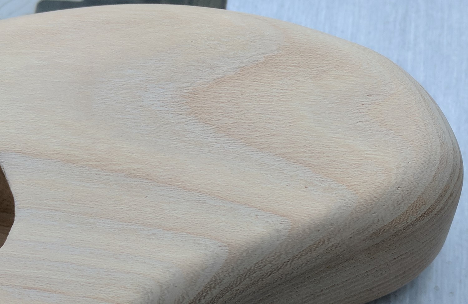

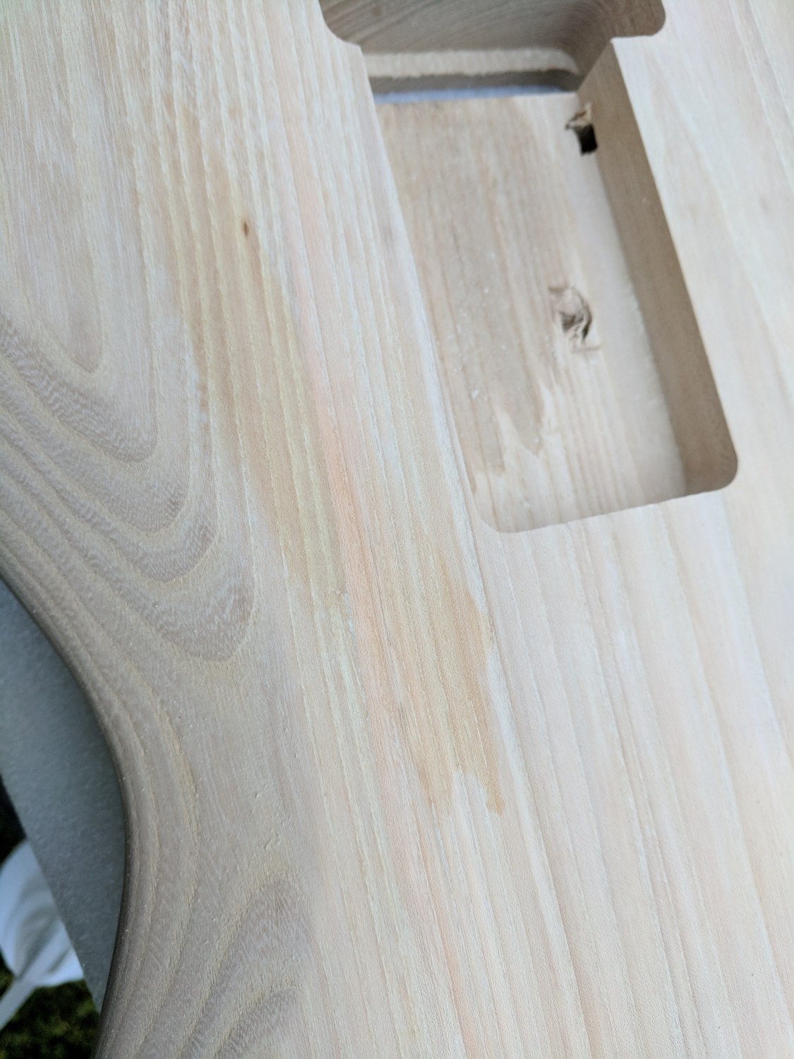

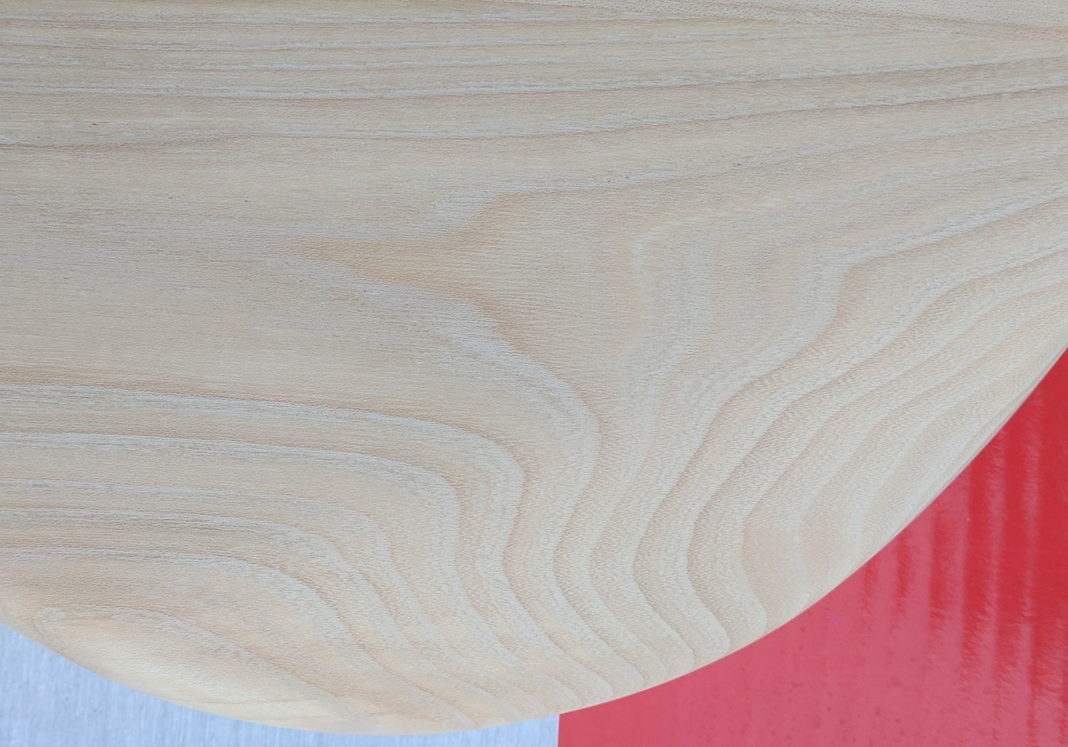

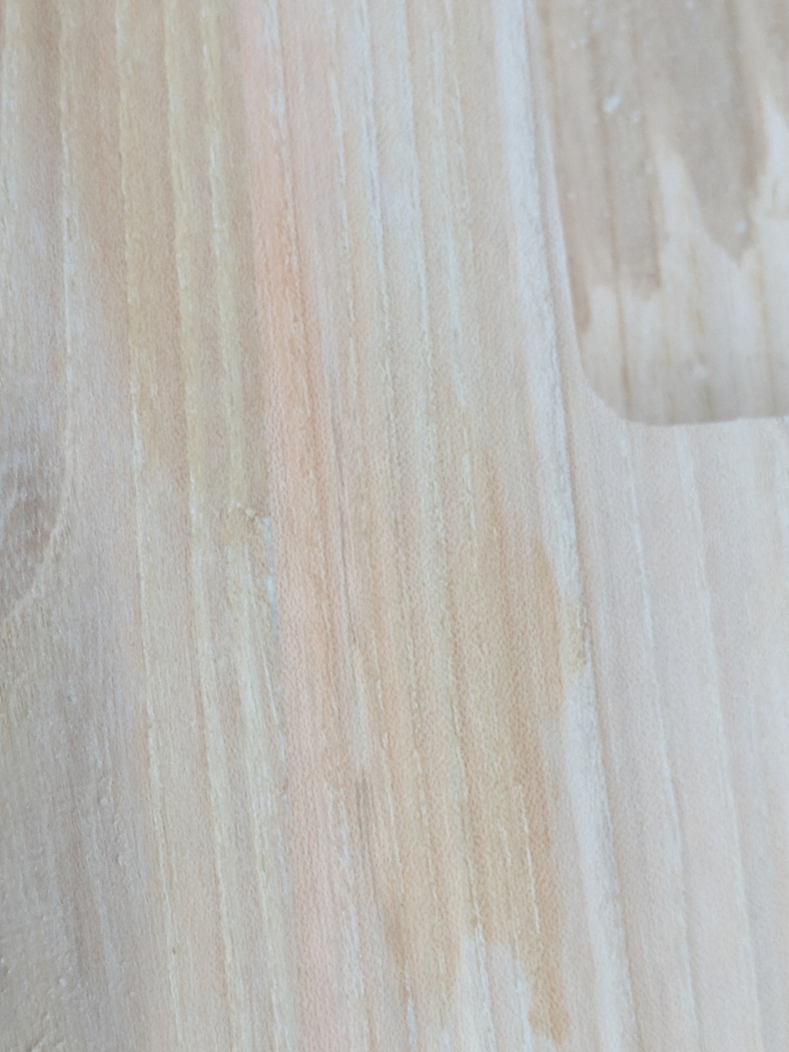

    I tried metho - gave me a strange buzz :-) but had no impact on the orange mark on the guitar body. Not sure about your comment about water.

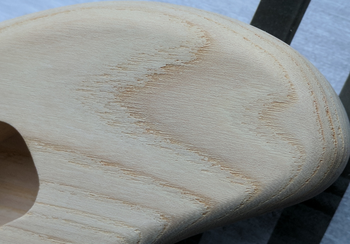

    Attached are some pics taken after "final" sanding. The orange stripe is half way between spring cavity and the body waist. I applied the wet finger test to get an idea of how apparent the stripe would be under a natural finish.

    Hi Raven, Timber Mate seems to be rather stiff in the container and may need a small amount of water added to create a slurry, thicker is better than thin and runny as this stuff can be really, really messy. Best to dig a bit out into a plastic container and then get to work on getting the correct consistency. To apply, an old credit card works best as a scraping tool to spread the slurry all over. Once done leave at least overnight and then take the whole job outside to sand off the excess. Best to wear a dust mask as the residue is quite small and goes everywhere. It also has a plasticky smell too.
    Check out my Red J Bass in the signature below as that may give a few more clues.
    Cheers, Waz
    Pure acetone may help with the orange, but wear gloves and appropriate safety gear. I've used it to remove Dingotone and other stains before. Can we get some more photos of the stain, and any before shots? It's odd.
    Sep 2017
    Melbourne Metro Outer East
    23
    Okay, tried Acetone and that did not remove the orange tinge but did make it look more like it was due to excess glue than marker pen because it was right next to a join and there was some slightly sticky residue left. Think this means the DT Nullarbor Ochre will be the primary finishing option since it seems to hide most underlying colours. (I did an experiment on a piece of American White Ash where I put various light washes based on Feast Watson stains down first to highlight grain then over-coated with DT N Ochre and it seemed to mask all of the lighter washes.)

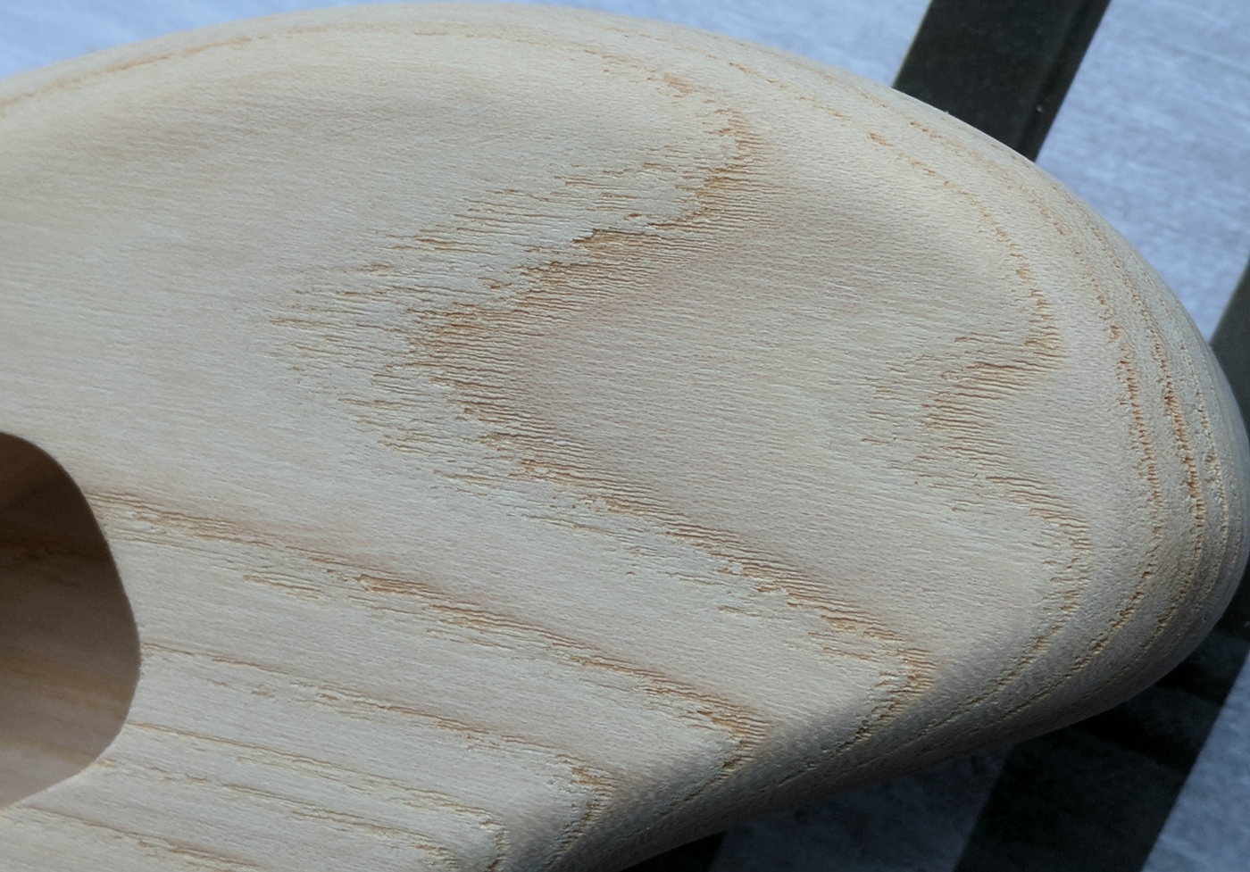

    I used a little air blow gun hooked up to a compressor to blow away all sanding dust as a prelude to applying the DingoTone only to find that some of the grain now looked much rougher because it had been previously filled with sanding dust (I had sanded up to 400 grade). Wondering if I have to go down the filler path (Timbermate etc), or whether the DT 3 coat system will fill the grain either as-is or after another light sand to replace the previous filling.

    Hi Raven, Ash tends to work best with some grain filler otherwise you may end up with grain contour lines in the top coats. Still a good looking effect but if chasing a dipped in glass look better to do some grain filling first.

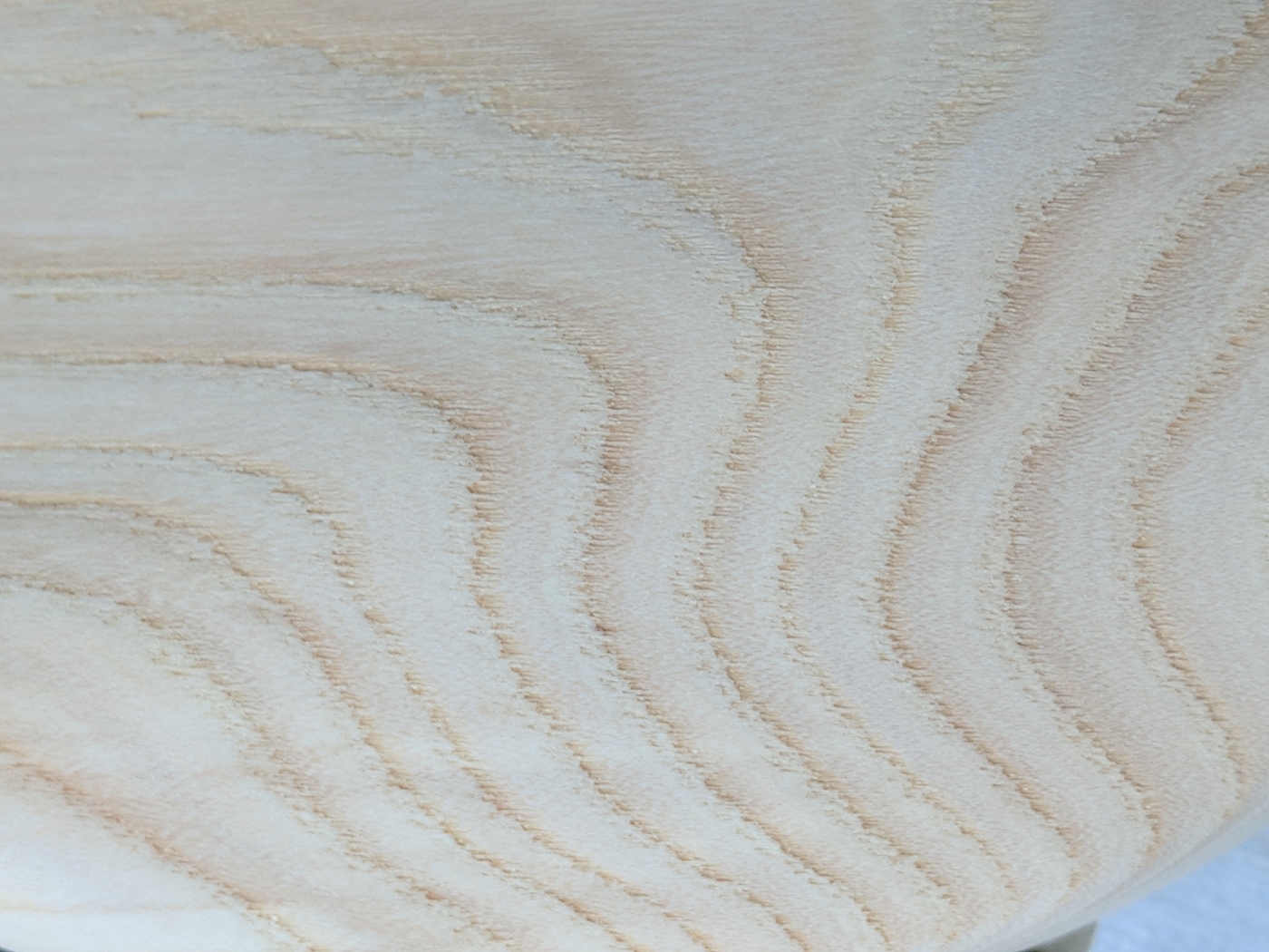

    Grain Filling
    Hi Wazkelly,
    Any suggestions on best TimberMate colour to match the natural Ash grain colouring ?
    (Further to your earlier/previous suggestion I tried some Ebony Timber Mate on a sample piece of Ash timber and found it yielded a blue-black tinge. This might have been okay under a tinted finish but I'm now looking to use DT Nullarbor Ochre - pale red-brown with satin finish.)Click image for larger version.
