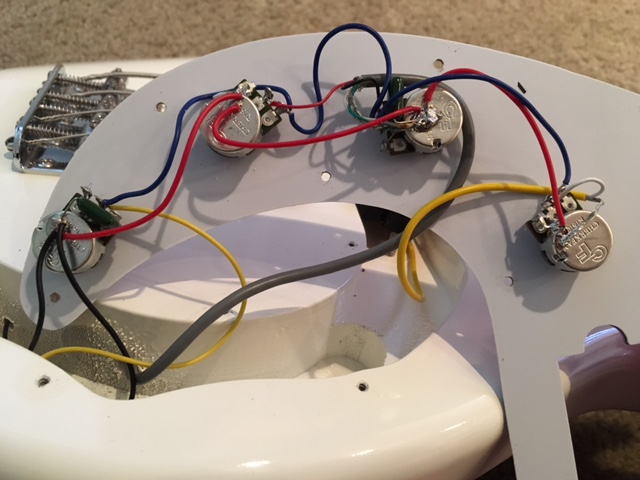

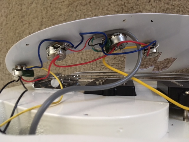

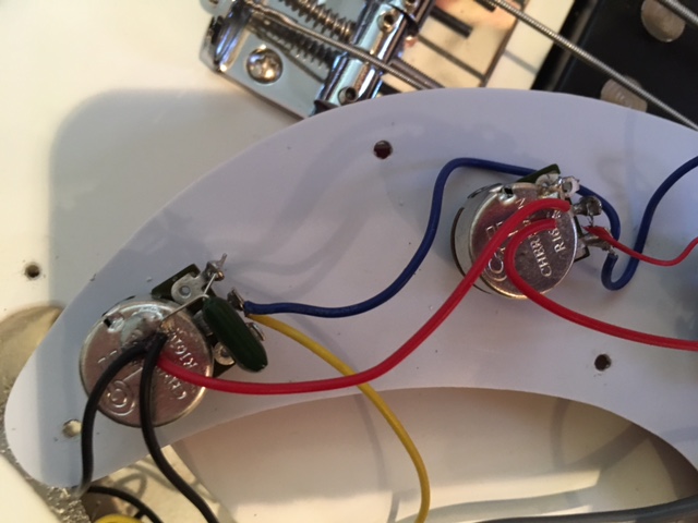

    I have taken some photos of the wiring and hope someone can help.Click image for larger version.

    Not built one of these and suggested wiring diagram can be found via this link... https://www.pitbullguitars.com/wp-co.../PBG-PBH-4.pdf
    Unusual wiring setup where they are suggesting 3 volume & 1 tone with the coils split from the humbucker to a separate volume for each. Your wiring above looks more like 1 volume & 1 tone for each pickup but you have unpaired the humbucker 'red & white' wires and that may be part of the problem. If you want to retain what you have done and stick with 2 x vol & 2 x tone suggest swapping red or white from where they have been soldered with the black from the humbucker and re-solder the red & white together and cover joint with heat shrink or electrical tape as a minimum to prevent shorting out.

    I do already have the wiring diagram for the PBH4 and as you can see it doesn't match the pots that were supplied and pre-wired. I think they have supplied 2 tone pots and 2 volume pots, but the wiring diagram seems to be for 3 volume and 1 tone. I have now disconnected the humbucker wires and re-soldered the red & white back together but still not sure how to wire it given the pots supplied.

    Hi mate, on the pots how many have an 'a' and how many have a 'b' as the a's should be volume and b's tone. If you have 2 of each and want to do the 3 volumes as per suggested wiring diagram make sure the a's are on each of the humbucker coils and use a b as a volume on the split p front pickup. Wouldn't be overly concerned with a log pot as a volume control particularly if don't use them much.
    Hi wazkelly,
    Thanks for your response. Unfortunately due to the solder on the pots for the ground wires I can't see if they are a's or b's. All I can see clearly is they are CF pots, and all 4 do look the same except for the green capacitor fitted on 2 of the pots. Sorry to be nuisance but I thought it would be a simple matter of following the appropriate wiring diagram for this guitar, but unfortunately not.
    Any help is gratefully appreciated.
    Maurie have you removed the pots from the pickguard ? the A or B maybe printed on the underside of the pot.
    Have you followed the PBG PBH-4 wiring diagram ? link below
    don't take wire colours as on the wiring diagram as some wire colours have changed.
    there should only be a green capacitor on the master tone so the pot closest the jack.
    Might be worth starting over with the wiring and follow the PBG wiring diagram.
