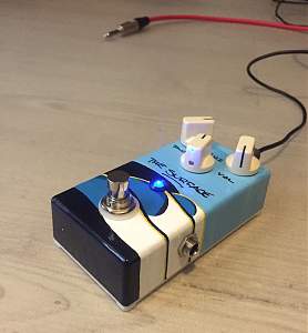

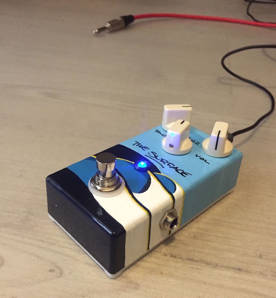

    When I did my fuzz face clone I simply primed the enclosure then my daughter painted it with those little Humbrol enamel tins you use with models. Then posca pen for the writing and a clear coat and it came up well.
