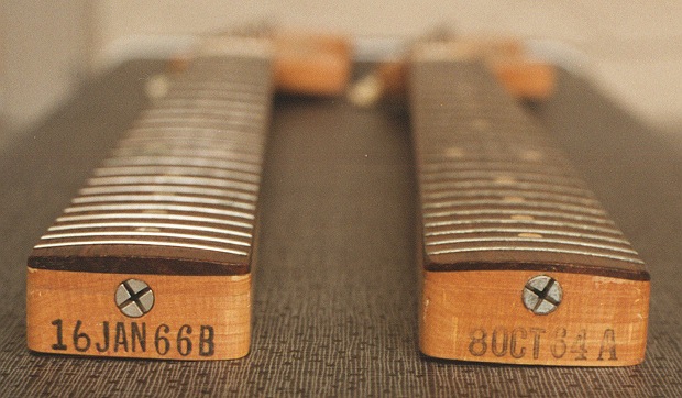

Needs a bit of general tidying up, radius’s on the pick guard are a bit rough and also at the PU end of the fret board.
What are peoples thoughts on the colour variation on the fret board? It feels OK and I’m guessing it’ll even out a bit with oiling - just so long as I’m not inviting dead spots or anything….
The neck fit is quite loose in the pocket, so I guess I’ll need to be careful getting the alignment correct before I bolt it on permanently.
