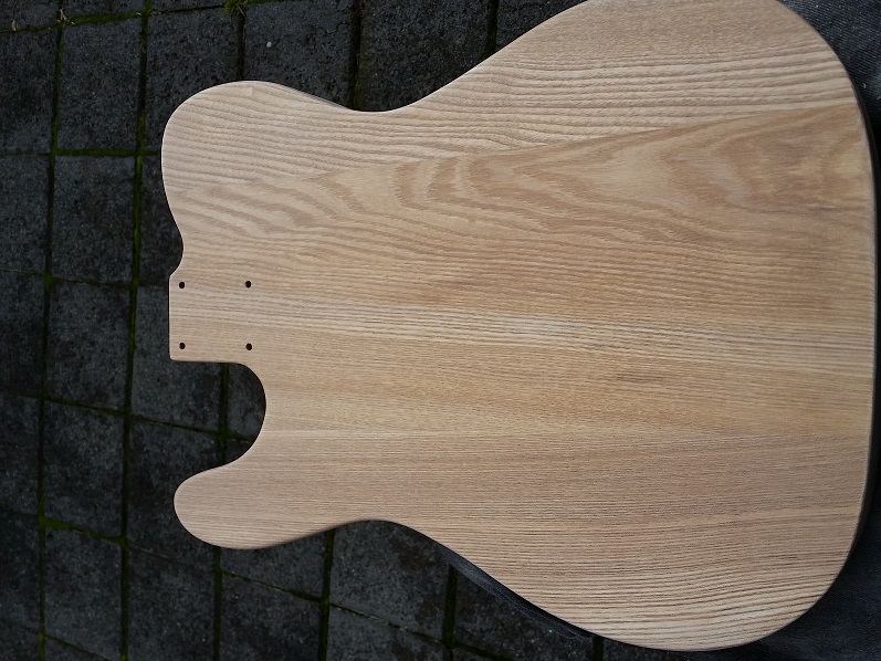

    Just received this bad boy today.
    Can't wait to get started!
    Checked the kit and the boys at Pit Bull have totally lived up the expectation so far.
    First step obviously is sanding.. being a newbie at building guitars, is there any pointers or things i should keep in mind while preparing?
    any help or comments would be greatly appreciated
    Nate

    so is that an ash or alder body ? I know R is for rosewood neck. Get sandpaper of grits 120, 180, 240, 320, 360 should be enough. Sand any deep machine marks and scratches with 120 grit and slowly work through the grits to 320 or 360 grit and wipe off the dust and run your fingers to feel any marks/scratches. Sand with the grain.
    Best of luck

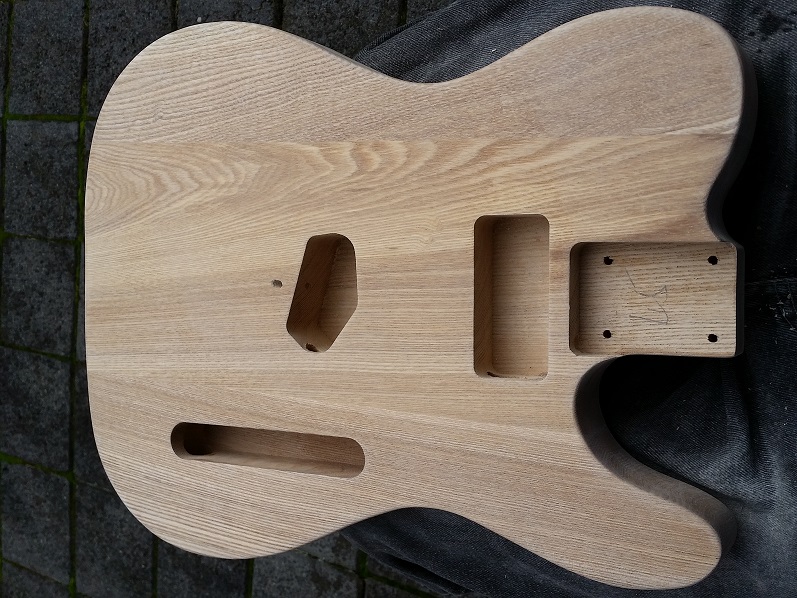

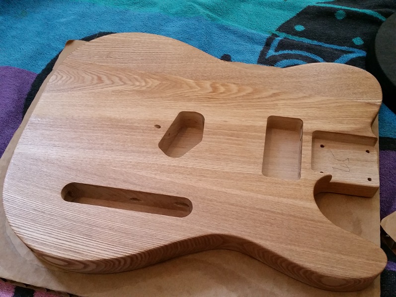

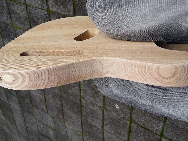

    here is a couple of work in progress shots for anyone interested.
    Just finished sanding with the 180 grit. Prior i had sanded back with the 120 grit and applied a coat of Sanding Seal.
    The last shot is a new coat of the sanding seal on the front side and sides.
    The shot of the side of the body is where i am a little unsure of which direction i should be sanding in.. currently i am sanding with the flow of the dark grains.. but as the topside is running the other direction, should i following that direction instead. :/ ?
