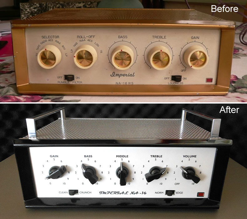

    During the planning of a scratch built tube amp, I came across a 1960’s 16w Japanese mono hi fi amp for $100 on Trade Me. With 3 X 12AX7’s in the front end, a push-pull output stage with 2 X EL84’s and a 6CA4 rectifier tube, it had all the ingredients for a low cost, easy, re-purposing project.
    I retained everything from the old school cathodyne phase inverter to output stage, and configured the two dual triodes in the preamp in a Mesa/Soldano style cascade with a three band tone stack at the end of the chain.
    I configured the first tube as a pair of common cathode preamps; one half for low gain followed by a switchable gain “crunch” stage using the other half of the tube. The gain control site between the two stages. The other tube acts as a further gain stage and a cathode follower buffer for the tone stack.
    Because of the point to point wiring, “tuning” the cathode bypass frequencies, gain and filters by a bit of trial and error to get the tone I wanted was easy. I also placed a switchable filter in the feedback loop from the output transformer to PI as a sort of presence control. I called this one “edge”.
    While not a high gain monster or particularly loud, the little amp makes a good fist of everything from super clean to dirty rock crunch with quite a bit of sustain when wound up. It still has the original NOS EL84’s and rectifier, so has been a bargain to build- less than $250 including new preamp tubes.
    To complement the amp, I knocked up the appropriate era-correct looking 2 X 10” cabinet with a pair of 20W Jensens.
    Pays to trawl the swap meets, garage sales etc.. who knows what may be hiding out there!

    Ha! Sorry about the geek speak..
    It's a work in progress, but currently sounds like a Mesa Boogie Mk II on clean, and a Soldano on crunch when cranked.
    It still needs a bit more low mid balls, and when I've sorted it, will post some sound bites.

    It's surprising what you can do with these old Tube Monoblock Amplifiers, when I first got introduced to the internet (around the early 90's) I used to do lots of searching for guitar amp schematics and I noticed that there were lots of forums geared towards modding Tube Hi Fi amps into guitar amps, lots of great info, I'm pretty sure that a lot of those forums are still going.
    Yep, some of the old stuff was great for experimentation.. Back in the late 70's I built my first tube guitar amp out of an old PYE sterogram chassis. Was a bit like a Fender Bassman in it's simplicity, but driving two separate 8W single ended output stages to individual speakers. The output tubes were 807's I think... Sounded so cool with my Roland BEEGEE fuzz box.
