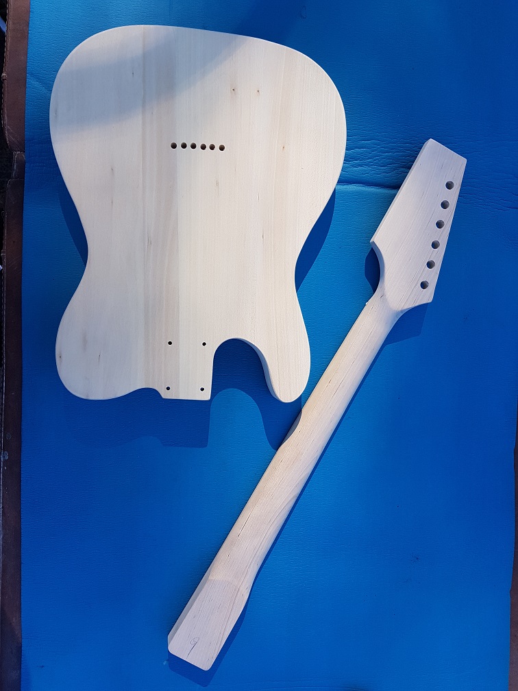

    After jumping in and ordering the Tl1 Custom order that went wrong last month, finally get a chance to unbox and have a look. Was a birthday present so only got hold of it on Tuesday.

    Mocking it up, the body is really clean no dings or marks that I can see at the moment,

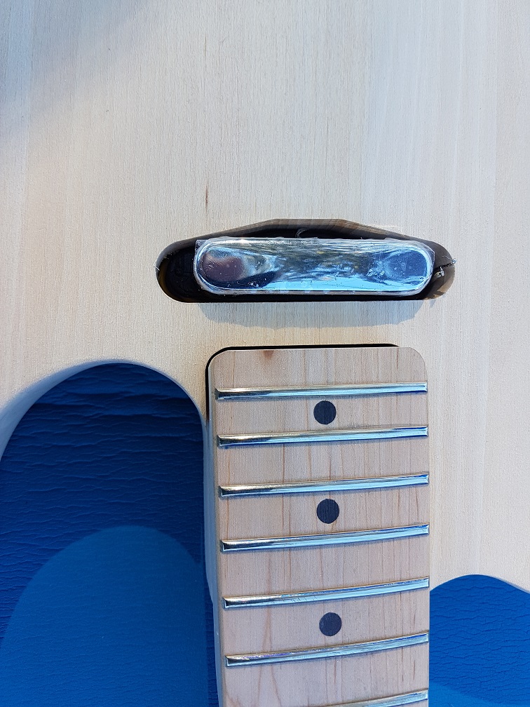

    Only concern is the neck pocket. haven't done a bolt on kit before but it does seem a bit lose, going to be a gap that needs filled. Normal?
    This will be a slow one, got the Srat on the go which will be a bit of a test bed for my painting skills before I tackle this one, also plan on a lot of fender hardware which I will be buying piece by piece.

    I used some copper shielding tape to tighten the neck pocket on the Strat build, worked a treat
    interesting, you have to build up layers, or did one do it for you? Sounds like some experimenting will be required.

    Visually, the pickguard should hide any gap - unless the pickguard and the end of the neck don't have the same shape.

    Quote Originally Posted by Rossc0 View Post
    A couple of layers on each side gave a very firm fit, a case of add as required
