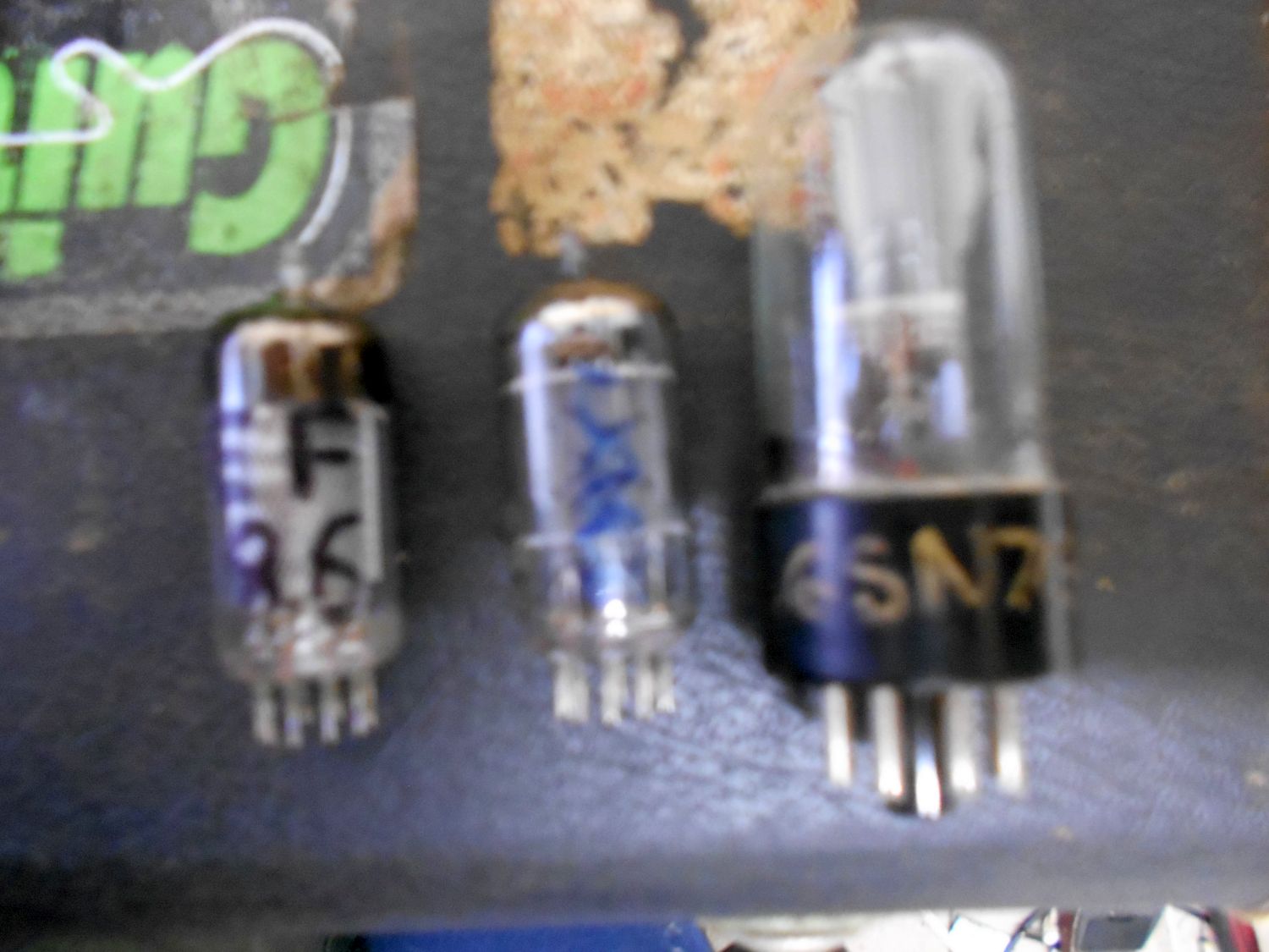

    Made a bit more progress on my Moonlight Amp build, I was just having a look through one of the cupboards in my bedroom and found a small white cardboard box with some valves in it, in the box were some assorted valves including all the ones I will be needing to build the Moonlight Amp, here's a pic of them:
Name:	Moonlight Amp Valves_resized.jpg
    Sorry for the image-quality, it's the best I can do at the moment, anyway, on the far left is the EF86 Valve, in the middle is the 12AX7, and on the right is the 6SN7GT (I happen to have two of these, from memory they were originally Trigon branded).
