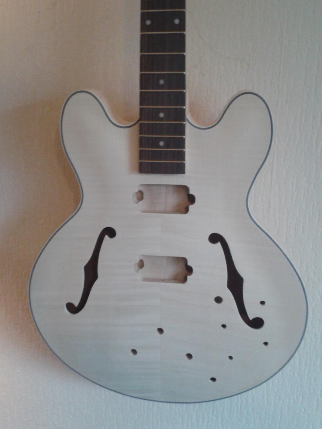

    in my case the veneer is pretty much spot on (measured at a couple of locations) the problem was.. when i put the neck in and put a known straight along the sides of the neck they would not be centered on the holes for the bridge.. i did read another thread where the bridge holes were off but that isn't the case for me (luckily) so i must conclude the neck was slightly off straight.

    Also there's another alignment issue where when i mount the neck and put a straight edge on top of the frets it will stick out over the bridge by about 3 cm.. the neck also had quite a bit of back bow to it but that was fixed mostly with the truss rod.. i plan on fixing that alignment issue when the thing is finnished so i can mount the bridge and measure more accurately.. basically i'll just file and sand the heel of the neck untill it sits where i need it to.. then sand off any finish on the neck that could get in the way of the glue in the neck joint and stick it all together. atm i'm not sure what finish to use on the neck but i'm thinking that can be done after i mount it, the body is going to get a laquer that will get done before i mount the neck.

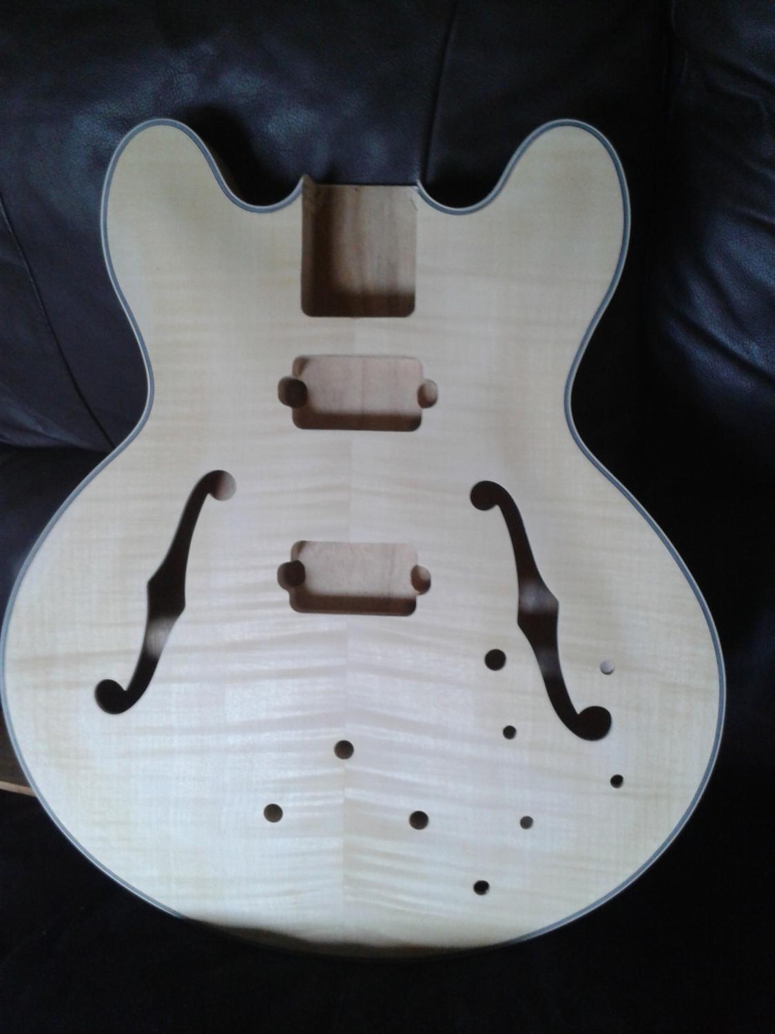

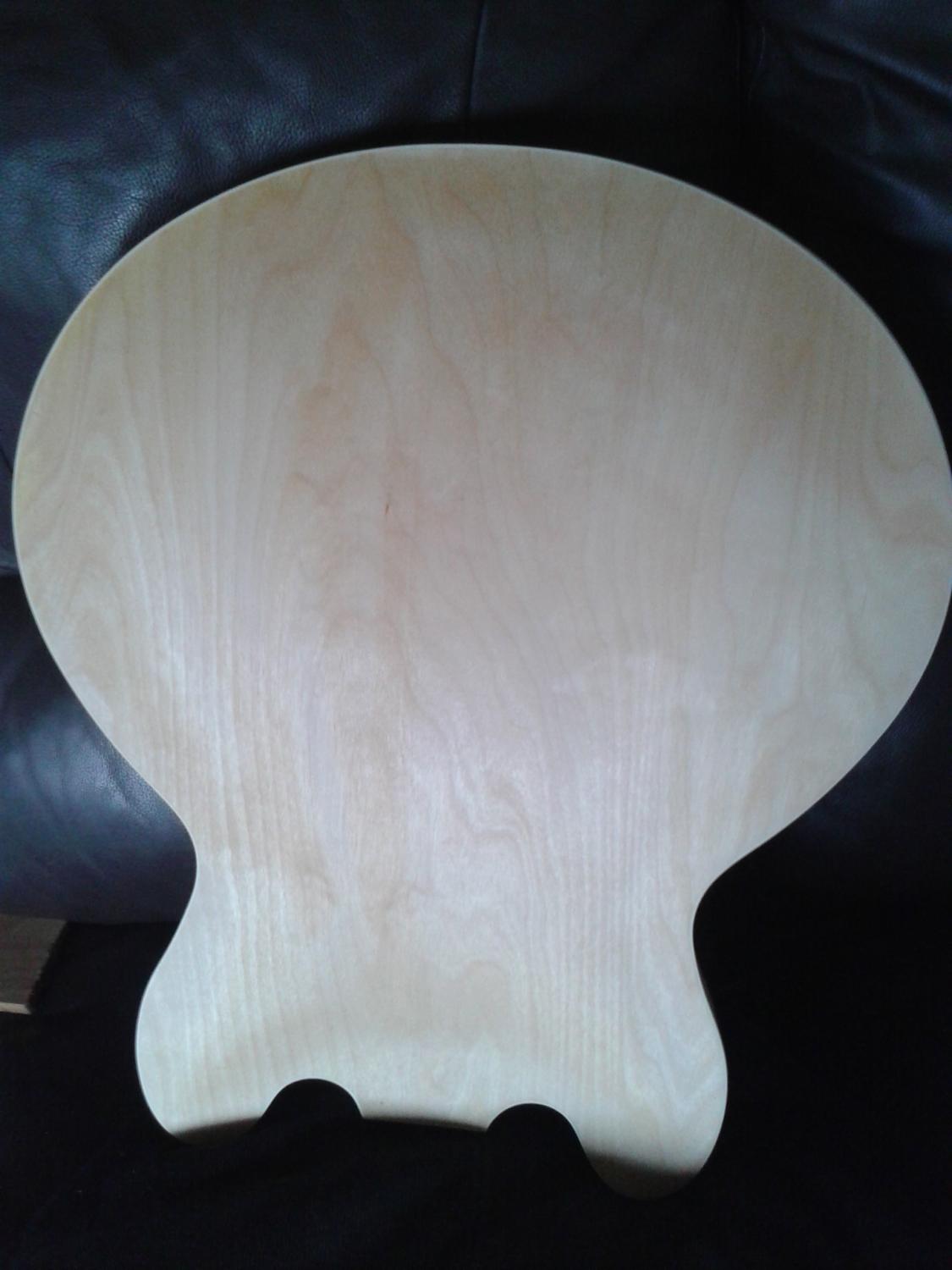

    I did just check for glue spots (thanks for that suggestion) but i think i'm good.. here's some pics of the body with the spirits on..

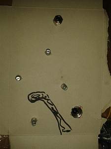

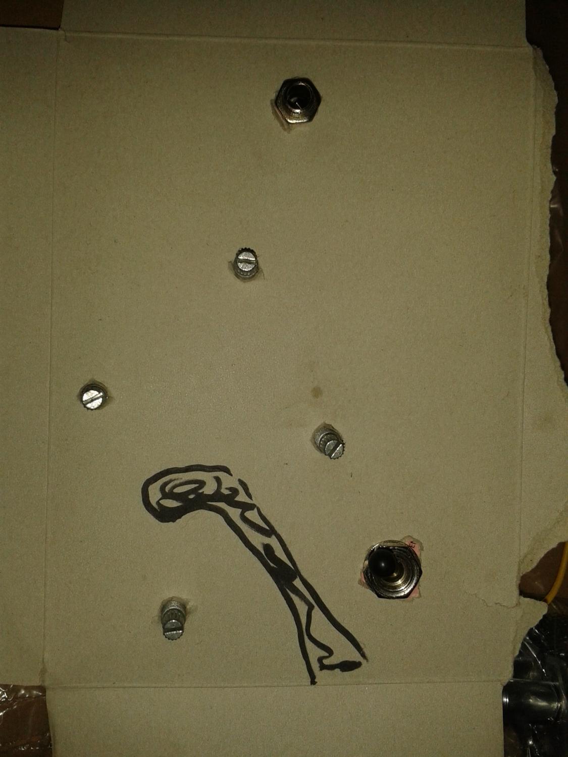

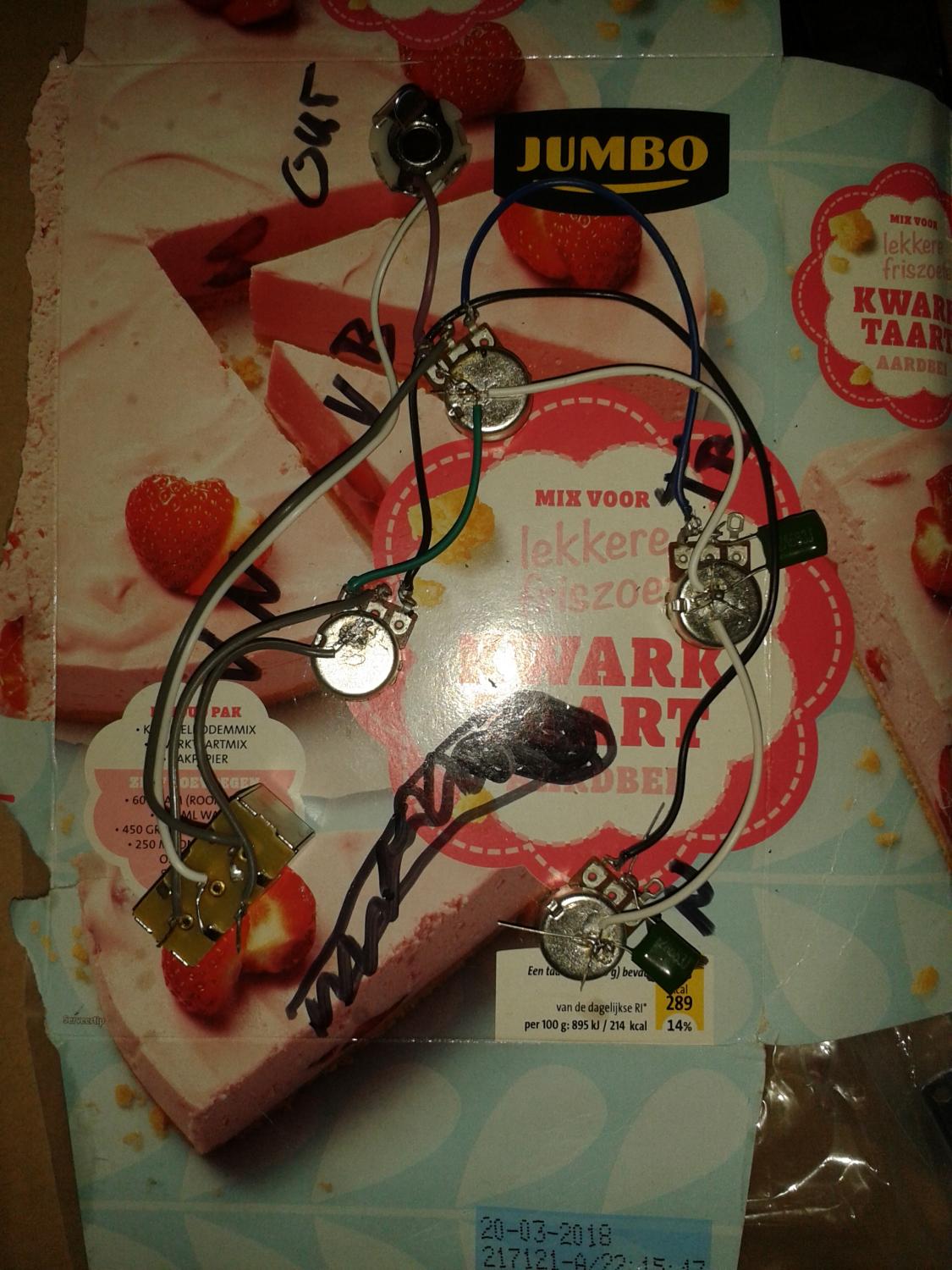

    The electricks were pretty easy.. just make a carboard template and follow the diagram..

    I'll be making an ESB-4 kit for a friend in the future (it's slightly customised so it won't turn up until November), so I'm keen to see how you get on. 3cm is pretty high, so yes, sounds like some neck heel/pocket work is required.
    You may find that the neck joint settles after a few days. My ES-3 neck didn't fit in the pocket properly on first opening the box, but after putting it aside for a week or so, I then found that it fitted really nicely. All that air travel with its associated climate changes can really mess about with the wood.
