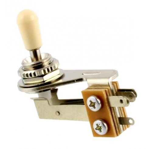

    Are you using the standard kit parts, or have you bought your own? The standard 3-way switch that comes with the kit will need to be replaced to wire it that way. You'll need a Switchcraft (or similar) blade type to do this, probably a right-angled version like this as you may not have the depth for a straight version.
Name:	allparts-ep-0065-000-toggle-switch-3-way-right-angled-nickel-p5584-11182_medium.jpg
    You'll need to spread the contacts out to avoid short circuits (and heat-shrink insulation to cover them up is a good idea here).
