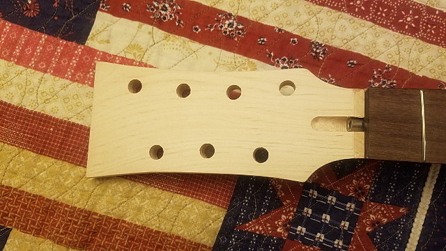

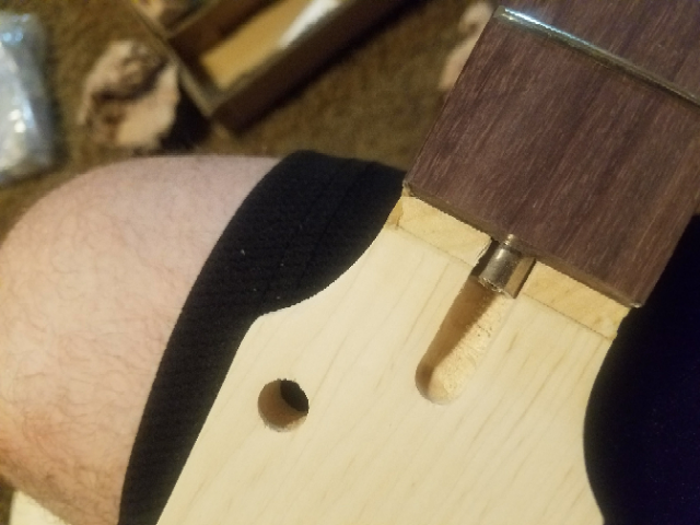

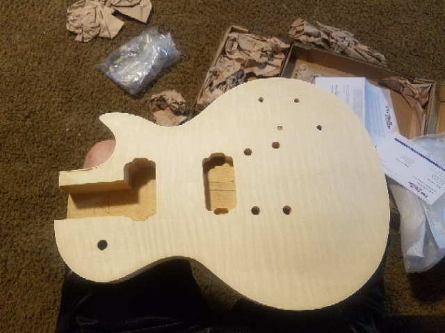

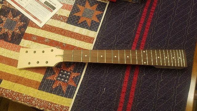

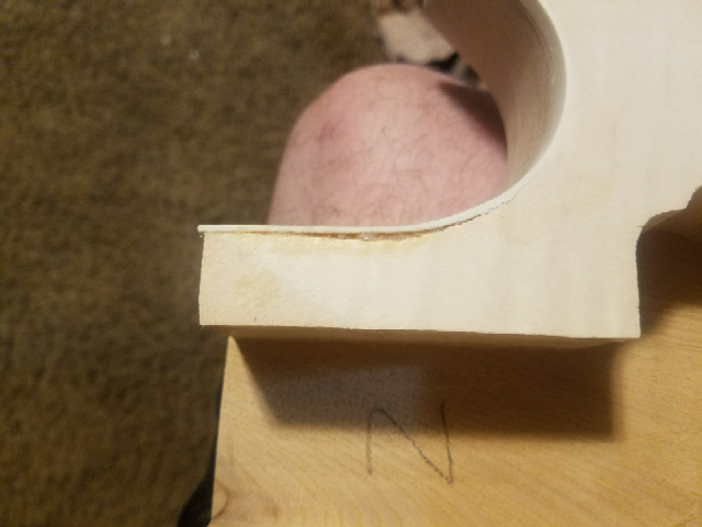

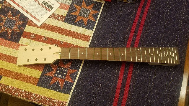

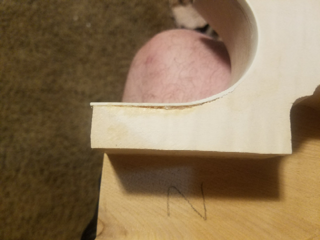

    I got my LPA-7 in the mail today. I am mostly satisfied with the quality. The neck is in good shape but the nut was either glued poorly or the heat during transit made it fall off but either way, I will have to replace it with a higher quality piece. The body was in pretty good shape. I will wait to judge until I have completed my mock build but it does look like the veneer is not properly centered with the body which will be a horrible disappointment because I will have to change to a solid paint instead of a beautiful wudtone stain I have in mind. I'll update when I know for sure. There are a few tiny dings in the front face of the body but I believe they will sand out very easily. There is an atrocious error at the top of the body and I will have to spend a great deal of time trying to repair it before I move forward. This was a disappointment and I will have to work slowly and carefully to repair without worsening the mess. All-in-all though, I am happy with what I have received for the money spent. The possibilities are endless and I am a flexible person who can work with imperfections.
    Here are the pictures of the body and the blemishes that I found:

    Yeah that binding boo boo is pretty bad. I would try steaming out your dings in the front face as the veneer is only about 0.6mm. Sanding may not be an option if they are fairly deep knocks.
    That binding looks like it pulled away from the wood shortly after it was glued - you can see that there's a bit poking out beyond the body. You should be able to get a thin bladed knife in there and cut that couple of inches of binding free, scrape away the old glue and then glue it back in place. Either use superglue (being careful not to get it on the wood below the binding if you want to stain it, or use acetone as a solvent to melt the rear of the binding to stick it in place. Multiple pieces of masking tape will hold the binding to the curve.
    The fretboard should go right up to the edge, so the top of the binding should be hidden.
    AS Frankie says, those veneer tops are very thin, so do try and steam the dents out. A steam iron on a steam setting with some cotton cloth between it and the veneer should hopefully do the trick.
    You could simply stick the old nut back on, but a bone replacement is a cheap and worthwhile upgrade. A smear of PVA or Titebond will do the job. Just clear away the old glue with a flat needle file first so there's a good base to glue it to.
    The veneer join line may not be perfect, but it doesn't look too bad in the photo. Other people here have had worse join lines and still carried on with a burst or stain, with a good looking end-result. To get over it, some people have done a reverse burst- with a dark centre and lighter edges. But it is a very personal thing, and only you can decide whether you can live with seeing it each time you pick up the guitar.
    Unfortunately you also need to check for glue marks on the veneer. Rub the veneer with a cloth with some turpentine, methylated spirit or white spirit on it (these wont affect the glue holding the veneer on like water can). The veneer will darken but any areas with glue on will stay white. Along the center line and around the edges are the normal locations if there is any glue residue on the top. This needs to be removed before staining, and most commercially available glue removers should do the job. I don't know if you have access to a product called 'Goof Off' - but that's what a lot of people on here have used.
