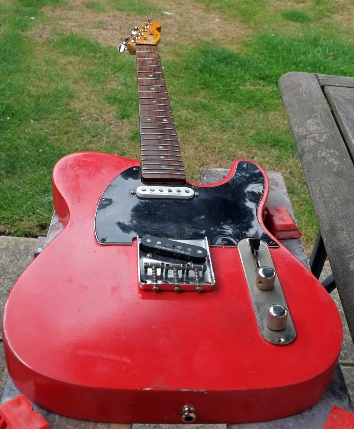

    As I started with the guitar body stripping yesterday, I decided to carry on whilst the mood took me. This is my 5-string G-tuned Tele (well it would be if it had strings).
    It has a one-piece mahogany body (made by a mate of mine a very long time ago) and given to me in exchange for some musical kit I gave him. The current neck on it is an eBay copy, as the neck it came with (maple board) was in bad condition, with the frets almost falling out (it had been stored in a loft for ages before I got it and the pickups were all open circuit). Last year I worked on the old neck, took the old frets out, re-radiused the board then fitted new frets. It has some tinted lacquer coats on, but needs a few clear coats as well.
    The body had been varnished and wasn't smooth at all, so I spray-painted it red over the top of the varnish (this was a few years ago). Either the acrylic car paint reacted with the varnish, or the acrylic did its trick of not drying, because the paint has always been very soft.

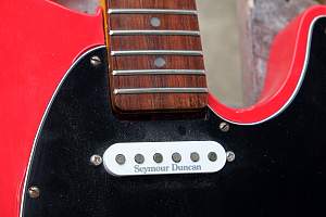

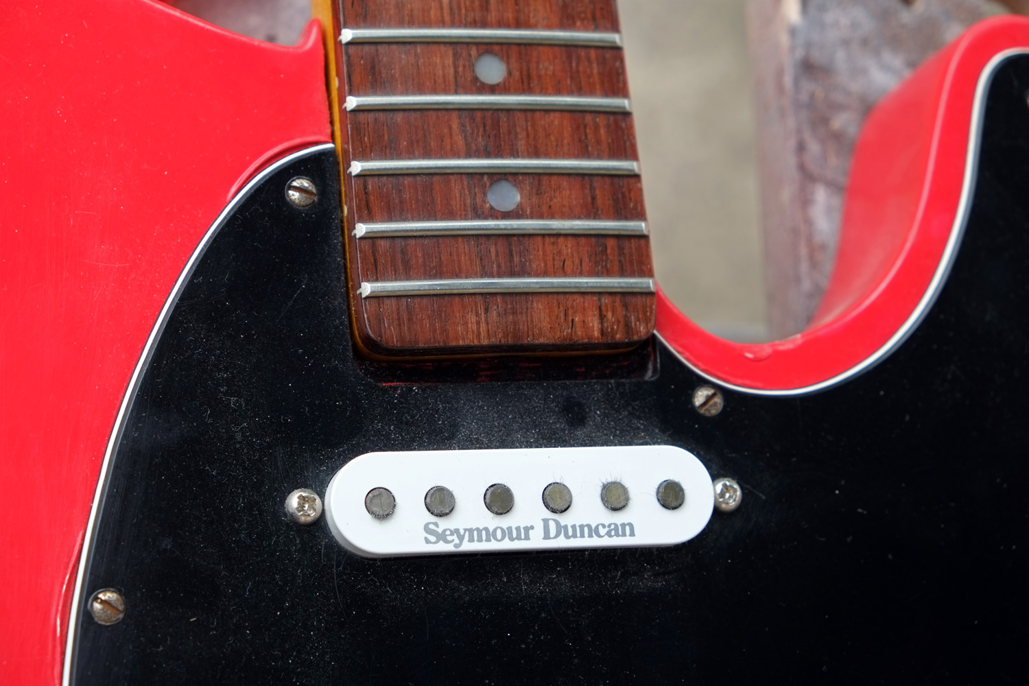

    Here you can see how the pickguard has caused a crease in the paint round the edge. Also, you can see how the neck pocket had been cut a bit short by my mate. leaving a gap between the guard and the neck (artfully disguised by a black Sharpie).

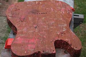

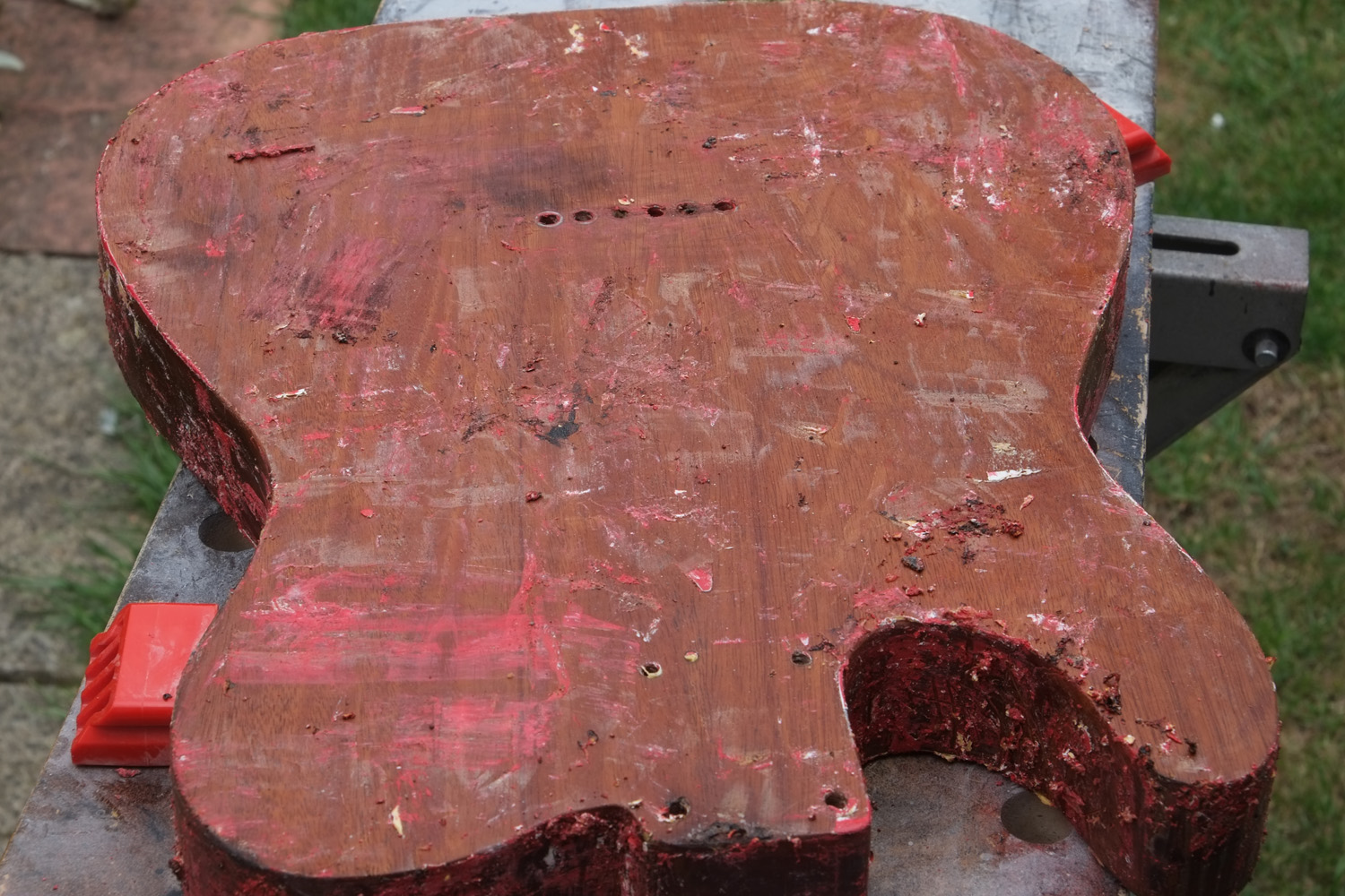

    So it was time to give it a revamp and start work on the body. After the success with the heat gun yesterday, I tried it again today with slightly less accomplishment. Whilst the paint came off, it was all a gooey mess that stuck to the scraper and back to the wood. So here it is after I stopped with the heat-gun, in the best Jackson Pollock tribute I could muster...

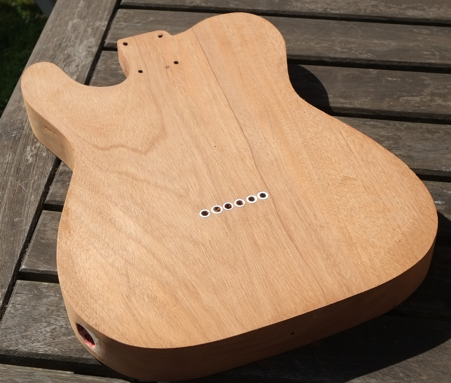

    But after a run over with the belt and detail sanders, it's all come up looking nice and fresh.
Name:	Wood front.jpg

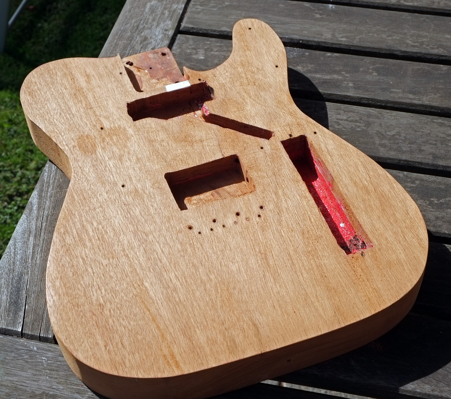

    As you can see, he didn't rout the cavities but used a chisel.

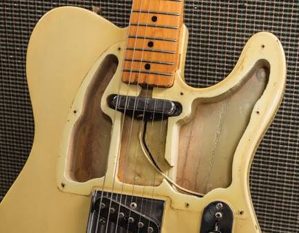

    great project Simon. Maybe you could weight relieve the body with cut outs under the pickguard like the smuggler teles... love the plan for the colour - will look classic
    It's not overly heavy (I do play a Les Paul), but the body is a bit thick compared to a normal Tele, so thinning by 3mm should make it a bit lighter, and I did deepen the control cavities a bit with a router - if only to get a level floor to them. I may need to enlarge the bridge pup rout as it is a bit on the tight side with the pup installed. I'm not a big fan of deliberate weight relief as I'm never quite sure what it will do to the sound.
    The pups currently on it are an SD Hot Tele bridge and an SD Hot Strat neck. Not sure if they are the best choice for it as they sound a bit 2-dimensional. But I'll see how it sounds once it's painted and all back together. I can always change them for something a bit more classic. I need to upgrade the pots and switch anyway, so may well try a 500k volume pot to get them sounding a bit brighter.
