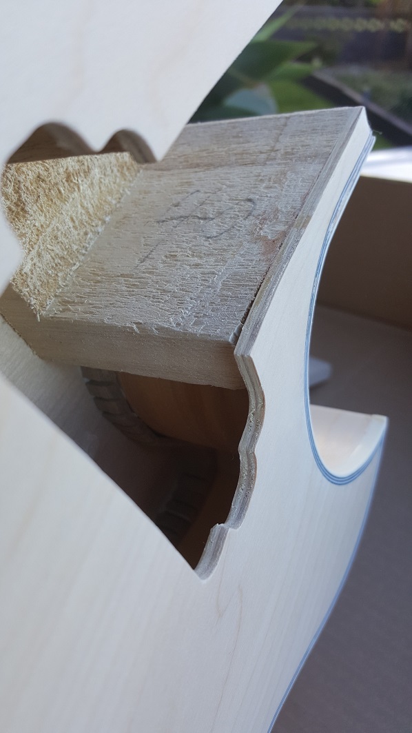

    One thing I'm unsure on is whether I need to fill a gap I found between the top and the neck bracing timber:
    Long time playing, No time building
    How does it look on the other side as that shot appears as though it is tapering up as it gets nearer to the neck PUP cavity? If same on other side probably how it should be and therefore filler might be required. If not and it looks to be riding too high (my suspicion) then it may need to be glued and clamped.
    Canberra
    9
    Hey Waz, yeah it was tapering up on the other side as well and there's a bit of wood putty or similar already in there, so I've filled it both sides. I'm not sure how much of a difference it will make but given the small effort involved was probably worth doing.
