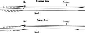

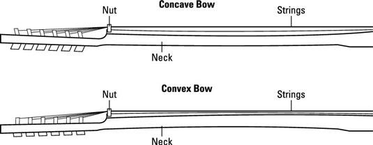

    Sorry to hear you are having issues. Without any photos (and knowing how experienced you are at setting up guitars), it's first worth checking the neck bow. The neck should have a very slight concave bow to it. If it's got an upbow (see diagram below) , then the strings will need to be raised a lot higher than necessary to stop them buzzing.
    If you do have an upbow, the truss rod needs to be loosened (turned anti-clockwise) until the neck becomes flat or with a slight concave bow. The neck takes time to settle after truss-rod changes so don't make large changes in one go. Normally 1/4 turn max. is advise. but until it's at least straight, I'd try 1/2 a turn, then wait an hour and see what it's like before making another 1/2 turn. As the neck straightens, you can bring the saddle height down as well.
