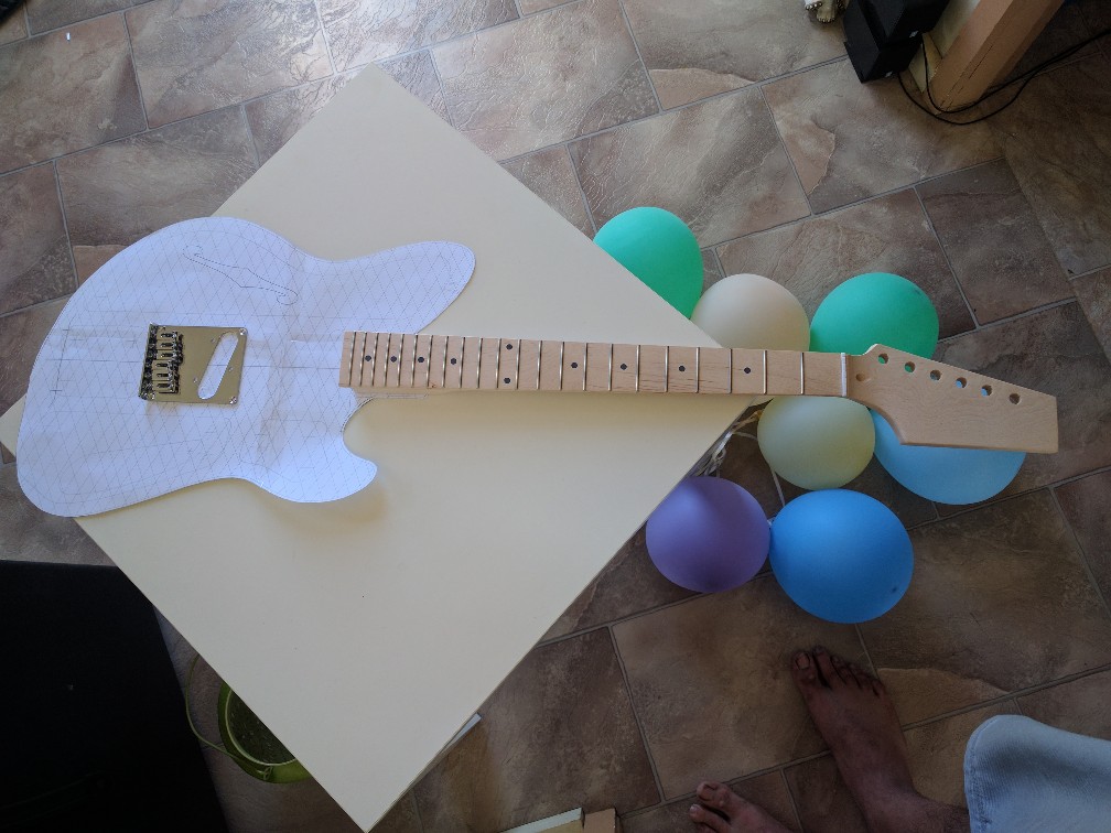

    Ordered a PBG neck to put on it. Not quite ready to build my own neck.

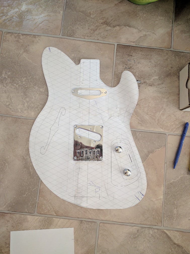

    Some photos of the plan.

    That's actually a pretty cool design, offset tele looks really good
    shape looks cool Fortho, more of a jaguar/jazzmaster shape. Will it be semi hollow with a F hole ?
    Nice you got a 22 fret PBG neck, is the heel square or rounded ? Tele heel should be square

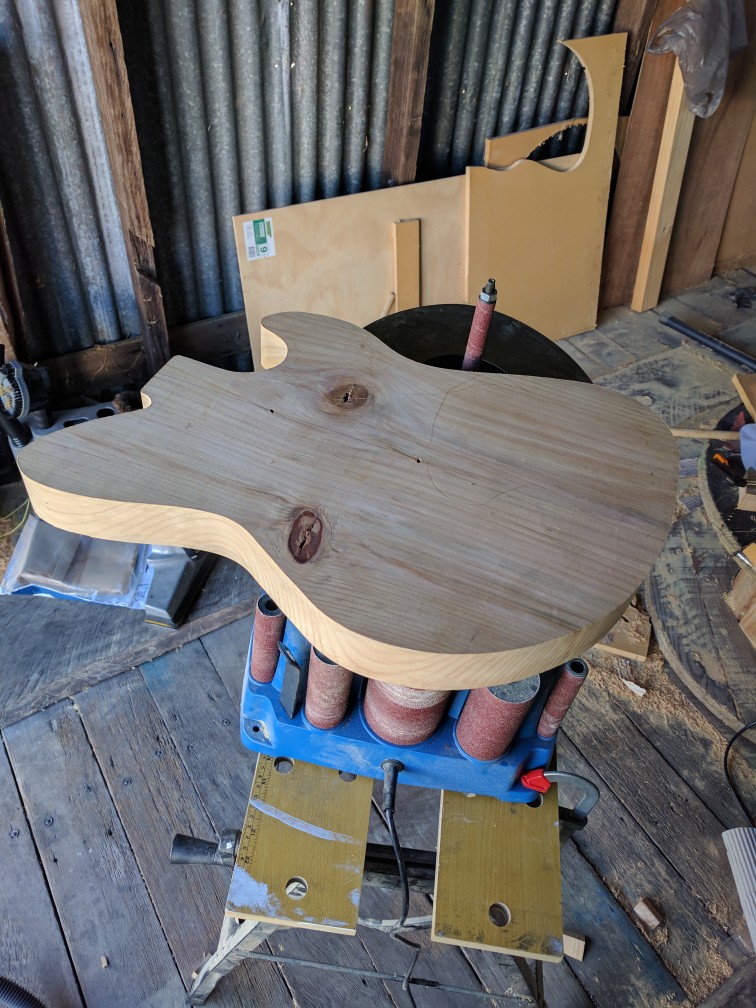

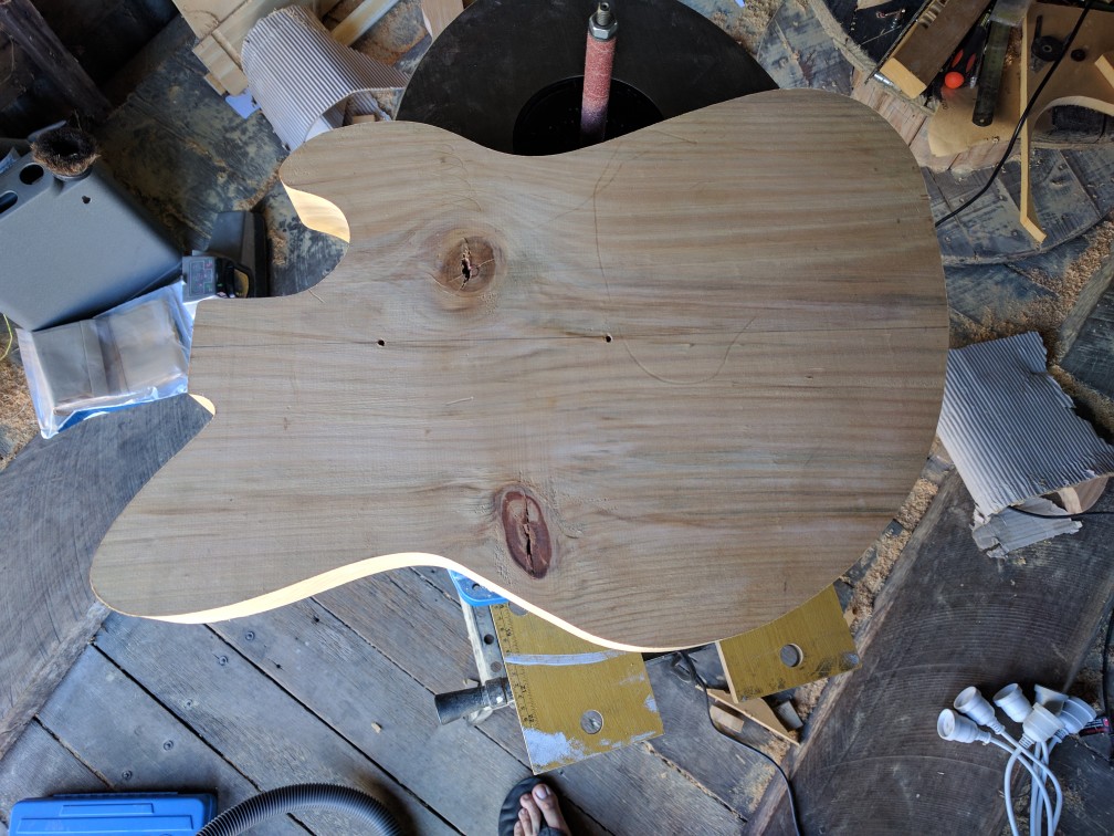

    Built the body out of a bit of knotty Bunya pine. I've only just got stung to filing those knots. Thought I'd do all of the initial shaping first.
    I made a pattern out of MDF with the jigsaw and plenty of time on the spindle sander.
    My jigsaw barely went through the pine to get the rough shape done. Then some routing with a pattern following bit. One bearing exploding on me making me happy I actually wore eye protection that day.
    I'm a bit of a novice woodworker, let the router away once or twice, so a bit of time on the spindle sander to fix that up.
    Square heel to make the pocket a little easier to cut.
    This one's not going to be semi-hollow that's another thought for a later build.
    Ken.
    well done Fortho looks great. How many pieces of pine is that ? hard to see any joins
    Looks like a single piece, nice
