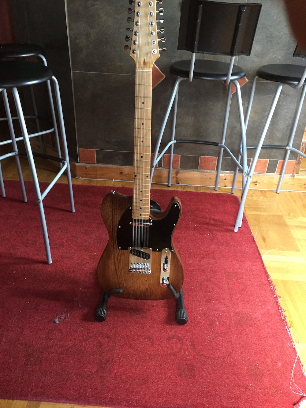

    I didnt do no build diary but i have this pic of the end result....
    next up will be a doubleneck SG (i think)
