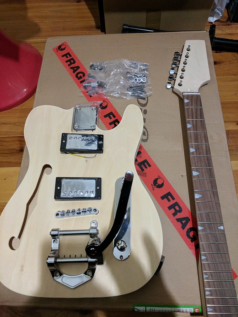

    Just bought a TL-1TB kit recently because of a 15% discount on eBay
    I put together guitars before from finished parts, but never done any sort of finishing so this will be a good learning experience for me. Expecting to make mistakes, in fact the more the better
    I've also bought some amber and brown wood stain to try and get a Honey burst finish, along with Tru Oil to finish
    Few things I have noticed so far:

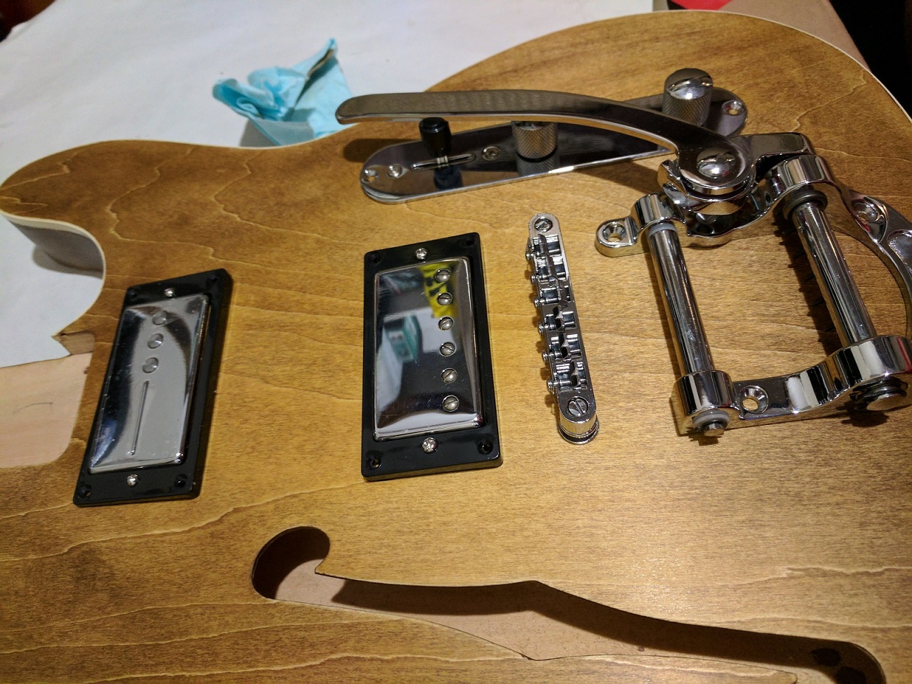

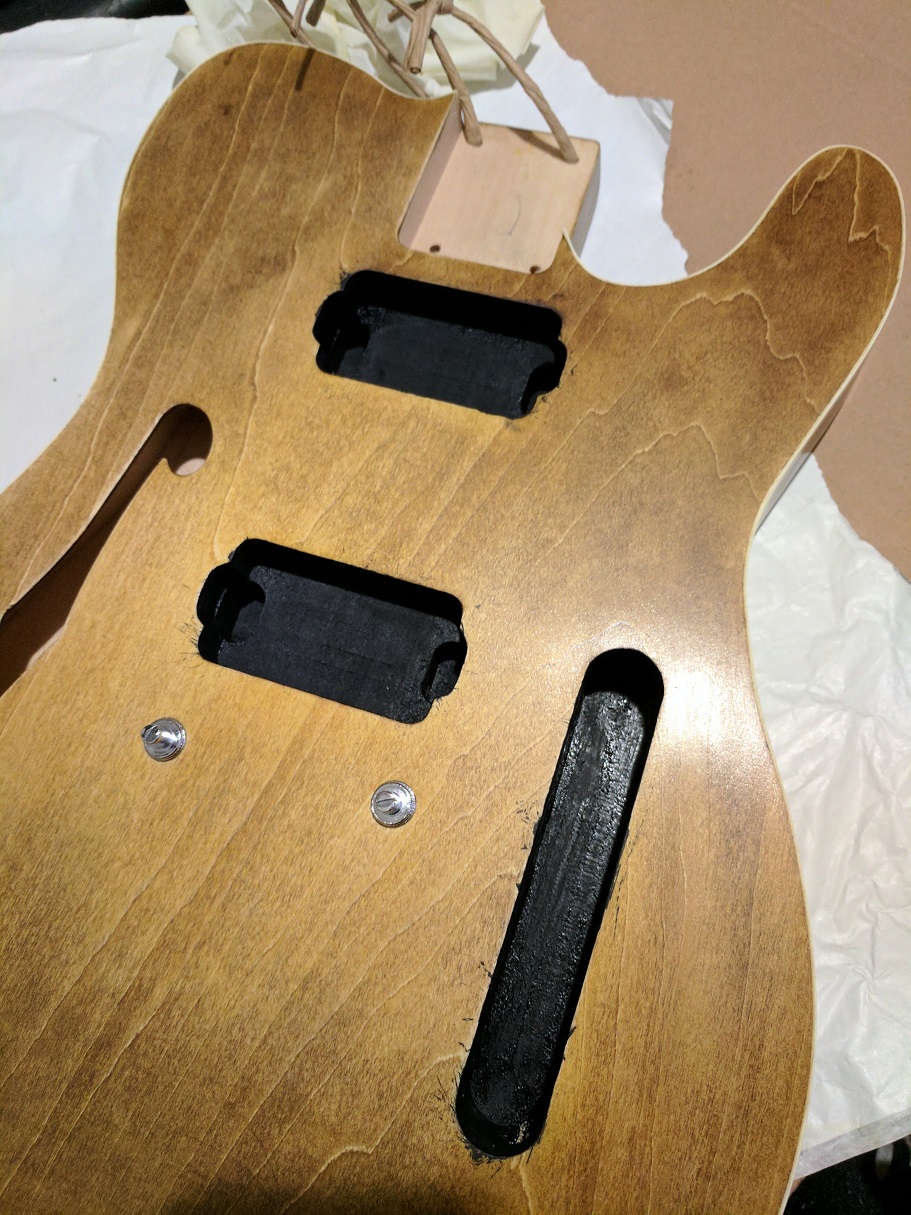

    - The humbuckers dont fit the holes. Looks like a bit of the wood will need to come out before they fit.
    - A bit of the binding in the neck pocket hangs over the edge. I'll need to trim a little off.

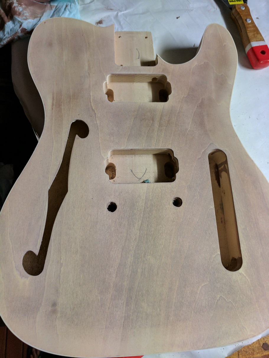

    Test fit
    Next step I guess will be using a damp rag to check for any glue spots and imperfections, and sand away.
    Then I guess some kind of grain filler, then more sanding?

    As for pups not fitting, are the screws too long or the cavities just not wide enough?
    Quote Originally Posted by Rev View Post
    Yeah, wrap sandpaper around a pencil or even a fork handle.... anything thin and relatively sturdy.
    The cavities are not wide enough unfortunately

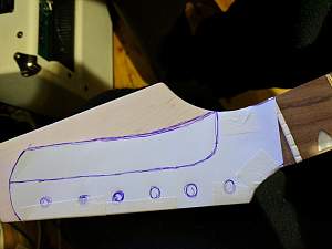

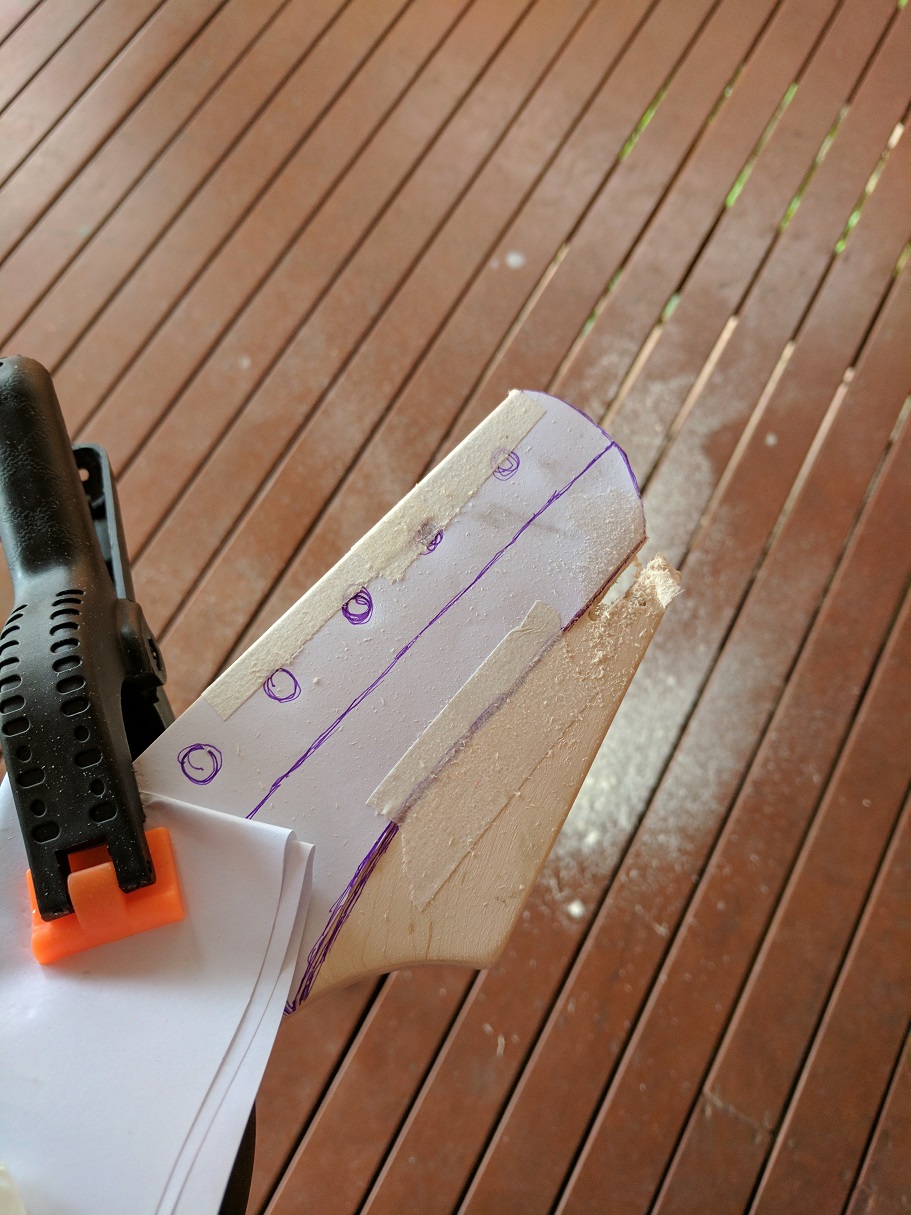

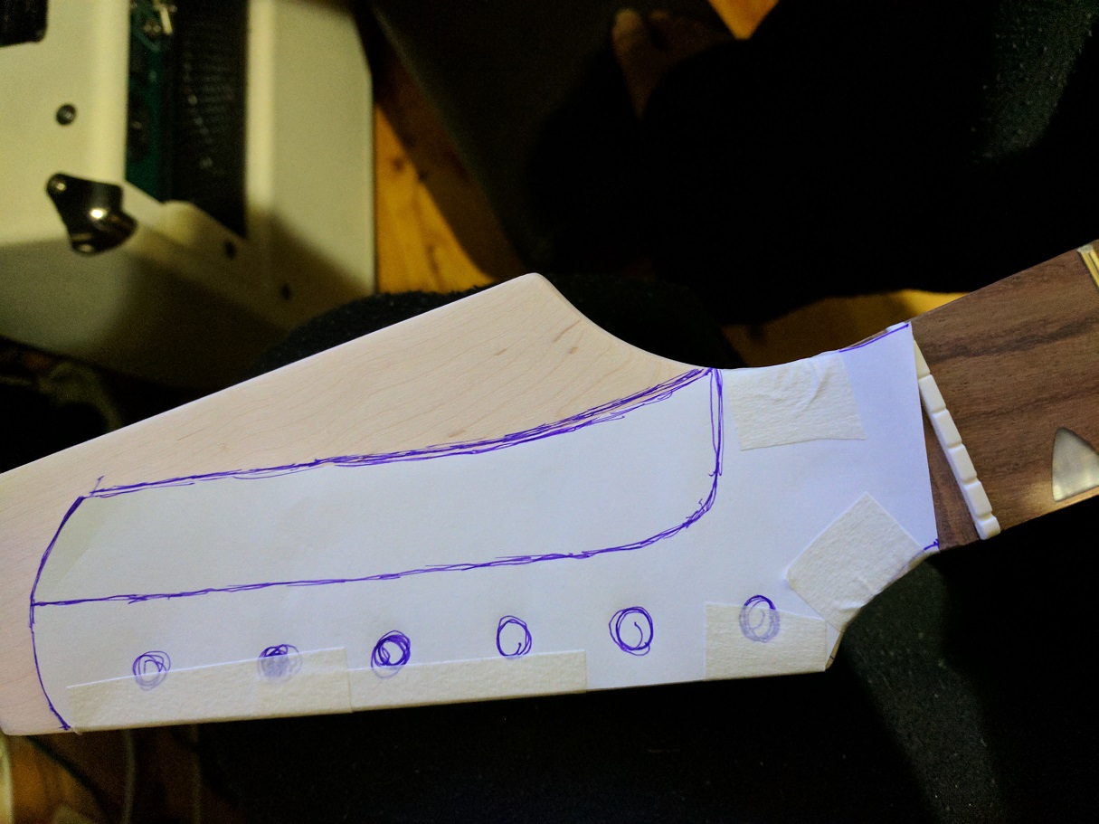

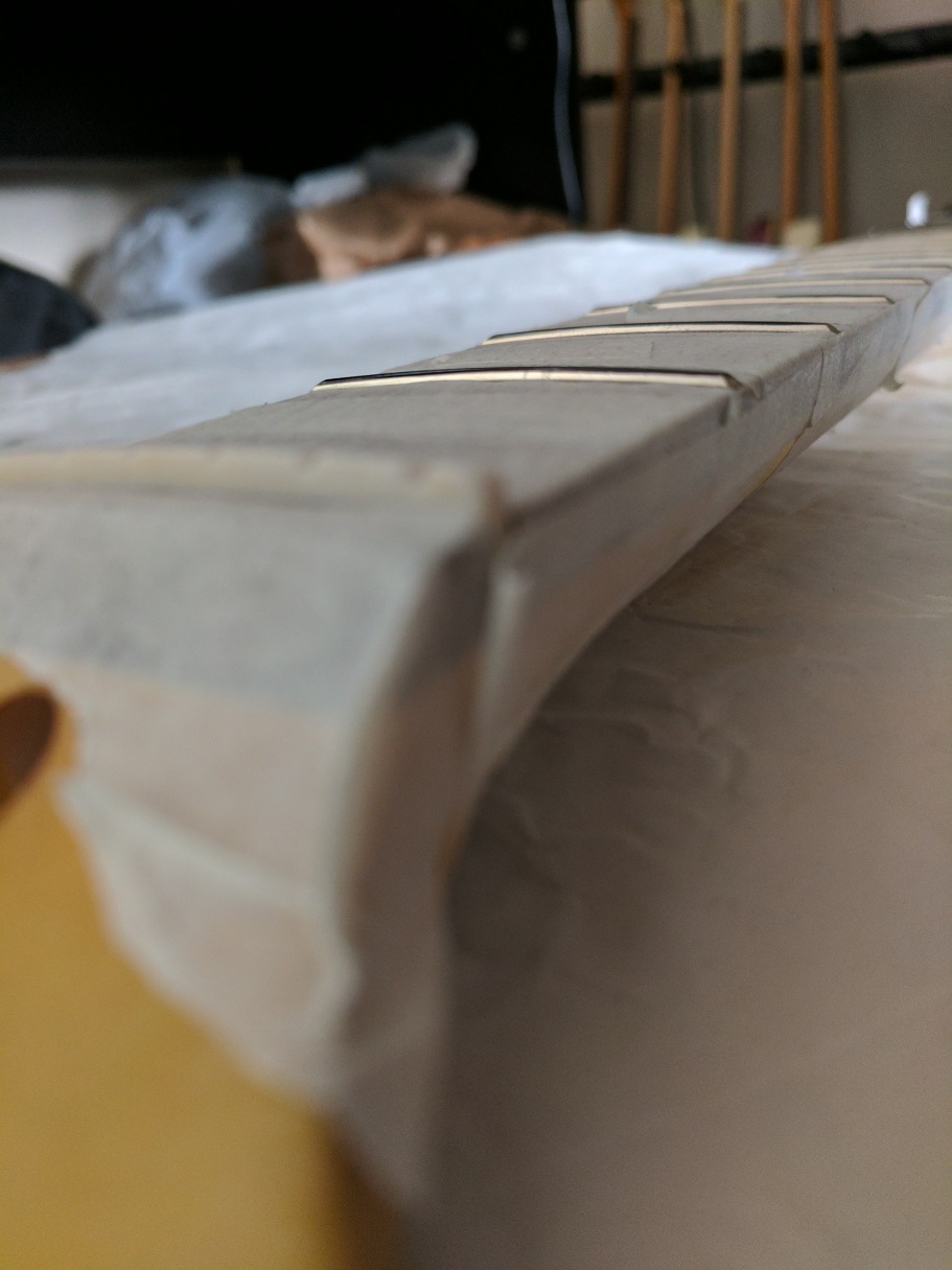

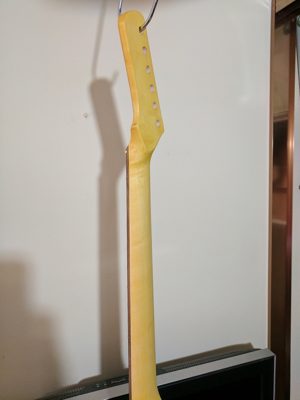

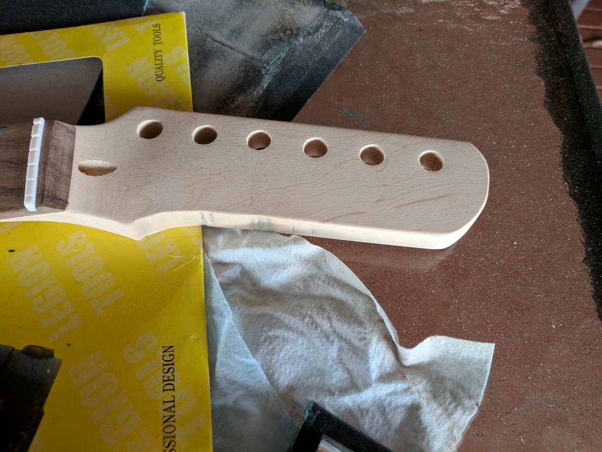

    Decided to go for a headstock similar to the new Parker design, but with a longer shelf thingy (Sorry not sure how to describe it)
    Using my trusty Dremel trio to start cutting
    Alright first part done! Now just need to figure out how to make this shelf

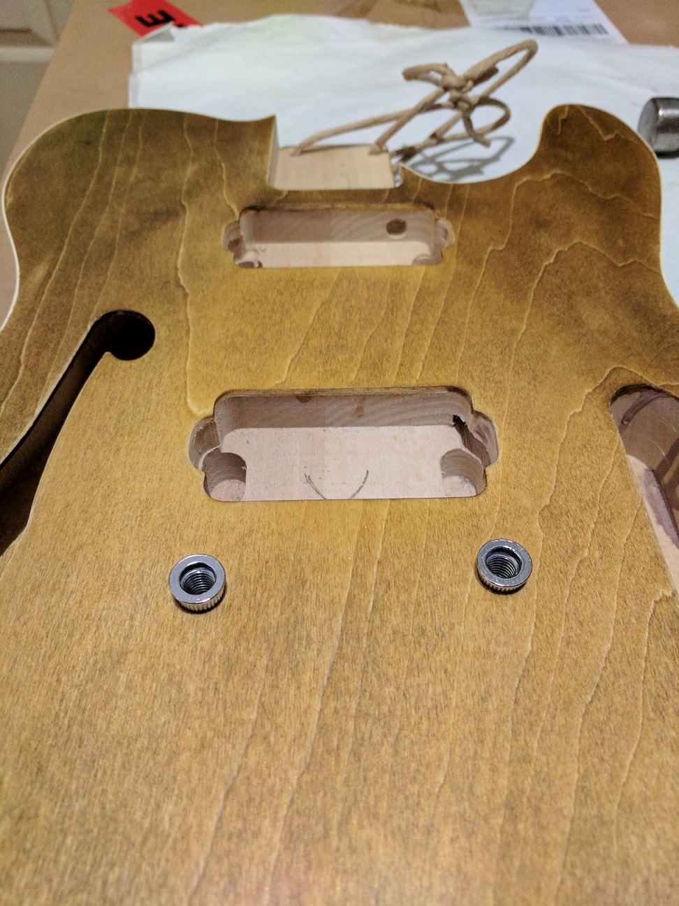

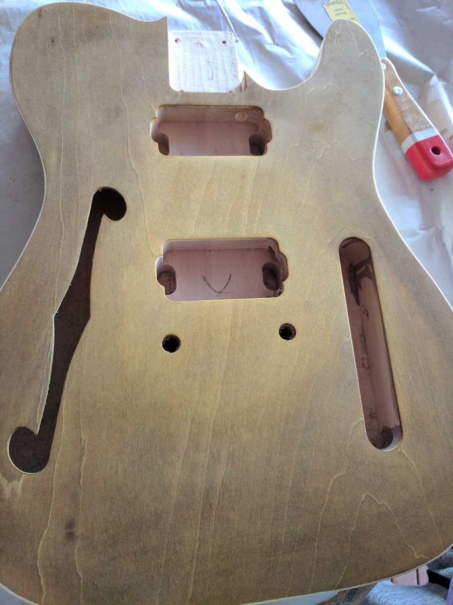

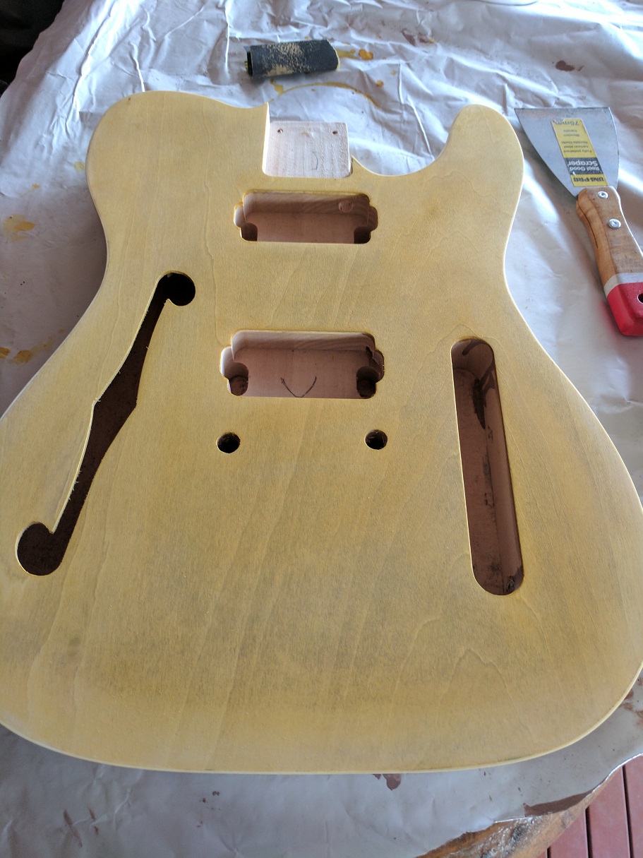

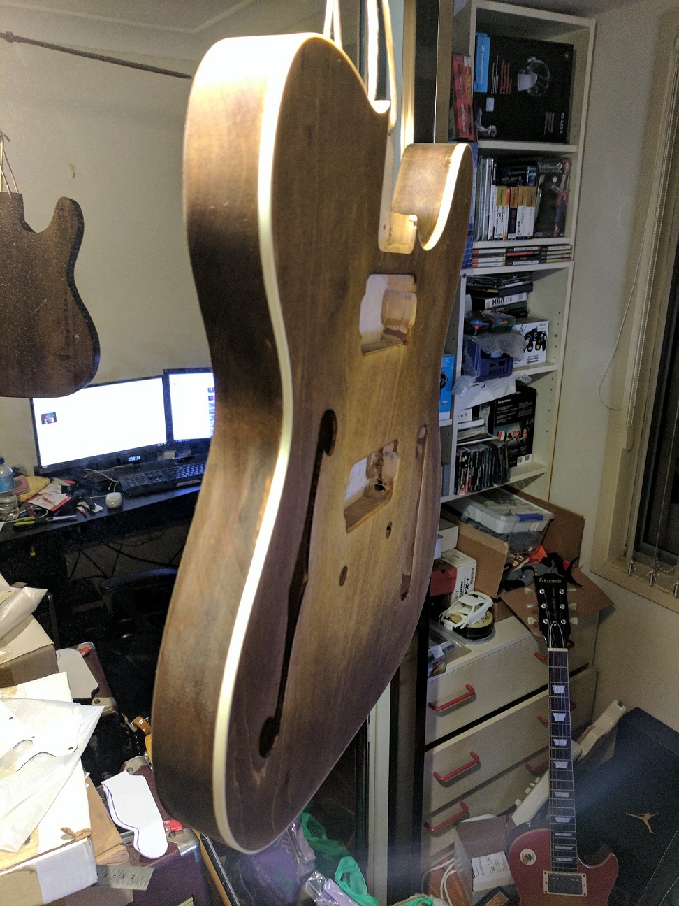

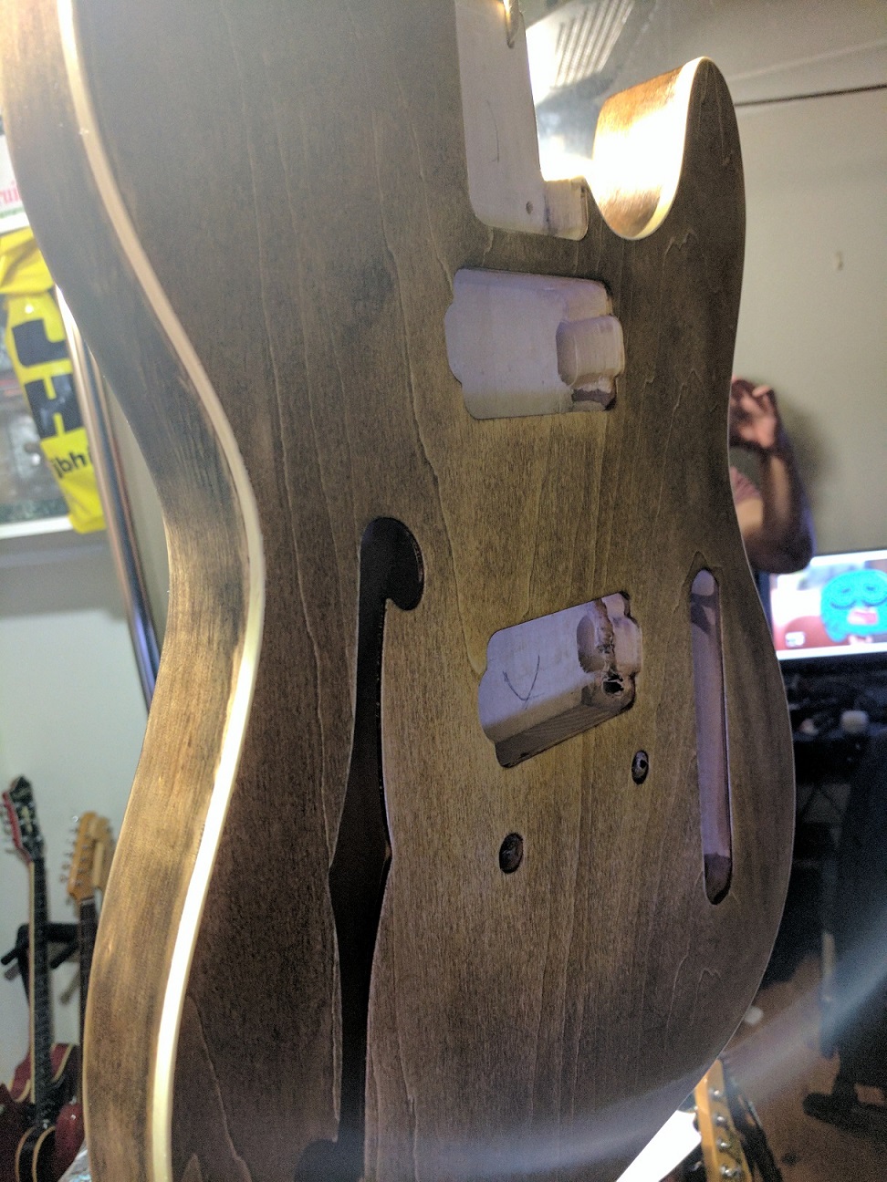

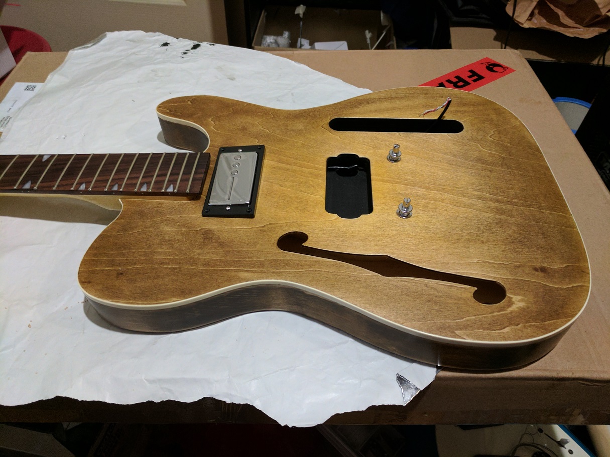

    Onto the body
    Used walnut grain filler on the surface but regretted it and tried to sand back as much as possible

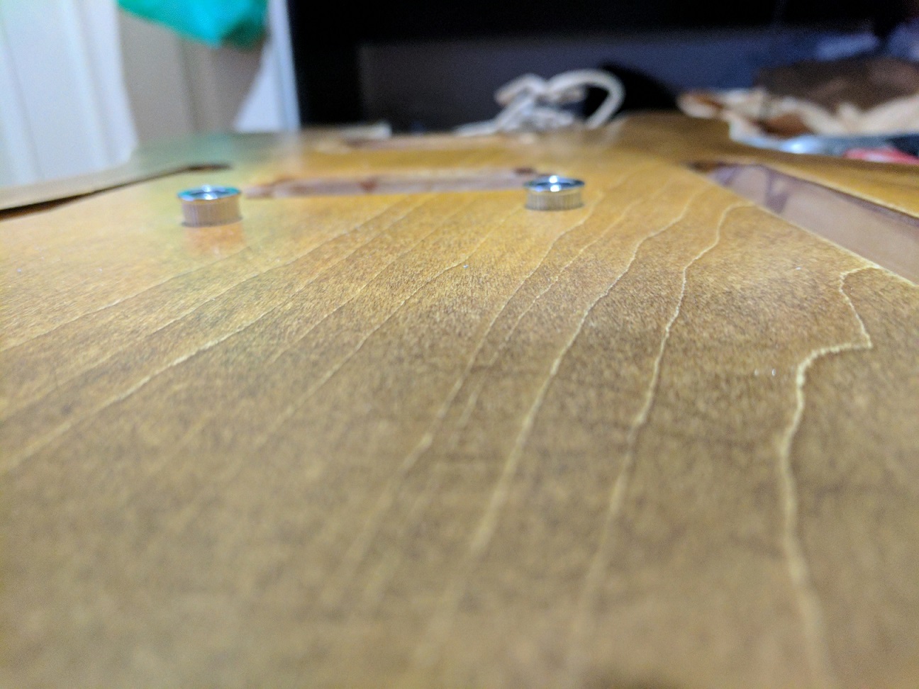

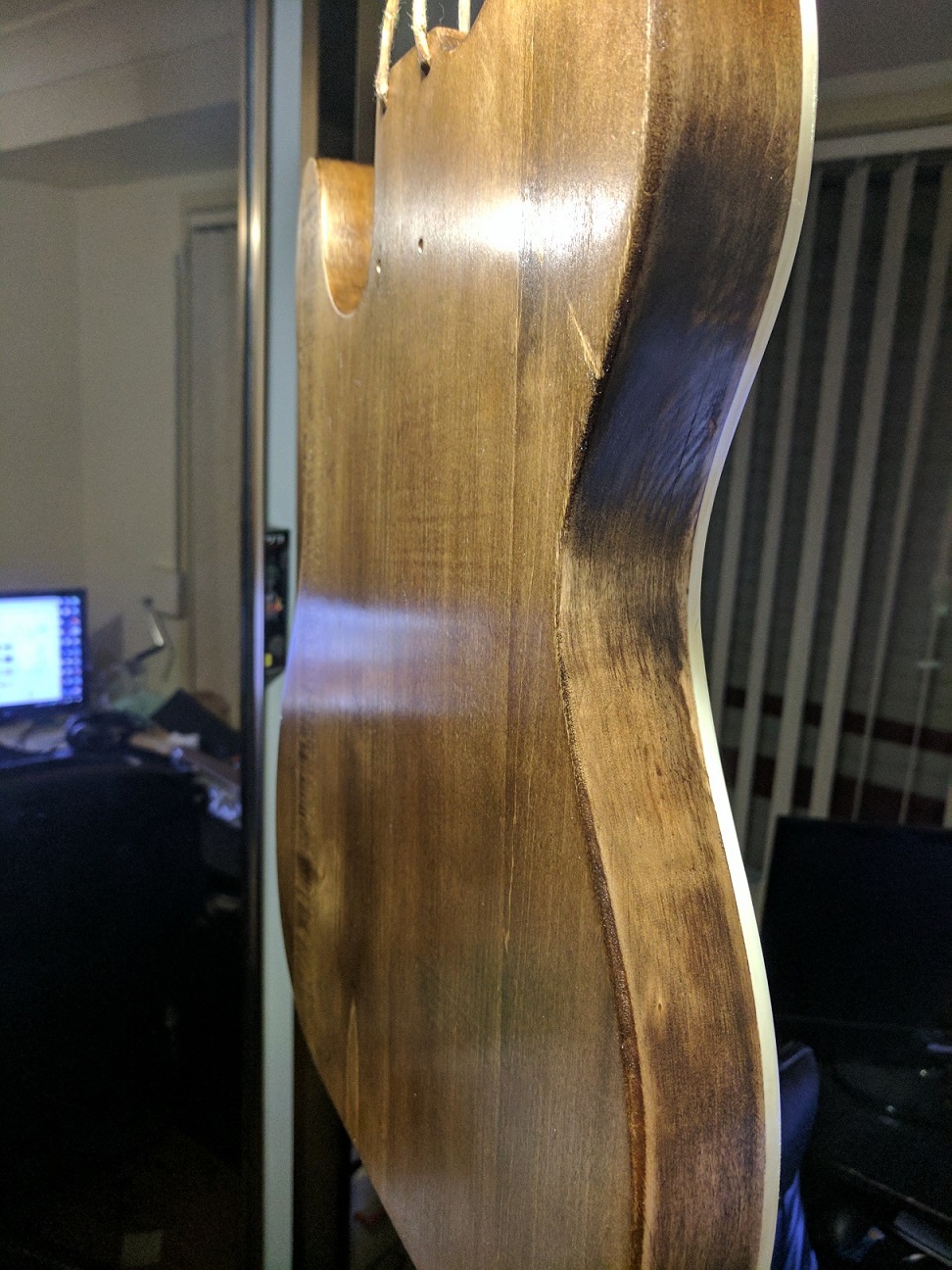

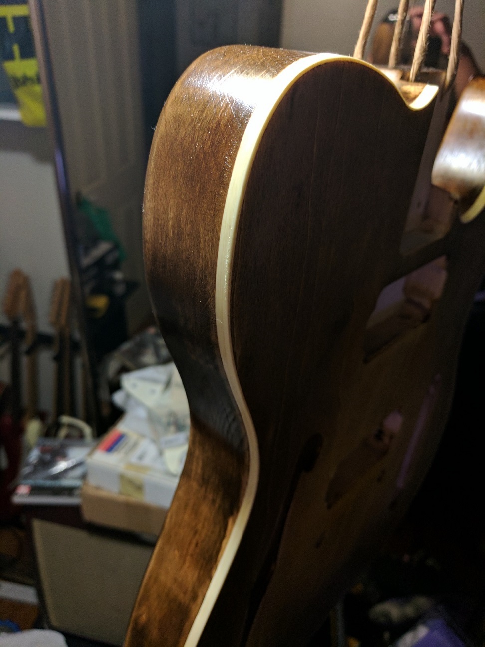

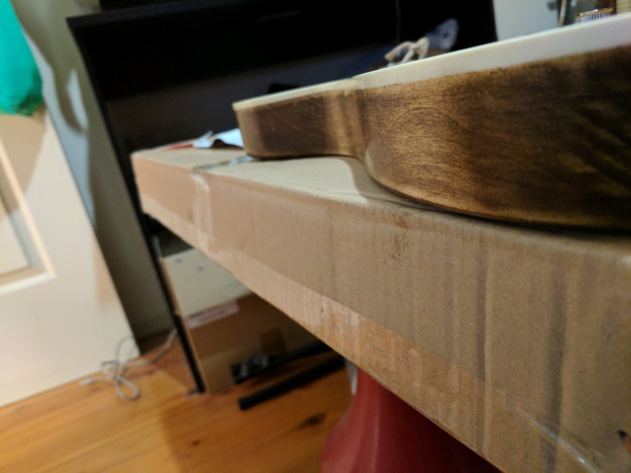

    First yellow stain applied

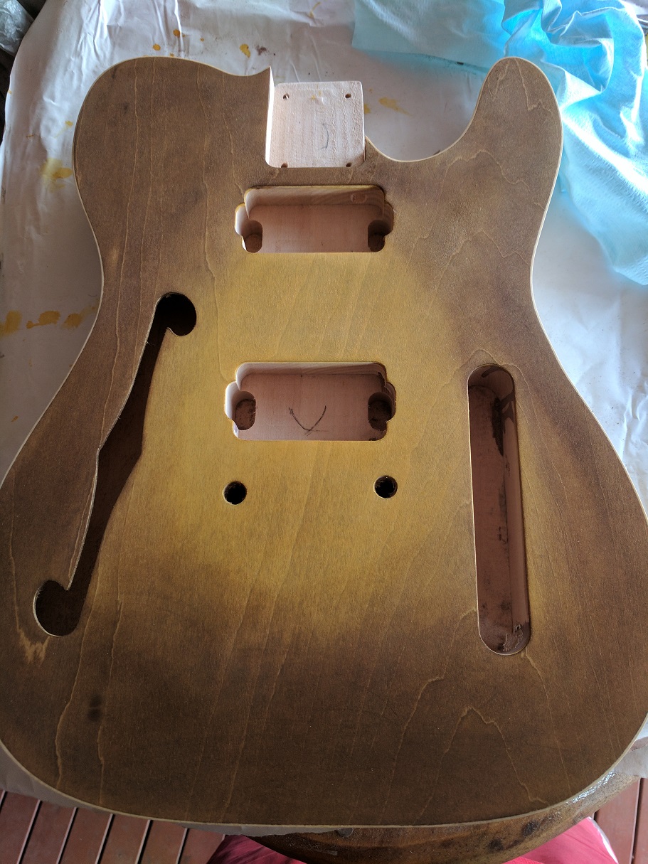

    And now the brown on the outer layer.

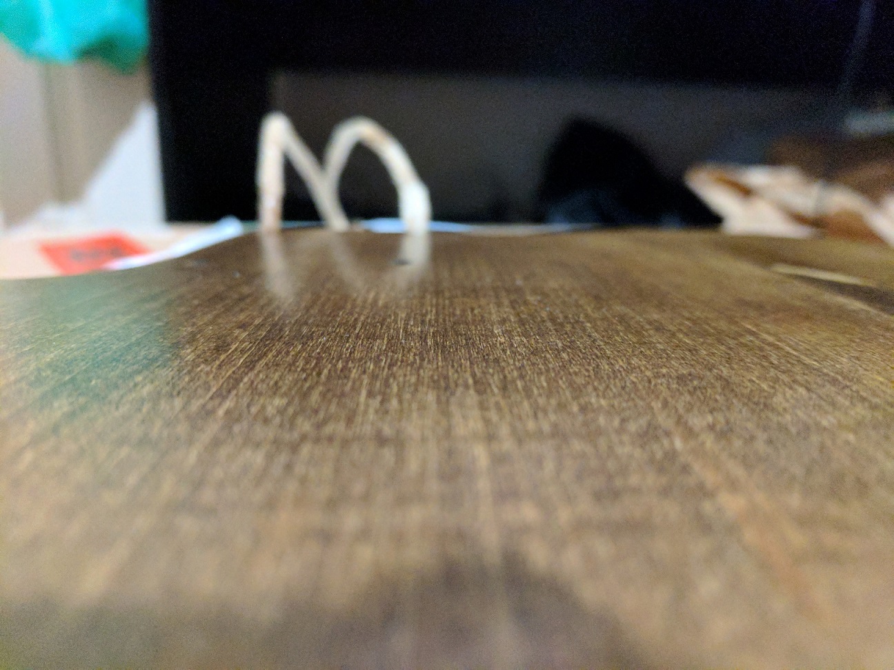

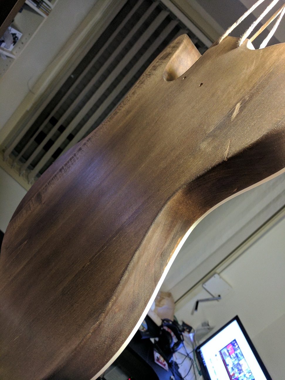

    At this point, I had been diluting the stain with a bit of water but decided to try the stain without being mixed with water
    Much darker
    that an original shape Sock ! round the edge near the high E tuner hole and file the machine marks and sand and it will look tops !
    keep working the burst
