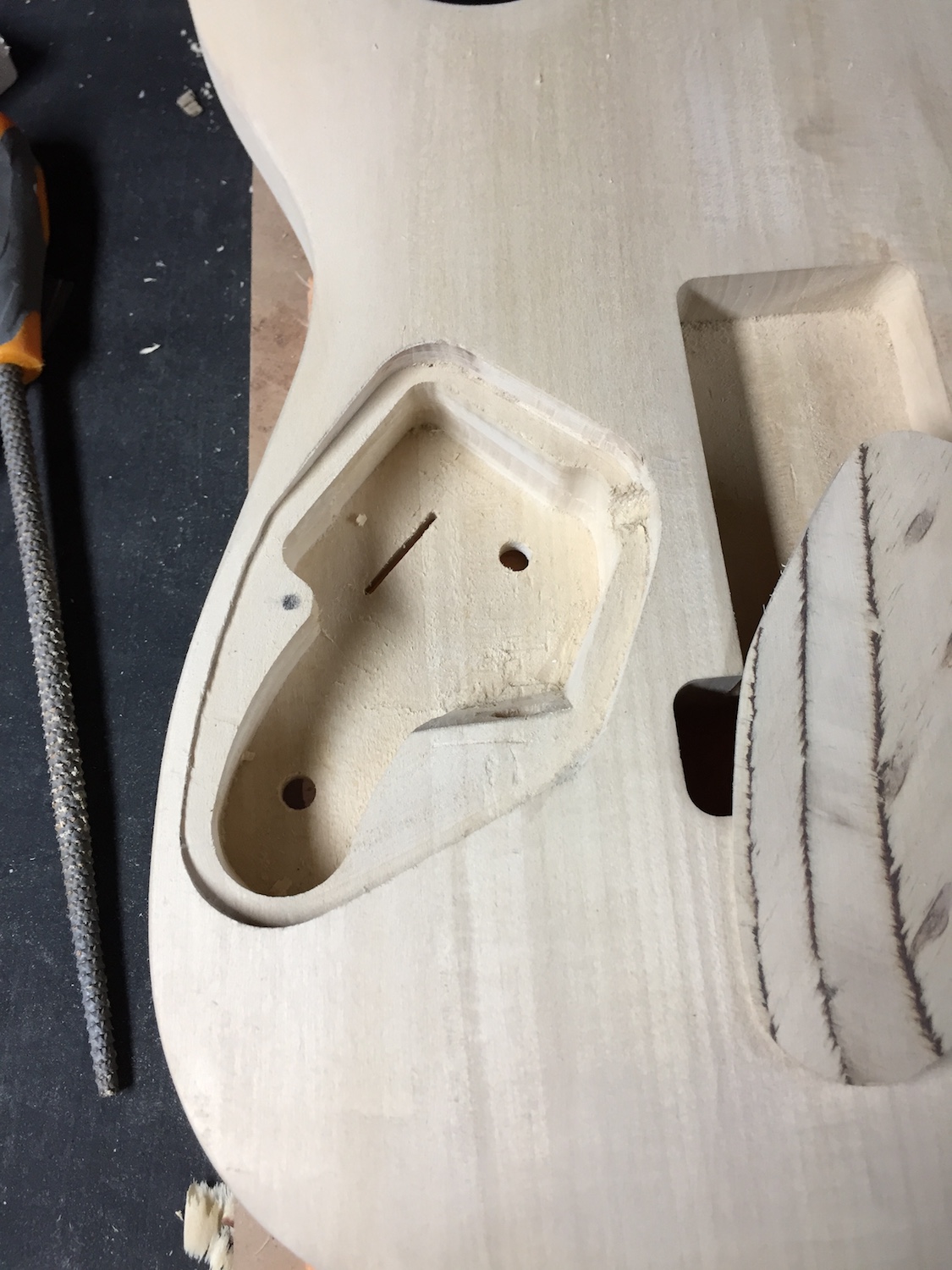

    I've had to make a new board for it, rout some additional channels for the cavity cover (I made this magnetically attached) and re rout to get a land to secure the locking nut for the output deep panel jack.

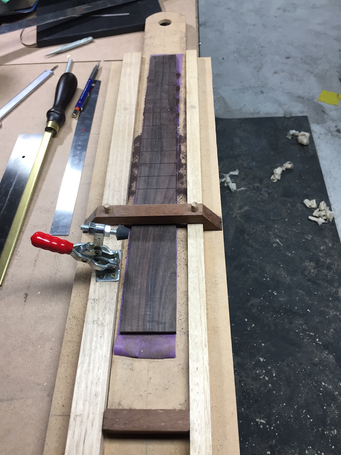

ID:	19997 Fretty, fretty, SLotty Slotty

ID:	19993 New fretboard in place, slotted and radiused, Scale length issue sorted.

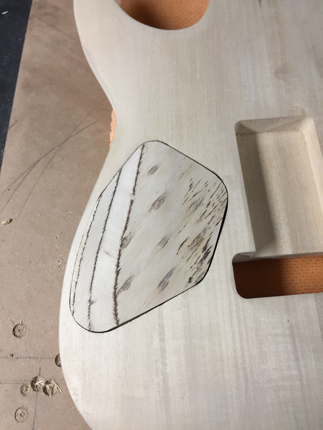

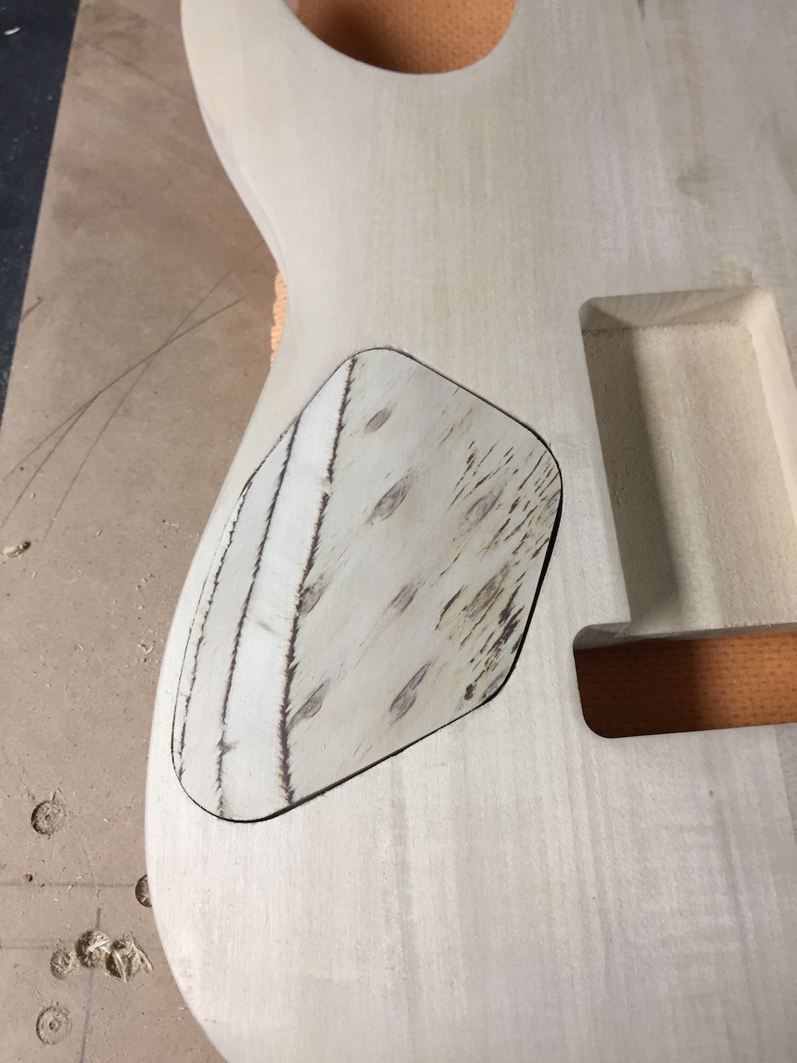

ID:	19998 Cover rout, with carved Ply cover (I Might just make paint that black)

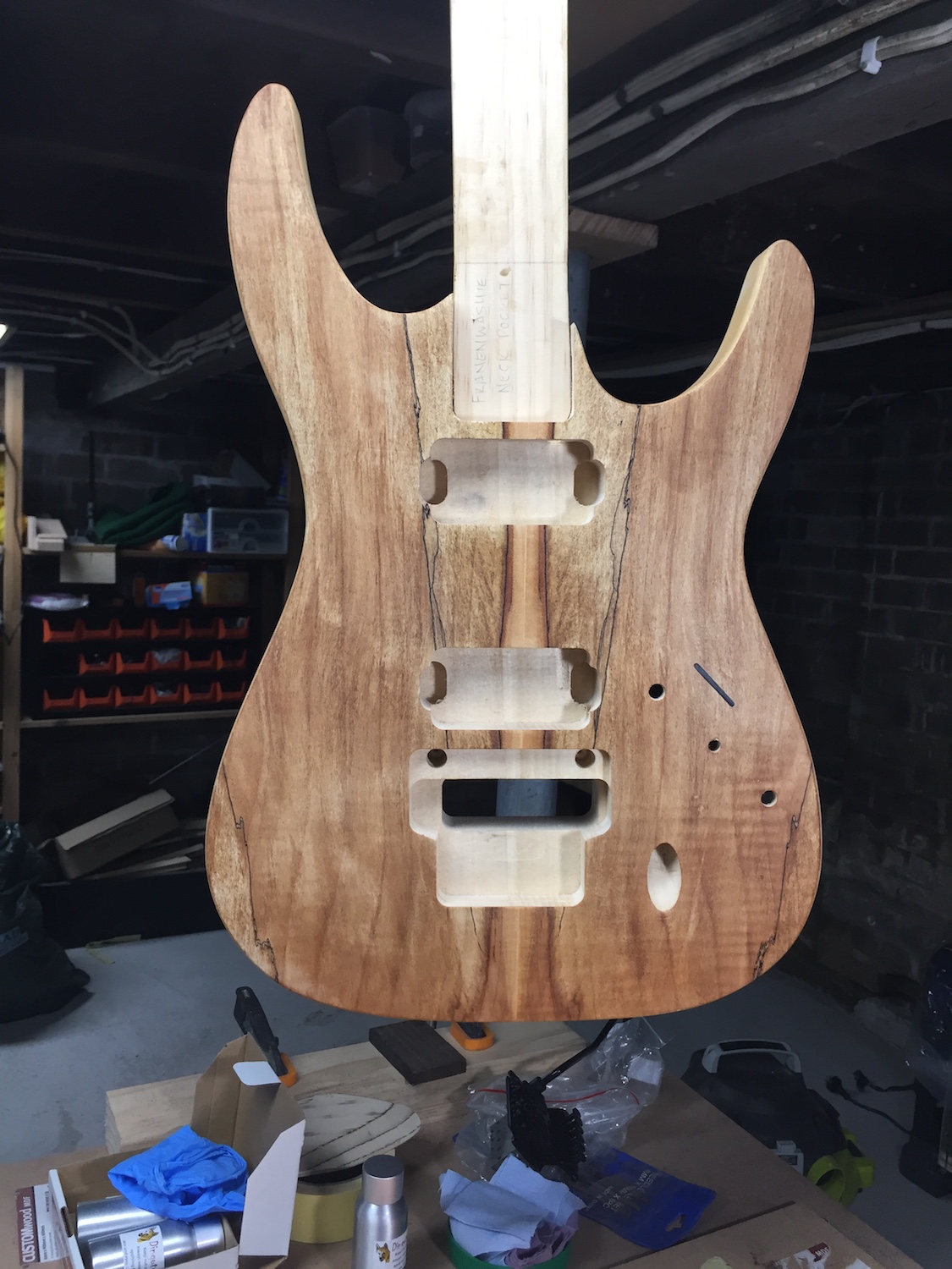

ID:	20000 First coat of DT Clear going on the spalt

ID:	19999 Magnetically attached cover for that no screw look.

    So we are into the DT and hopefully we should be getting somewhere with this one soon.

    I've stripped the board cleaned up the end of the Neck heel and got it fitting right. the new board is a dark rosewood (a PBG Blank i got from Adam) and it has had to be reconfigured to 22 frets.
    I'm happy to say that I've slotted it, attached it, radiused it and created the locking nut seat at the top and the thing measures dead on for a 648mm scale length now, exactly 324mm at the 12th and ditto to the bridge.
    The DT clear is going on lovely, and I will likely get a neck kit as given the amount of work its taken to get the neck up to par I don't want to have to re-finish it any time soon!
