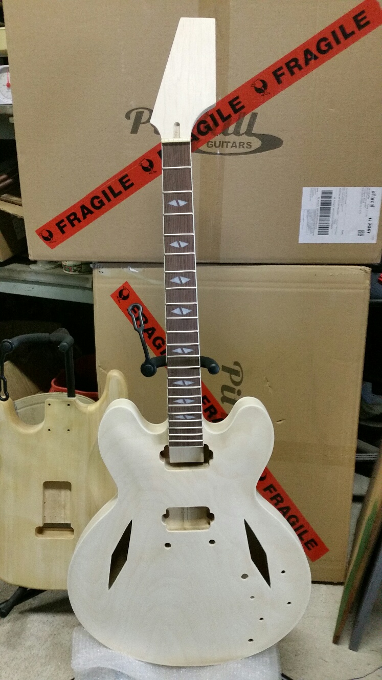

    Postie delivered today.... Qty 1 x ES-1TL .... yay team Aussie post... only took 8 days from PBG HQ to Rocky.
    Parts count and Mock build done. All looks sweet so far in that arena ...
    Neck fit is a wee bit tight, 50kg of pressure still didn't get it all the way home, but that can be fixed a lot easier than if it were loose.
    Doesn't appear to be much glue spill around any of the binding ....
    The grain in the top seems centred above the top of pickup line... I'm thinking the Black pick guard may be needed to even up the final look.

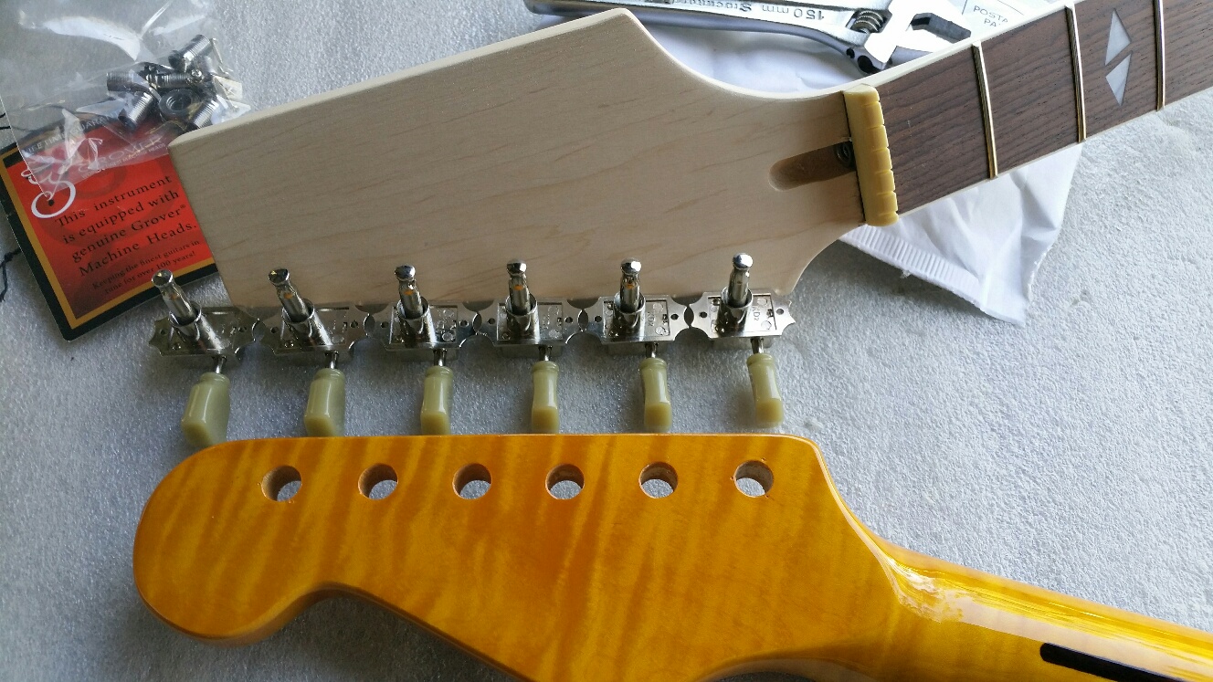

    I ordered vintage grovers due to a lack of 406's, but I think that may have been a mistake as the photo illustrates. I suppose option 2 will need to be put into effect.

    kit looks great Marcel, was the mock build pick taken by Ads at the warehouse or have you got a stash of kits ?
    The spacings of the Grovers look pretty wide, is there a model with closer spacings that will fit ?

    What you talkin about Wokka??? I took dat photo.... See my Alder Strat body sticking its nose in tryin to make a family shot of sorts. .....lol ...
    I did stage it just a little... more to hide the junk behind it than anything else..
    Yeah, the Grovers were the only disappointment... It's not the Grovers fault, but that spacing... Only 5 will fit into where 6 need to go.
    To get the full DG look I'll need to find mini vintage tuners, and I know where I can get a Kluson chrome set, which leaves me with what to do with this set of Grover vintage 6 in line. I'll have a chat with Adam and see where I end up..

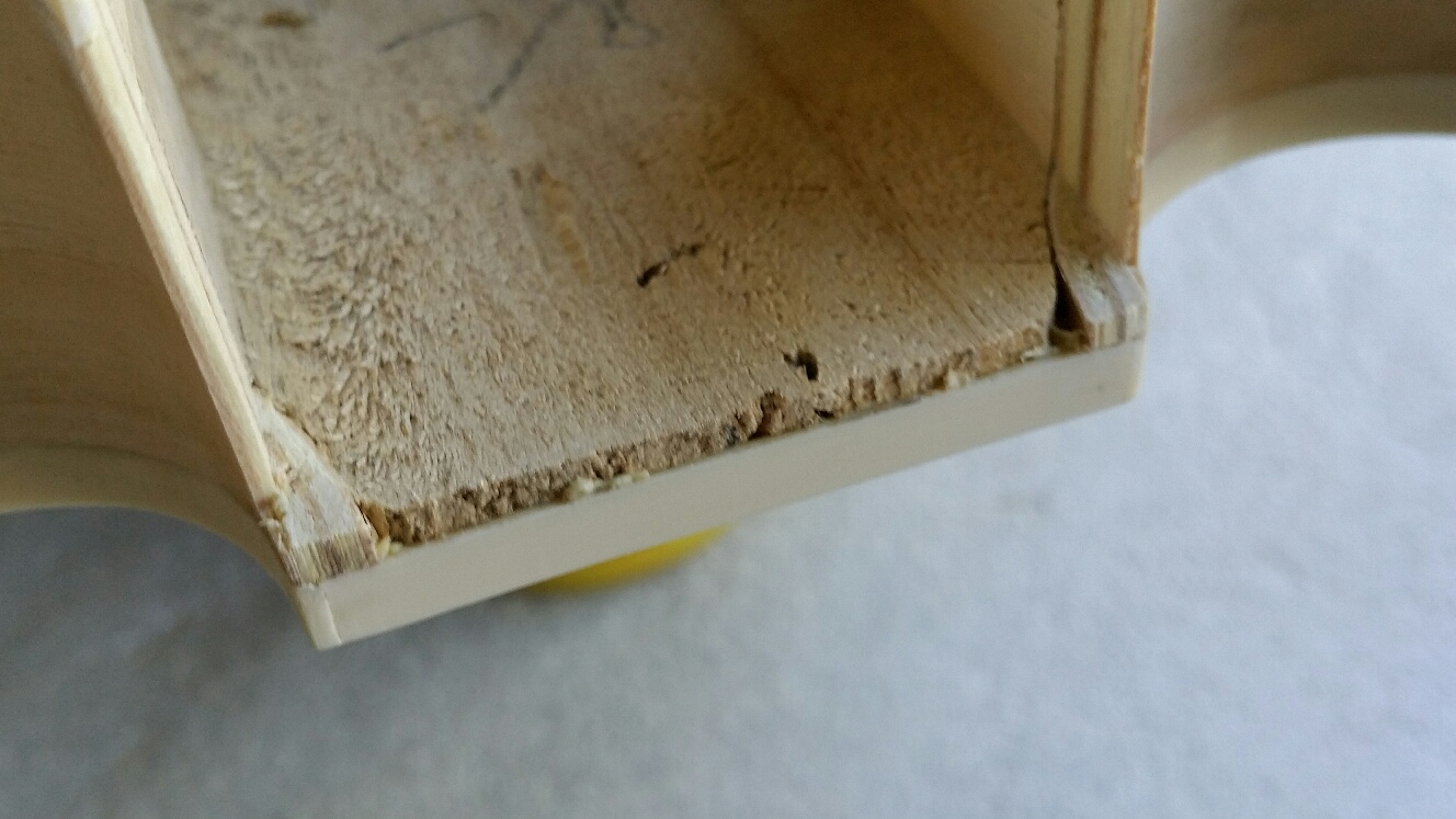

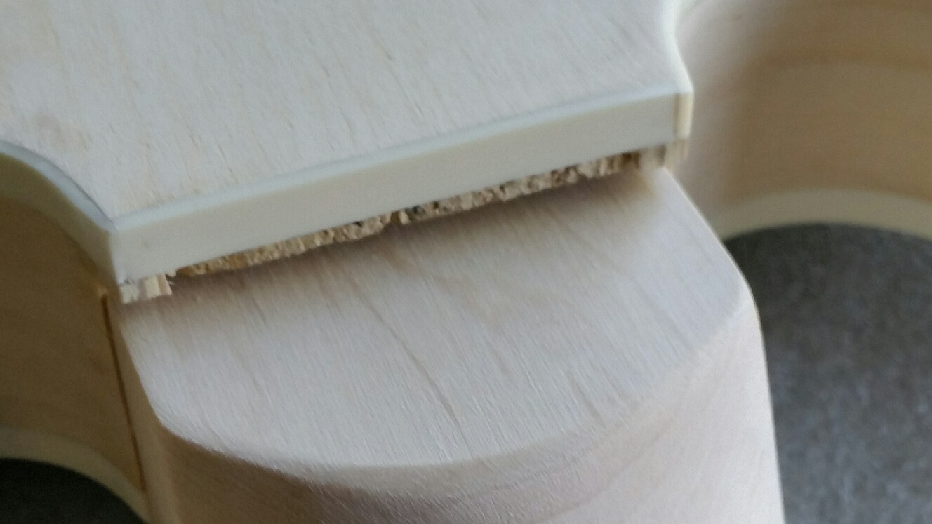

    I had a closer look at the neck and body and made a worrysome discovery. As can be seen in the photos there is a ugly gap between the binding and the neck that will need filling. It is only about 1.5mm wide and it needs to be there as the neck when fully home doesn't meet up with the binding. So I was wondering what others have done to make this look right. I don't want to fill it with glue so was thinking a thin smear of Selleys spak filler or maybe Timbermate before I stained and top coated.
