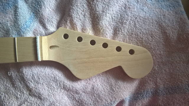

    Hi All

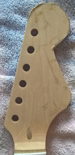

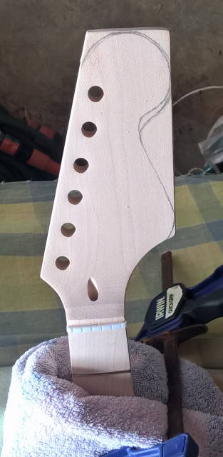

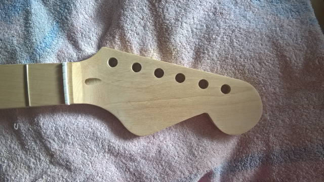

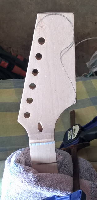

    Got my ST-1 from Pitbull yesterday and got stuck straight into sanding and shaping the head stock.
    I also sanded the body of guitar with 400 grit paper.
    I am planing on painting the guitar white. I have Primer/sealer then white water base paint then gloss lacquer.
    If there are any steps missing please let me know.

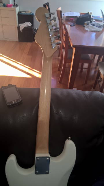

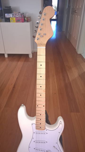

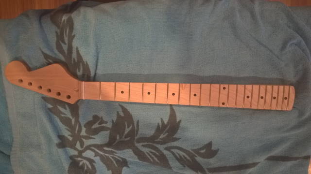

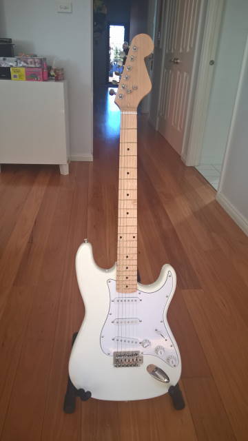

    Ok After a month of doing not much with my guitar I have made some progress
    I have done finished the neck using Tru-Oil and orange oil on the fretboard. I think it turned out ok

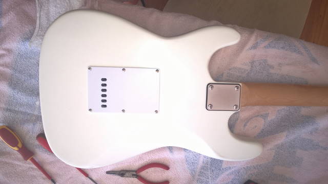

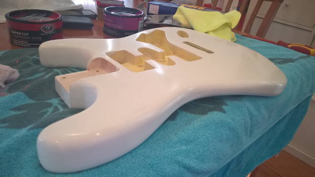

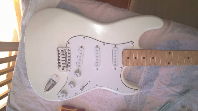

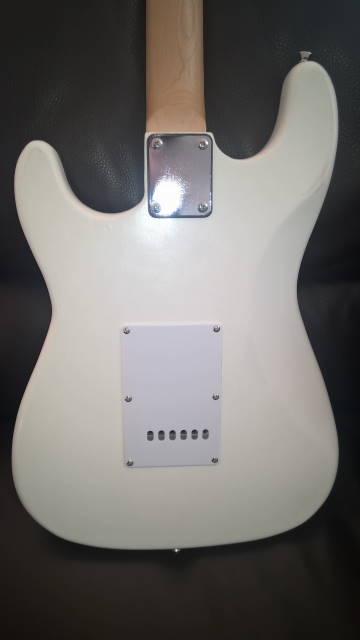

    Jun 2017
    Sydney, Australia
    20

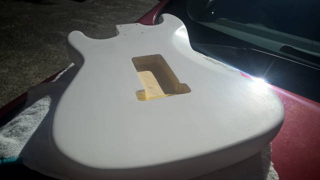

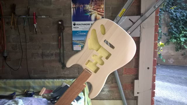

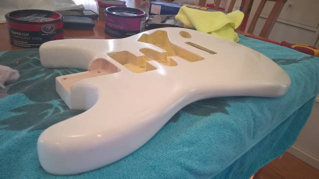

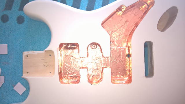

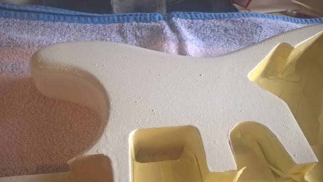

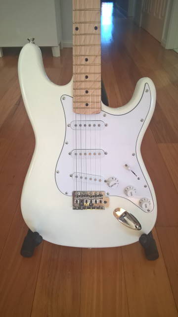

    I have done the body. It turned out ok. It was a lot harder then I thought. Everything looks ok until you paint it. I found it hard to get into the corners near where the neck attaches.
    I used 3 x coats of primer sealer
    9 x coats of paint. It was quite translucent.
    Primed again as I had some high spots
    Painted another 3 coats.
    Put 3 x coats of lacquer. Sanded to 2000 grit.
    Used compound to cut then polish
    Am I happy with it? Yes. Could I have done better? Yes. I made a few mistakes with the painting but I will know better for next time.
