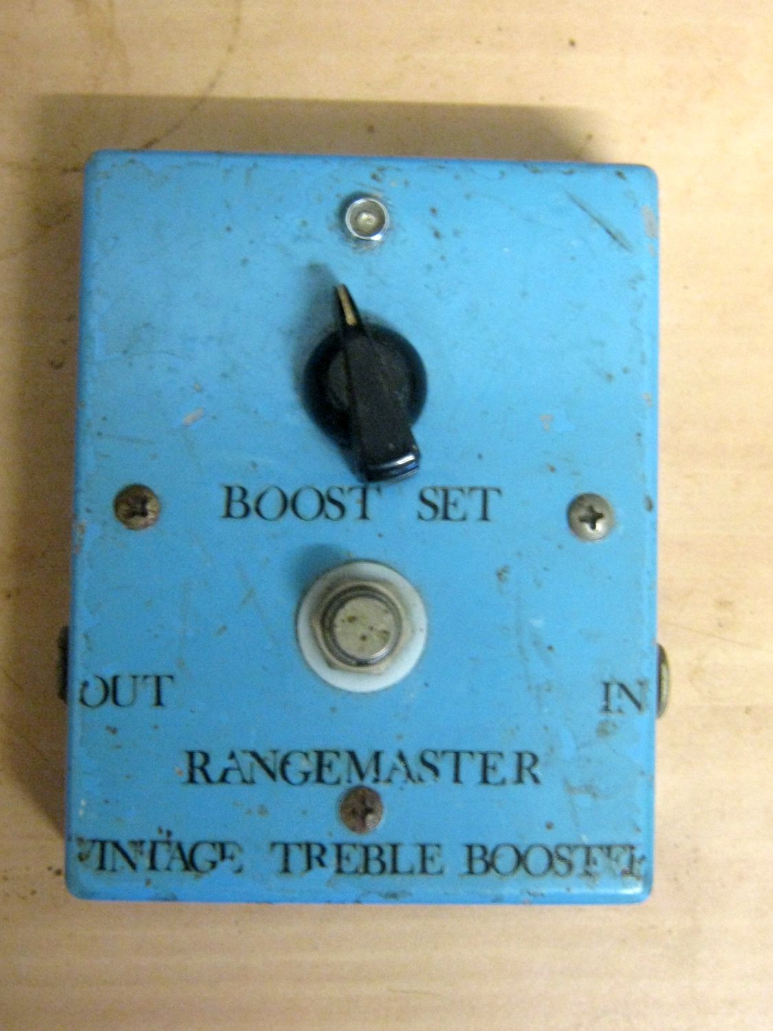

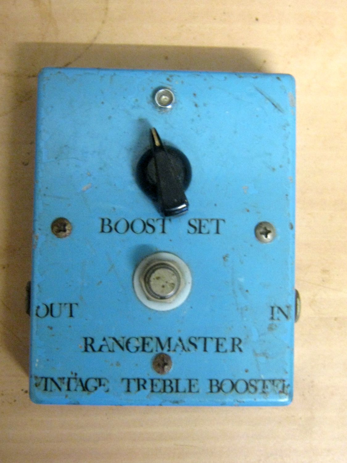

    Outside:
Name:	Rangemaster 1_resized.jpg

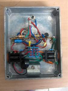

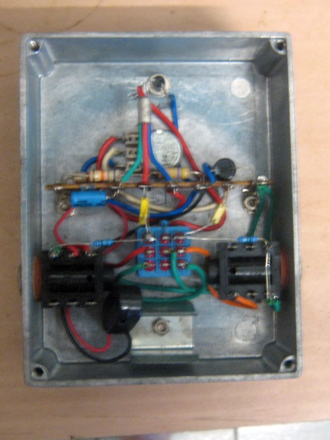

    And Inside:
Name:	Rangemaster 2_resized.jpg

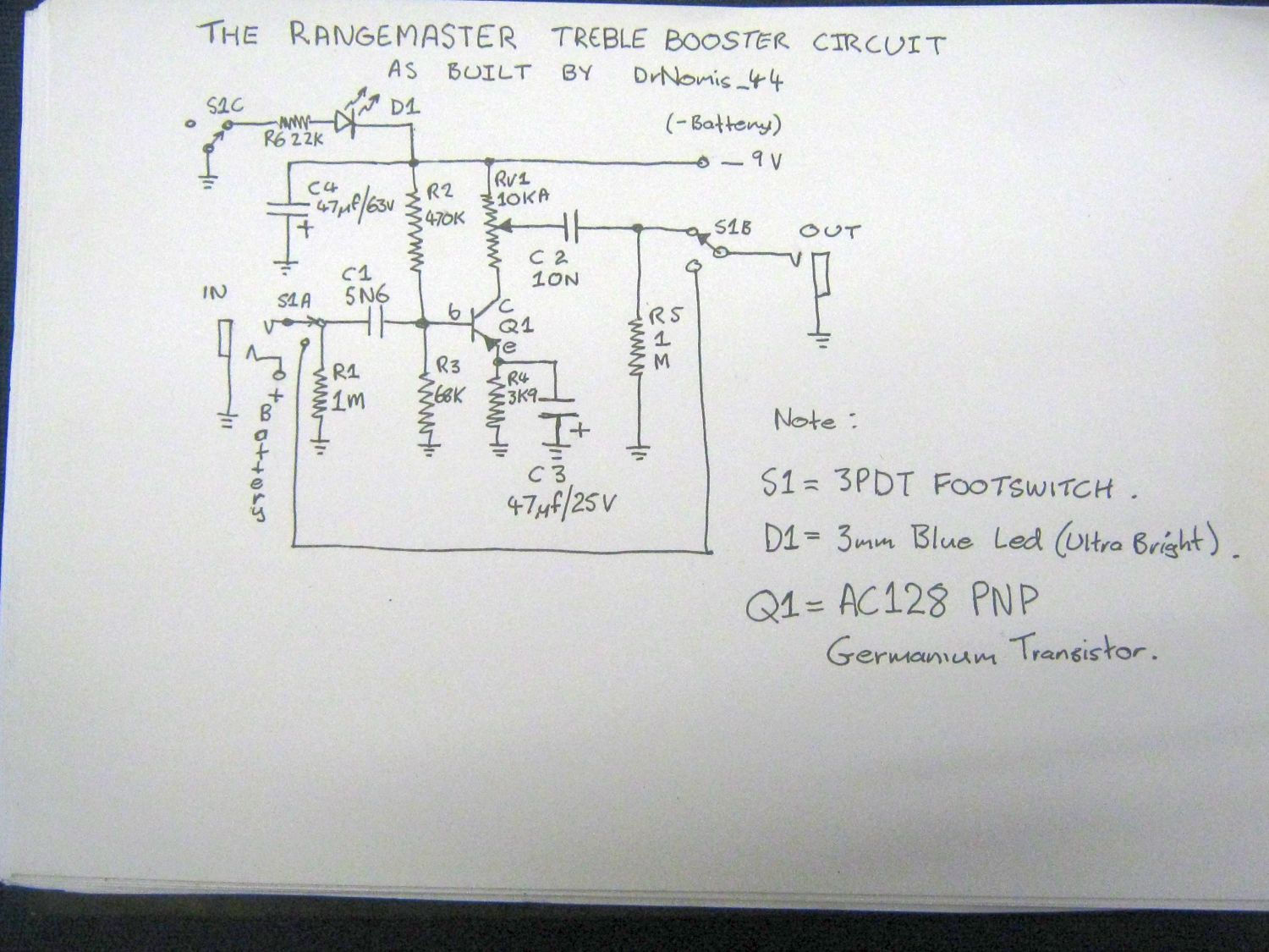

    And here's the actual circuit diagram for my Rangemaster pedal, as I built it:
Name:	Rangemaster Circuit_resized.jpg
    The circuit for my Rangemaster pedal is basically the same as for a vintage Rangemaster, except for a few minor differences, firstly, I've used an AC128 PNP Germanium Transistor because good vintage OC44's are getting a bit hard to find, and expensive when you can find them, secondly, I added a blue Led indicator and 3PDT Footswitch (the original used a slider-switch), and thirdly I added R1 and R5 (1M resistors) to eliminate popping-noises when you stomp on the Footswitch (they don't have any audible effect on the sound).
    While looking at the circuit diagram I posted, you might notice that it has been drawn so that the circuit ground is positive rather than negative, this is because the AC128 Transistor I'm using is a PNP type rather than an NPN, back in about the mid 40's when Transistors were first invented by scientists working at Bell Labs, the whole point was to come up with a more reliable, efficient, and compact replacement for the Valve Technology which was current at the time, it was specifically intended to replace Valve Technology used in Telephone applications, the only semiconductor material they had available at the time was the element called Germanium, Silicon Transistor Technology wouldn't arrive till later, a lot of those early Germanium Transistors actually weren't all that good even when brand new, some worked while others barely worked at all, but improvements were made in Germanium Transistor Technology during the 50's and 60's, at first only PNP Germanium Transistors were made because it was difficult to make reliable NPN types, as it just so happens the manufacturers of the original Dallas Rangemaster had to use whatever was cheaply available to them.
    The letters PNP and NPN indicate the polarity of the three semiconductor layers that form a Transistor, "P" indicates that the layer is Positive, while "N" indicates that the layer is Negative, so for a PNP Transistor the "E" (Emitter) layer is Positive, the "B" (Base) layer is Negative, and the "C" (Collector) layer is Positive, now in order for a PNP Transistor to work correctly in the Rangemaster circuit, the Emitter layer needs to be connected to a Positive ground.

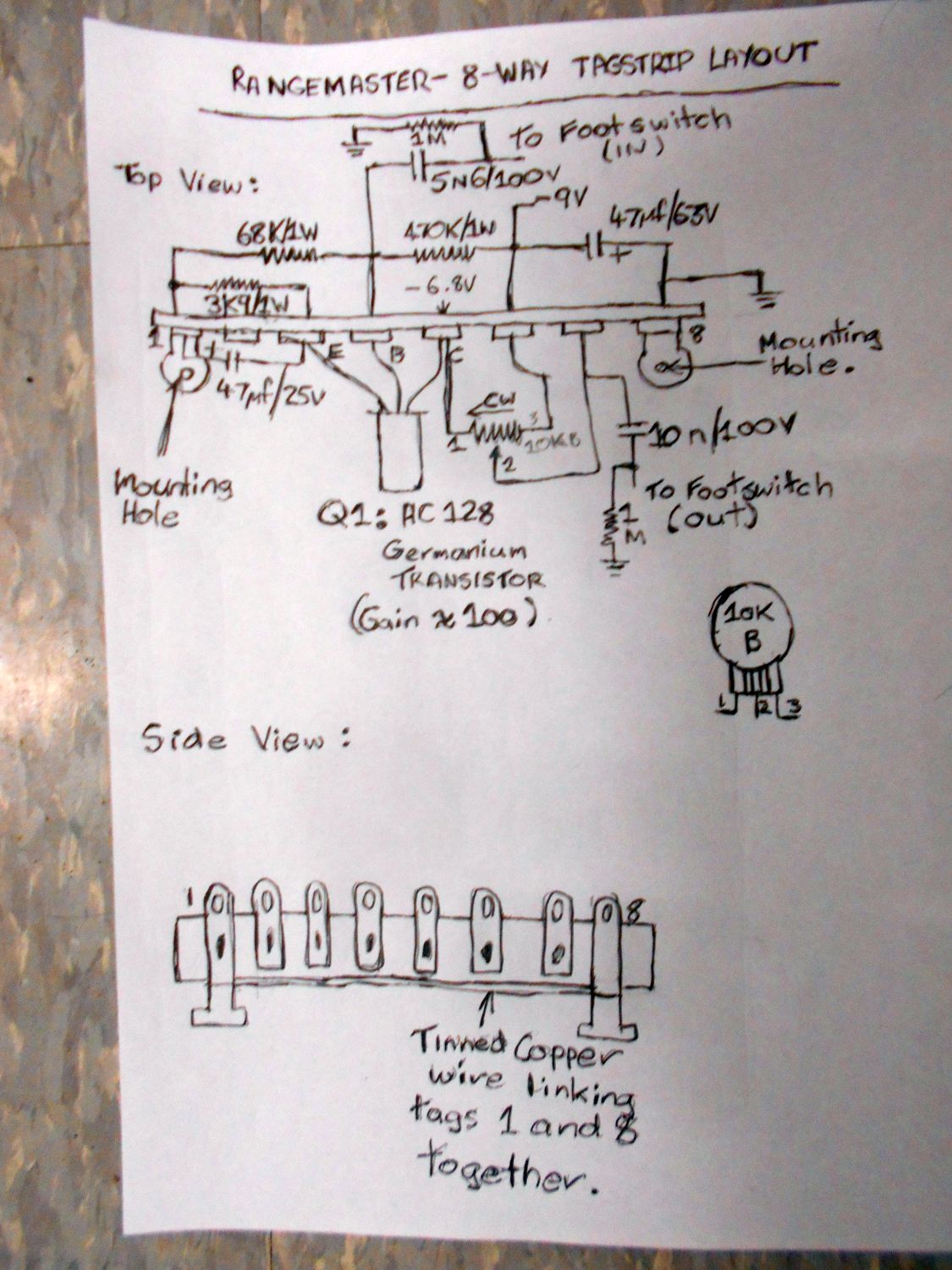

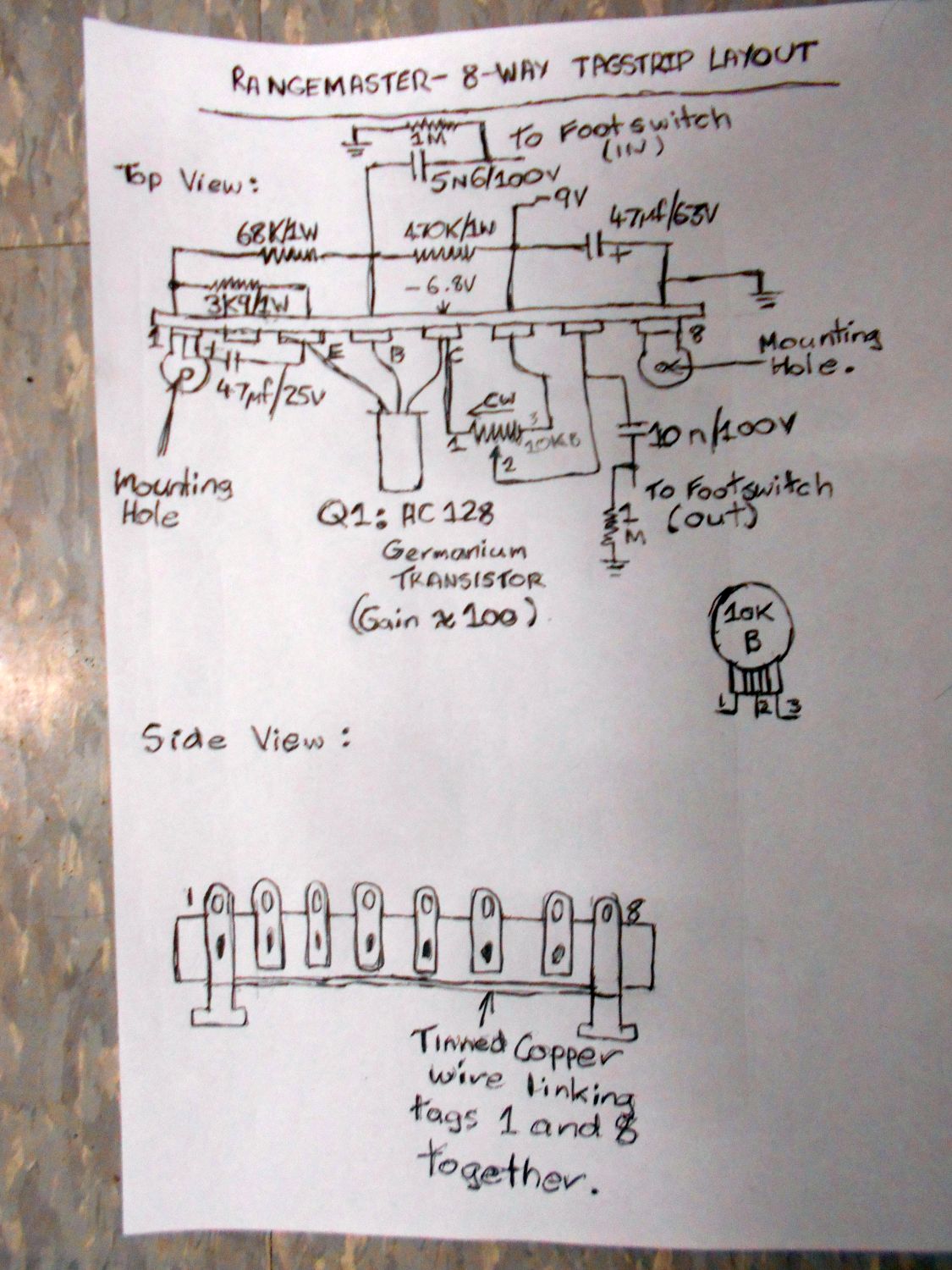

    The 8-Way Tagstrip is what you use to build the circuit on since it is a very simple one, although you could build the circuit point-to-point style if you want.
    I'll post a pic of a hand-drawn layout I used for the 8-Way Tagstrip soon....stay tuned.
    Update:
    Sorry it took so long, but, as promised, here's a hand-drawn layout diagram of the 8-way Tagstrip in my Rangemaster pedal, feel free to use it for your own Rangemaster pedal build:
Name:	Rangemaster Layout_resized.jpg
