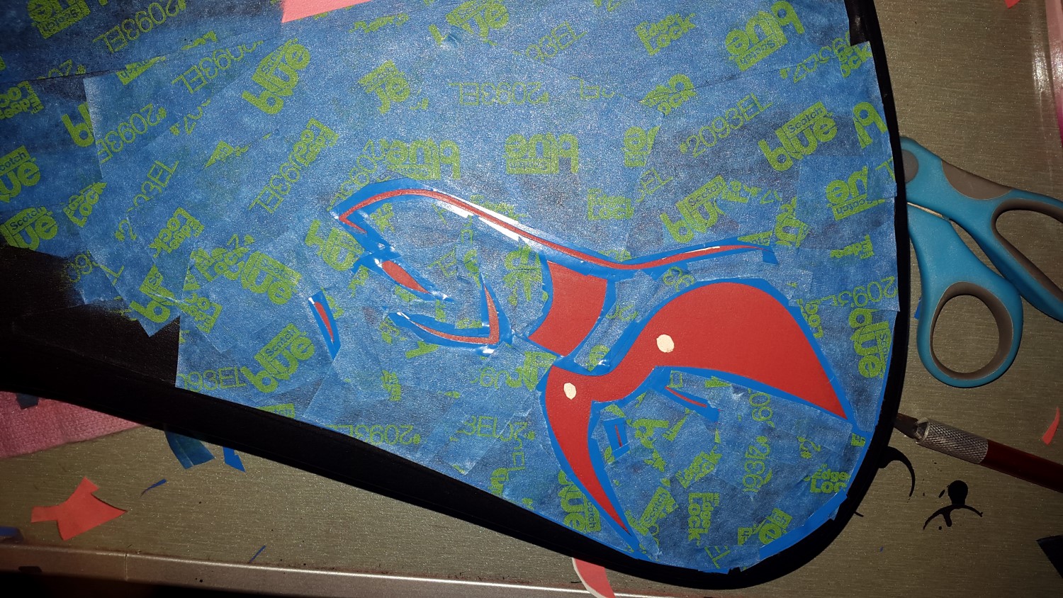

    When I did my MB-1 colours, I did my lightest colours as my base coats, and went darker as I got closer to the top (barring a couple of small spots that were for little details.
    In terms of how I masked, I used 3mm Vinyl tape (3M brand if that matters, idk how many brands make the stuff) to do the edges, then used some form of painters masking tape to cover the areas around it, and if I had a massive space to cover, used some masking paper over the big parts so that the whole thing wasn't covered in tape.
    There was a tiny bit of bleed on some of the tighter corners, but nothing that a bit of careful scraping couldn't deal with.
    Masking:
Name:	041 Closeup (Custom).jpg

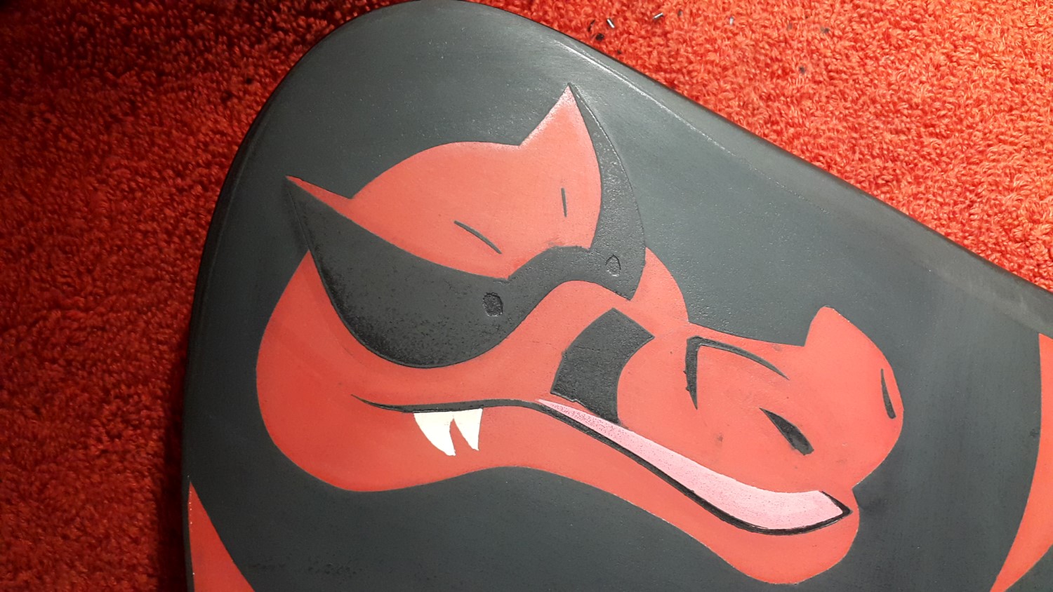

    Result:
Name:	044 Closer now (Custom).jpg
    Oh and with the edges: Yea also had a bit of an edge, but carefully sanded that down, not totally flush, but close enough that some clear coats would fill that out a bit
