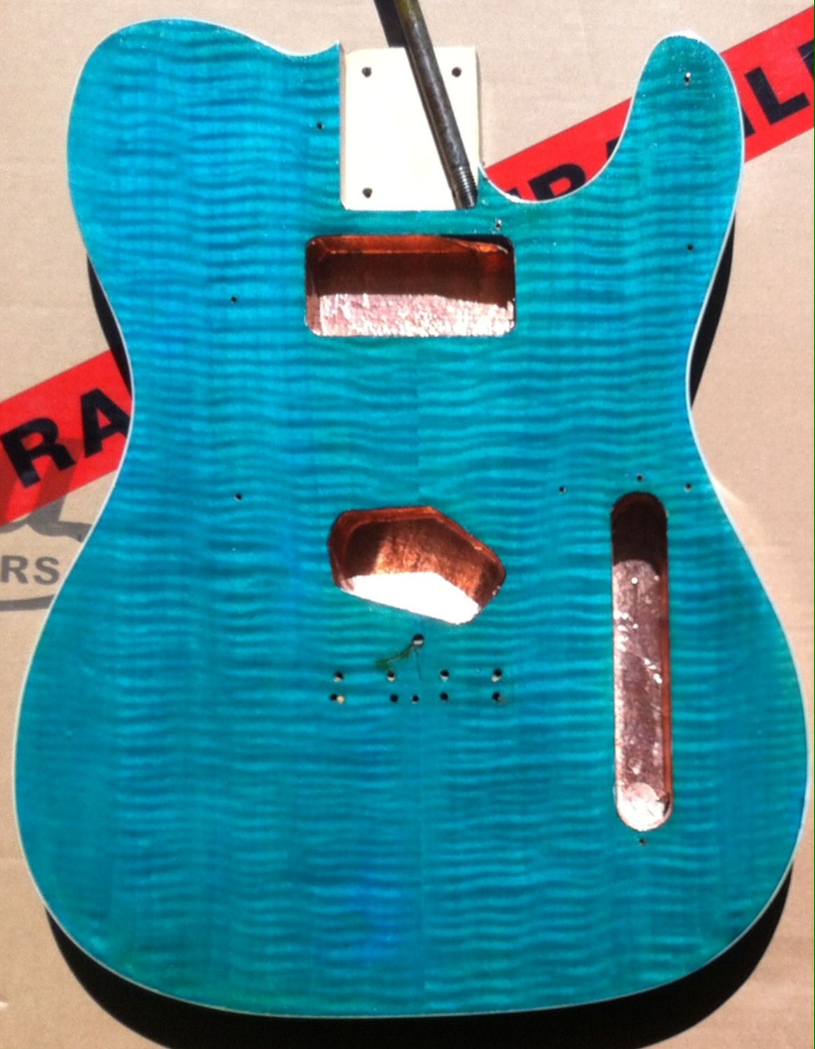

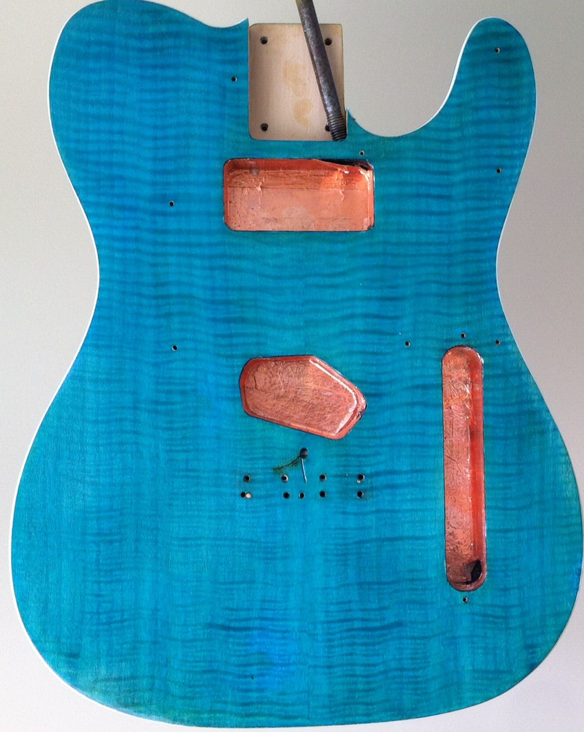

    Nope but I did this instead.....
    Attachment 18922
    Indoor shot
    Attachment 18923
    Outdoor shot
    Check the build thread in my signature if you want to know more.
    Cheers, Waz
    EDIT: uploaded wrong photos, should be good now

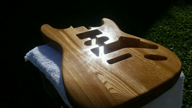

    Yeah I've seen plenty on youtube where they have used black dye or black ink or even ebony timbermate to fill and pop the grain first and then finish with a blue or red over the top, in one of my previous builds I used an oak timbermate on an ash body as grain fill which was just dark enough compared to the ash to highlight the grain once it was cleared. I was considering using a blue to highlight the grain before clear coating and was wondering if anybody had seen this done or whether you think it would be too far out there. here is a picture of the subtle fill on my sta-1m.Click image for larger version.

    Best idea might be to buy some white or neutral/natural timber mate and then add either fountain pen ink or ink jet ink and proceed to mix up a batch of the desired colour. On my Tele that was done with Cyan Blue inkjet ink diluted down a fair bit but full strength it has more depth. Fountain pen ink usually comes in 2 shades of blue where the darker one is blue/black and in my opinion quite dull and not as vibrant.
